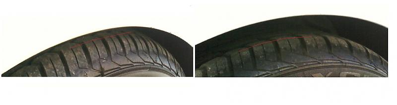

When I purchased the car several months ago the last owner lowered the car. He had the front lowered more than the back for whatever reason? The left picture is front and the right is rear.
I want to make the car even all around so I want to LOWER the back the same as the front. My question is which number pads do I use? I was told the pads go from 1-5 and the price is like $22.00 each.
I like the way the cars here in the forums look, they seem to be the same height all around. The fron of my car does not rub so I dont mind going that low in the rear.
Another question that just came to mind. Once I lower the rear will it give me a rougher ride?
Thanks for any help.

check what number bump pads you have on the back right now. each bump is ~5mm-8mm in height, so you can figure out what number you need depending on how much lower you need to go.
the bumps are on the edge of the pad, and you can usually see them sticking out if you look under the car. here's some pics of two-bump pads:
https://mbworld.org/forums/showpost....3&postcount=17

Chances are the car was lowered and the stock pads were used, or simply the same size pads were used on both F&R. Hopefully you aren't at #1's all around, because then you of course will have to go through the whole spring compressor hassle on the front if you diy
you shouldn't really notice a difference if/when you get the difference squared away.

Ok, Heres what I have (please also look at the pictures)
Front= #4 pads and 8 coils with a SILVER marking on one of the coils.
Back= #2 pads and 7 coils with a BLUE marking on one of the coils.
Now what should I do to get my car level?
Should I buy #1 pads for the rear to lower it?
Will that be enough to make things even?
I dont think there's much I can do with the front except go UP which I really dont want to IF I dont have too.
I hope you guys can suggest something asap because my BM dealer needs to order some of the pads as they are not all in stock. So if I can order what I need TODAY that would be great. BTW, Is the lower the pad # the thinner or what?
Thanks everyone.

The lower the #, the thinner the pad. Going from 2 to 1 will be around a 5-8mm difference. So you'd have to measure to see if that will make it level or close enough for you. Which will answer if you'll have to go up on the front end or not. You can order the pads yourself though, and perhaps cheaper than the dealer.
No spring pads is prob a bad idea and I imagine a rough ride. You don't say what you are running now, but I'd first go #1's, or whatever balances depending on your options and go from there, pads only cost like $25-30 for the set anyway. Worse comes to worse why not get lowering springs with more drop? or cut your existing lowering springs?
