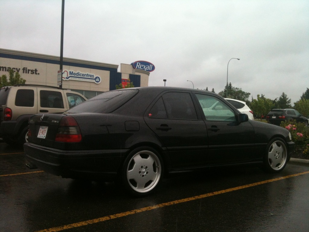

Miraculously, today whilst driving around at lunchtime for errands, the CEL disappeared. Parked and went into a shop; came out and started up and it was gone.
It was raining pretty heavily today though, I wonder if the moisture has 'assisted' with some electrical contacts underneath the car. Mechanic buddy's best price for the O2 sensors is $230 for both, so I'm wary of spending that right away.
Other than that...I'm still rather impressed with the power compared to the 43 motor. Lovely, lovely, lovely....highly recommend the swap for anyone in the market. They really should have just built the car with the 55 in the first place. Probably would have been easier than fabricating up the bespoke C43 cams and fitting those into just a select group of engines.

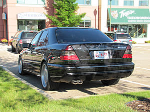

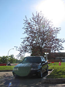

Here's a quick picture of the car in the rain today:
started tear down for paint-87cbdae8-eced-49e7-b616-3aa0ff304d55-6377-000009931df7e0ae_zps4d9c9d91.jpg

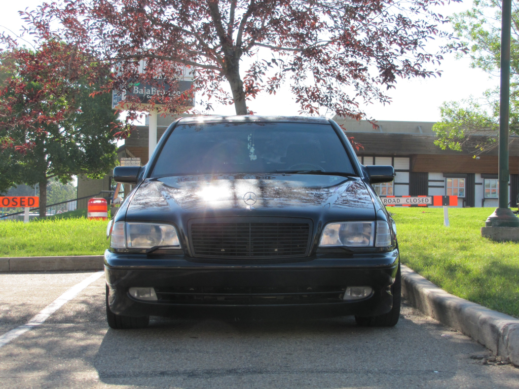

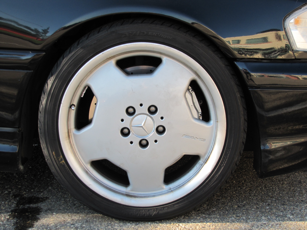

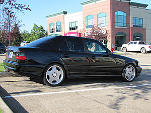

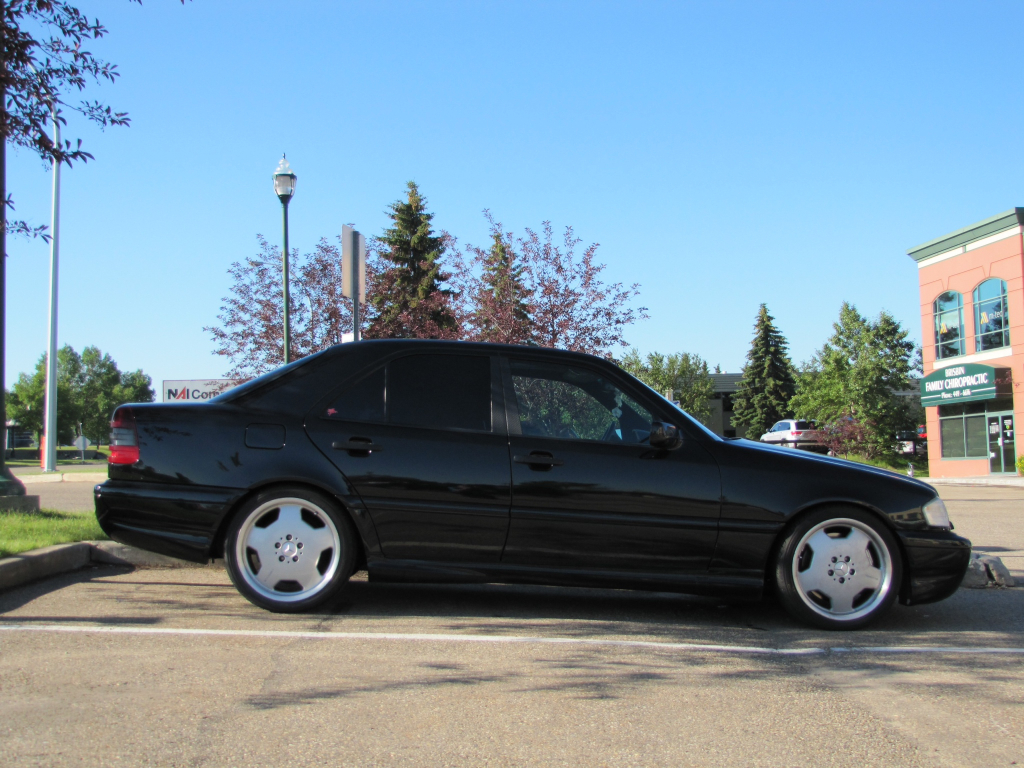

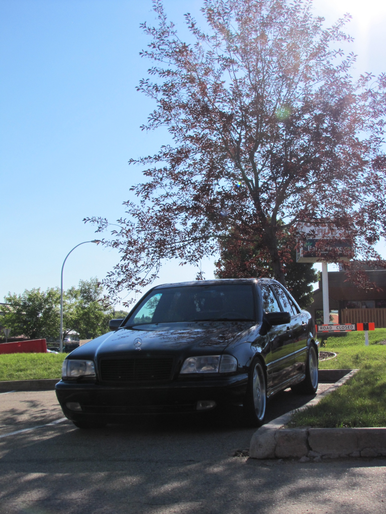

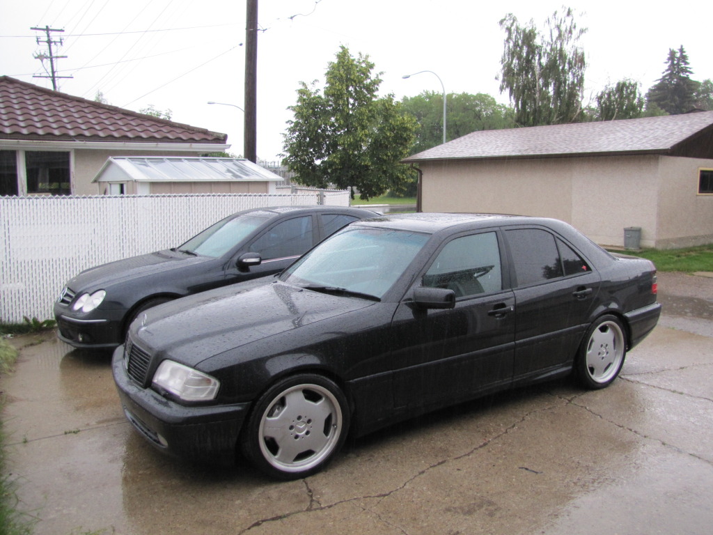

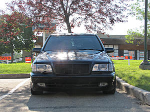

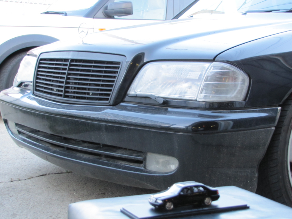

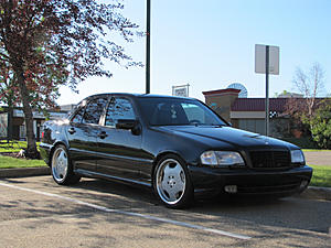

A few photos from the past few days, including some after a carwash earlier this morning.
started tear down for paint-20de181fe42619b0af1de8a455a8091c_zps75cb1f07.jpg
started tear down for paint-2fcc0874fe16b1115a529ee9c156d5fd_zpsdc49cecc.jpg
started tear down for paint-dc7b799ad6aad62a0a10830599f9401b_zpsb6493d25.jpg
started tear down for paint-c1cccecd9b53288cd6b3b9d5f4514ad9_zps6e9bd2c3.jpg
started tear down for paint-277375121a2e6e5e4f9ae84417a5f804_zpsaca53140.jpg
started tear down for paint-2d7df94331b7e03c6d4b097a1fd34853_zpsa33da4e9.jpg
started tear down for paint-766dbc22f2211db235b311b69a392e32_zps4f9f7767.jpg
started tear down for paint-3f2009fca2255f0368fb81067cc8f37d_zpsfcbbc782.jpg
started tear down for paint-c77fce38e44332a15ca6de6317347b01_zps68956915.jpg
Subtle aggression:

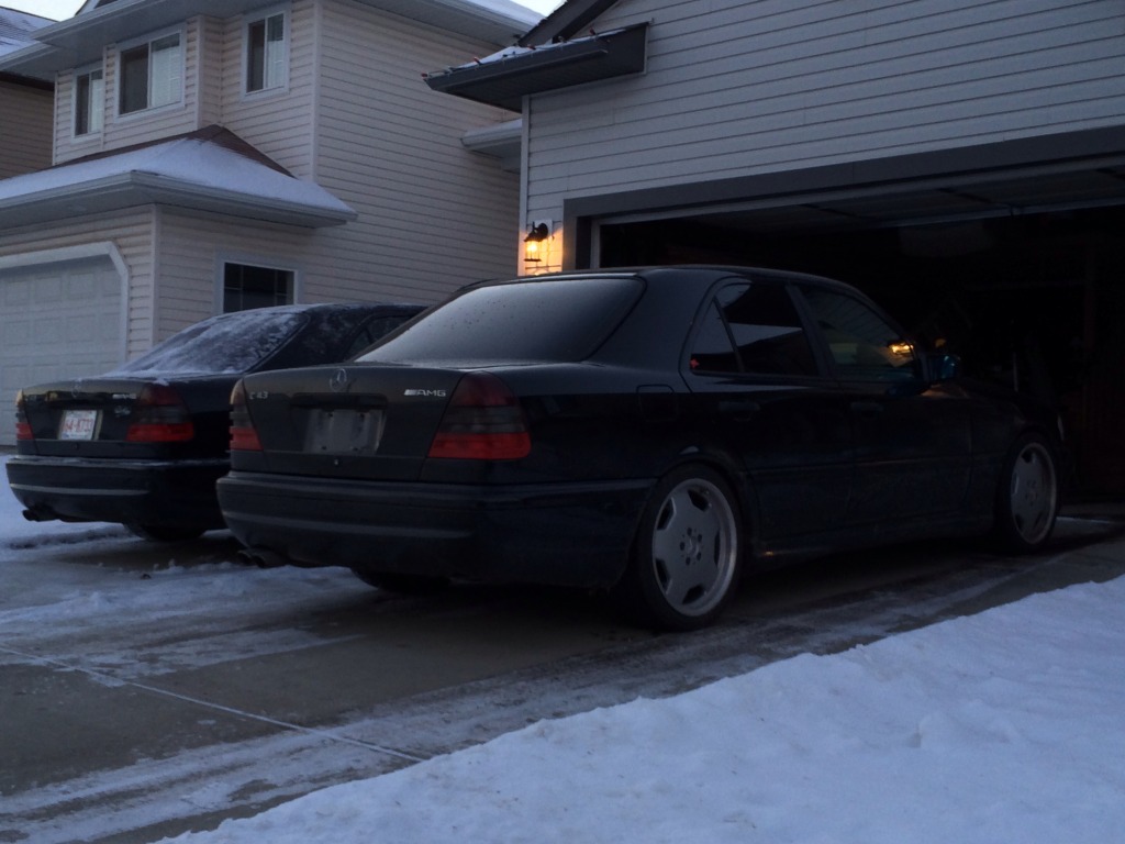

The car has now been sold! The new owner actually already owns a C43, and is an enthusiast. Keeping it in the family, as it were, means I will probably still see the car once in a while!
So I guess I was just the car's custodian for a little while. I'm sure the new owner will have a lot of fun with the car, especially if he lines up at the lights with some unsuspecting driver thinking of taking on an old Mercedes....
Old Nov 11, 2013 | 03:07 PM
