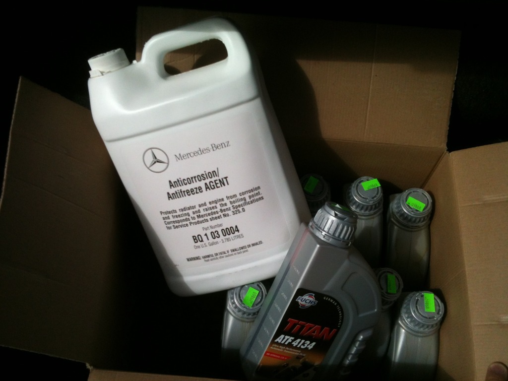

Okay, with any luck, within a week or so the 55 swap will finally be done on the car!!
Started today with the acquisition of some genuine Mercedes coolant and a lot of Fuchs ATF (some of this will be used in my C55 too). The shop I deal with can't get the Shell ATF anymore, so they've been using this stuff for a while now.
Tomorrow - I'll pick up the car from my parents' place and get it back to my garage. Hopefully will have the engine out Sunday, parts transferred over to the 55 motor Monday, then back into the car later in the week. We are taking some time off in between to head to Canmore in the mountains to chill out.

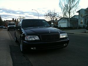

Got the car back to the house last night, but on the way shot a few iPhone pictures:

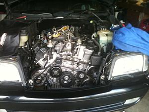

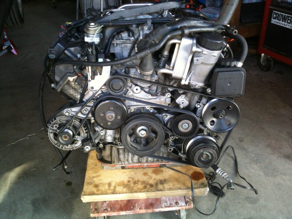

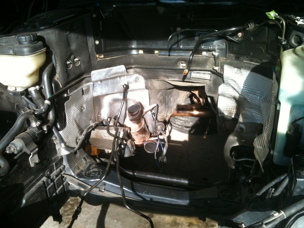

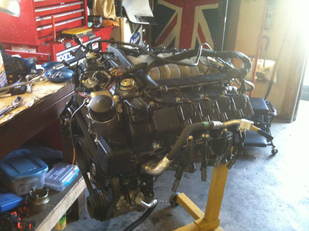

Got the car home Friday night, butdidn't get started working on it until Saturday. Saturday jacked it up, drained fluids, disconnected wire harness, removed front grille and rad support.
My buddy came over Sunday and we got the motor out then, and removed all accessories and other bits that need to be transferred over. By Sunday evening I had swapped everything over to the 55 motor except for plugs, exhaust manifolds and hoses. We had planned to get the motor mated up to the trans, but on removing the torque converter to R&R the seal there, found some irregular wear on the torque converter's shaft. Consequently, my buddy is going to sort out a Speedi-Sleeve for it before we can get it back into the car. Also waiting on a new upper rad hose.
Going away for a few days to the mountains to chill out with the family and just to get out of town. With any luck, will have the 55 back into the car and running Saturday.
Some pix:
43 motor
started tear down for paint-78dfcbda-48d5-41dc-9f23-da7ad89dd7d8-4187-0000059d815c3c5e_zpsd1db9cb9.jpg
55 motor nearly all dressed:
started tear down for paint-89dc736c-e5c5-40c5-85dd-6eaf55cd7089-4187-0000059d92e33f57_zpsf1e4dae9.jpg

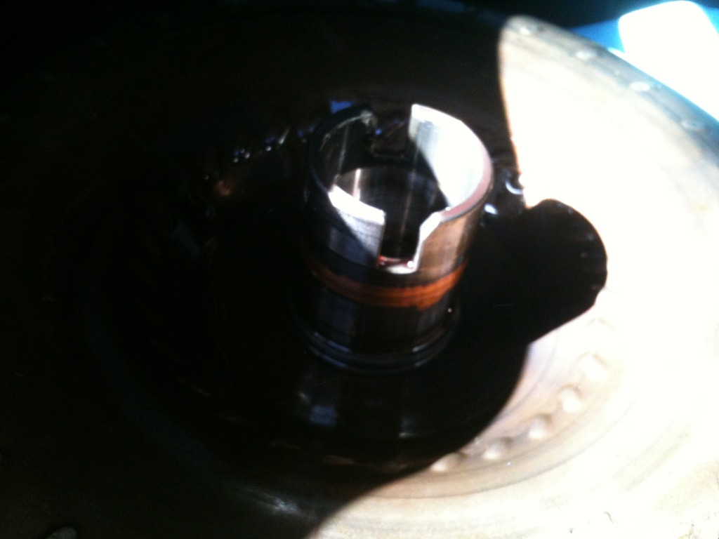

poor photo of the wear on the torque converter:
started tear down for paint-c5636005-414f-4607-8a46-e575046f3b2f-4187-0000059d8c035447_zpsaf9135b6.jpg
The Speedi-Sleeve solution:
http://www.skf.com/group/products/se...eve/index.html
Wondering what caused the wear on the torque converter. Ideas?

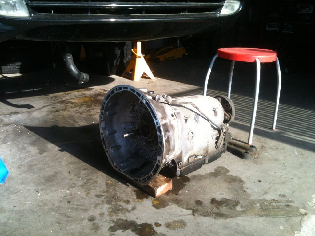

Got the trans out yesterday. Stupid - forgot to drain it before I took it out though. Pricing the trans pump now, hopefully will have it sorted out soon.
Tires are just Yokohama Envigor all seasons. My parents will just drive the car summers, so no biggie. I wanted something pretty durable and comfortable.

Pix, to show it happened!!

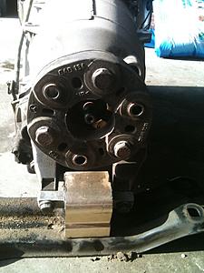

The trans mount was previously replaced, but the flex discs haven't been. The one on the trans is just started to show wear, so I'll go ahead and do it up.

That must be a big b*gger to get out. Did you do it from under or out the front?

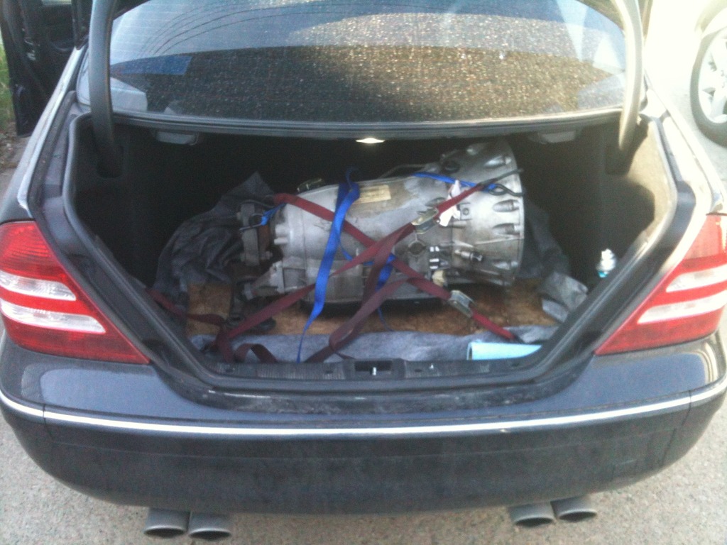

The trans actually didn't weigh as much as I thought it would. That said, still too heavy to bench press. Whilst I can move it around on my own, I needed my neighbour's help to move it into the car.
I just jacked up the car as high as possible (probably a good 20"-22") and then lowered it down on two jacks.
Here's a pic of my 'MCT' C55, LOL.
started tear down for paint-ca08a915-90ab-4cfc-8550-d6896868cc42-1237-00000237b5010dde_zps24676c42.jpg

Ha pretty sweet.. Something you wouldn't expect to see in the trunk of a killer AMG.

Carrying a spare transmission just in case.....

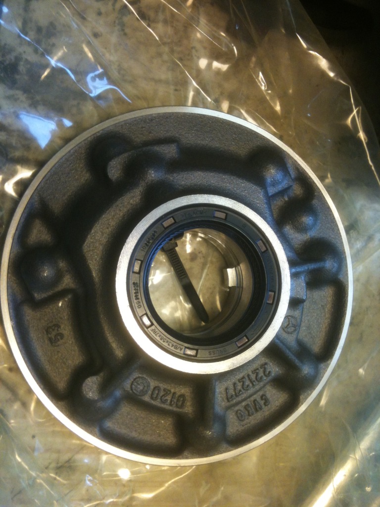

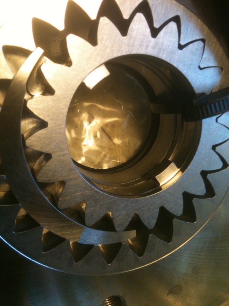

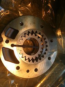

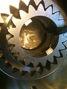

Got the new trans front pump. Lots of money for such a small-ish part!
Took some comparison photos for when the old one comes out, see what's what with the damage.

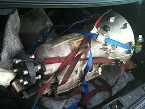

The trans is ready to go again! Here it is in the back of my C55, with brand new flex disc too.
