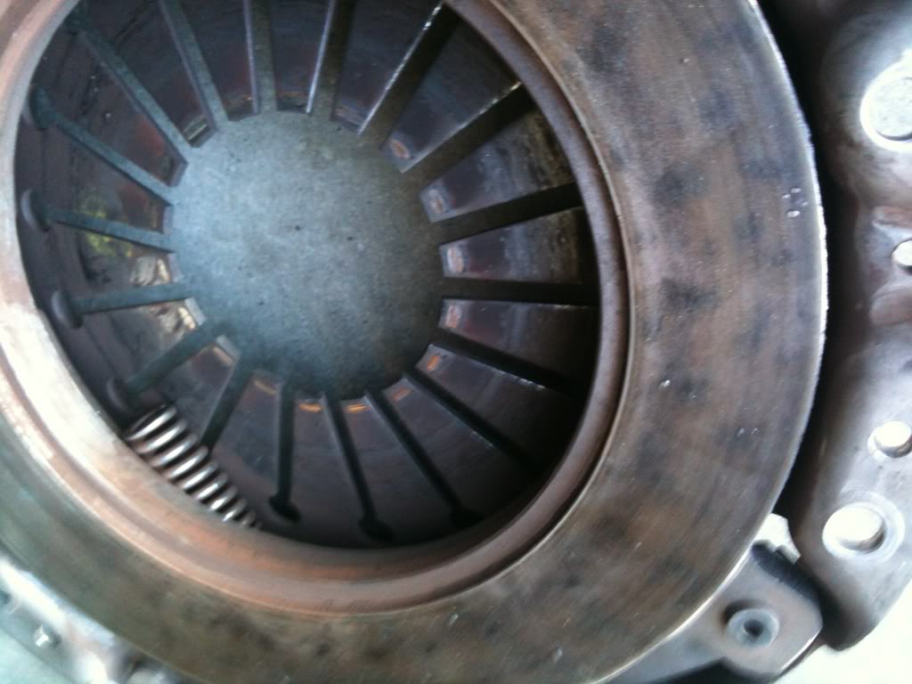

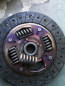

Just coz we were discussing it, and coz the 202 AMG forum is like the OG for me, here are pix of my dead clutch which I pulled out of the S2000 this past long weekend:

Oh dear...

I was about to throw the disc out, but now I think I'll keep it and make a garage clock out of it...you know, people pay lots of money to get that type of 'burnt metal' look on their exhausts or whatever!
