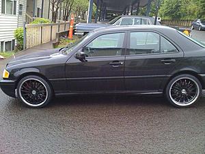

So turns out you can fit them BARELY.... I got 235/35/19 on the front and 265/30/19 on the rear with the mandrus milleniums
here are the wheels on my car

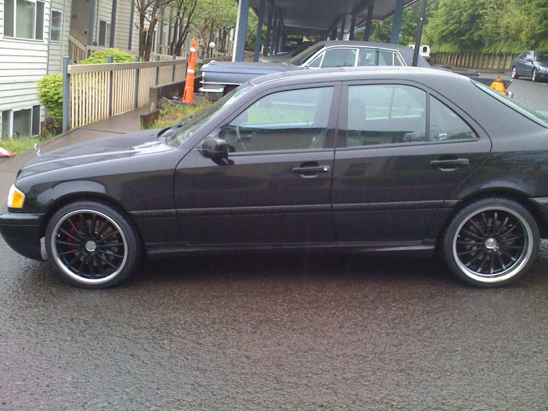

another shot of the wheels

Very nice looking wheels. Don't know if 19' is not too extreme... Ride hight needs lowering. Gives the impression that the car is ready for a drive in the fields
