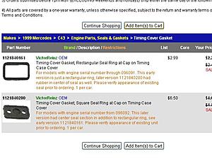

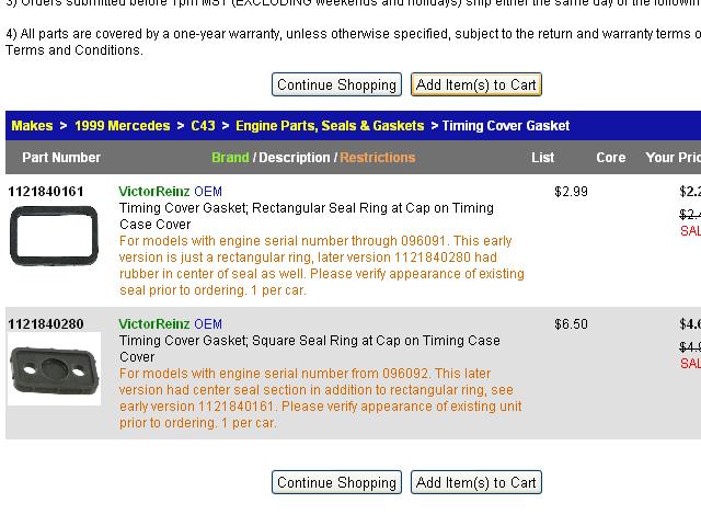

These are the gaskets I mean. There is only one per car, but it is one of two types.
I actually went ahead and purchased both, as I wasn't sure which one I had. Thus I have an extra, for anyone who is interested. I believe I have an extra one of the later style gaskets, but I'd have to double check.
the later style gasket doesn't fit on first old style cover?
Yeah, that's correct - if I remember right!
If I remember right, the casting is slightly different. While you might be able to physically jam the later style gasket into the older style casting, it won't fit properly.
what kind of seal protection does a rectangular shaped gasket provide without any centre rubber?
early c43 engines had this poor gasket and later cars had the revised gasket.
åttohausaz provides engine parts numbers for early and later edition engines, this is difficult to see which ones we have.
my car is manufactured late 98 as 99 car, do i have the crap gasket or the revised version?

I think you need to check your VIN or engine serial number to confirm. If you punch in your VIN to that Russian site that decodes the VIN, then it also spits out your engine serial number. Then you can cross reference which seal to get (or crank position sensor - as those are engine serial number dependent too).
my crank position sensor is # 026 1210 170

Be careful on just labeling your engine early or late. The CPS variation runs to a certain engine serial number, but I believe there is some overlap with the engine numbers for the test port gasket, ie. there is probably a range of engines which use the early CPS and late test port gasket. You have to check your engine serial number range independently for the correct CPS and test port gasket.
