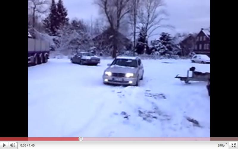

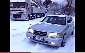

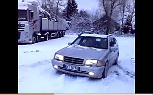

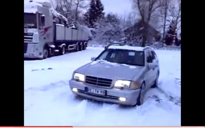

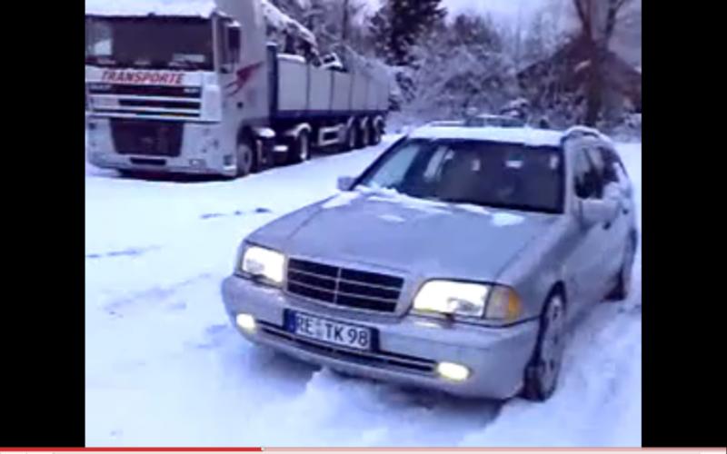

So, it's been long talked about on this forumn: foglights. Differences between the switches on 36's and 43's, ways to turn certain bulbs on on the 36's quad foglight set up, and how NOT to turn on the rear fog when turning on the apron fogs. Thru all the arguments that have arisen out of these discussions, one thing has always been clear for C36 owners: You can't have the headlight fogs AND the apron (bumper) fogs on at the same time, that is the whole point of those $50 relay boxes attached to the headlight harnesses. But I was checking out a YouTube vid of a euro C43 and look what I saw...
My mind has been blown
Anyone have any insight? Is this a Euro thing? Or am I just freaking out over 20 mins of electrical DIY?

No it's not the highbeam. If you look closely, his low beams are on, his headlight foglights, and his apron fogs. I'm aware the fogs work with the highbeams.
