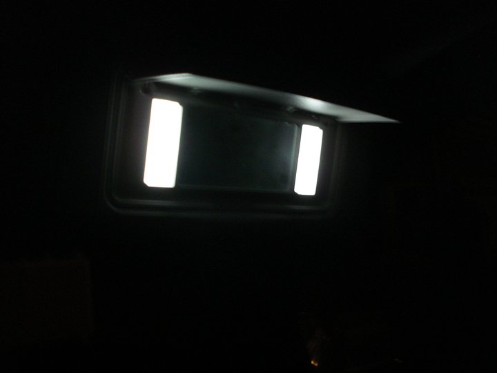

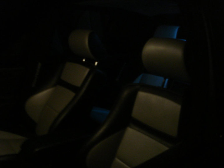

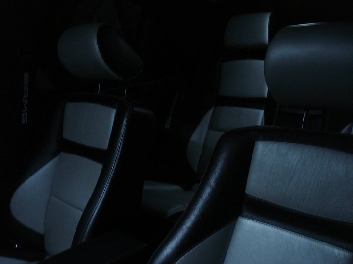

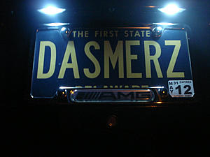

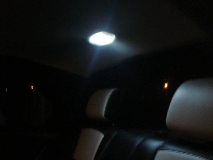

Got my LED conversion done, minus the turn signal bulbs and dash/instrument cluster (don't plan on doing those).
I ordered all my LEDs from http://www.superbrightleds.com. They have conversion charts from incandescent to LED.
Here are a handful of pics. I went with "cool white" color.
Hardest bulbs to do in my opinion are the vanity mirrors. What a PITA.
Attached Thumbnails LED Conversion Interior/Exterior (Done; Guide)-1.jpg   LED Conversion Interior/Exterior (Done; Guide)-2.jpg   LED Conversion Interior/Exterior (Done; Guide)-3.jpg   LED Conversion Interior/Exterior (Done; Guide)-4.jpg   LED Conversion Interior/Exterior (Done; Guide)-5.jpg

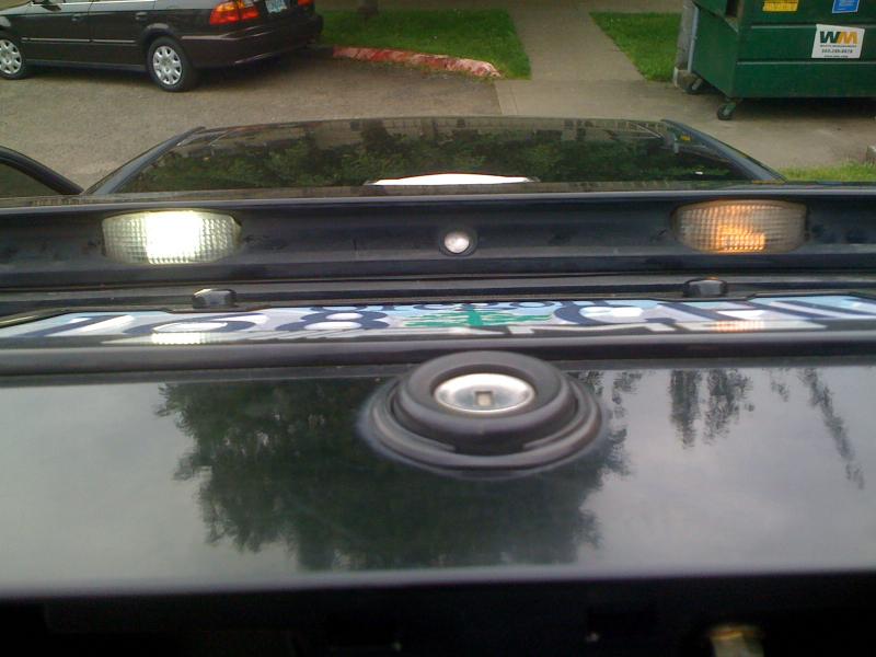

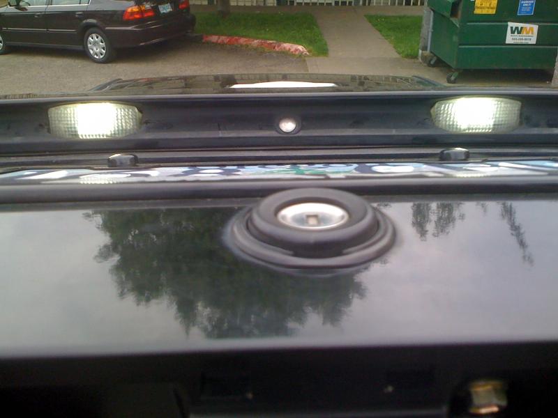

Just changed out my license plate lights with LED's, BIG difference...
LED Conversion Interior/Exterior (Done; Guide)-license-plate-lights-001.jpg
Here is a pic of the LED (left) and stock bulb (right)
LED Conversion Interior/Exterior (Done; Guide)-license-plate-lights-002.jpg
Here is a pic of both LED's installed
Changing them out was SIMPLE, remove 4 fasteners on the trunk carpeting and you can see the bulbs, pull the old bulbs and replace with LED's (takes less than 10 minutes)
If you haven't replaced your bulbs you need to, not only do they draw less power but they are WAY brighter.

There is a conversion chart on the site, which will tell you exactly what bulb to get, but I'll post most of the LED bulb numbers here.
  • Map light: 194 wedge (5-LED variant is what I went with)
  • Tail light (running light): 67 (can go with 9 or 15 LED variant--I like 15)
  • Stop light/Back up light: 1156 (several different versions with different # of leds. I like the 24-led version)
  • License plate/Glove box: 3610
  • Dome light/Trunk: 4410
  • Vanity mirrors: F30-WHP (12V version). The actual replacement bulb is supposedly the 3610, but it needs to be a 6mm wide version (skinnier), which does not exist.
NOTE: Any of these LED tail or brake light bulbs WILL throw the "bulb-out" light. Get a load resistor if you don't like that (or just don't convert to LED for those bulbs).
