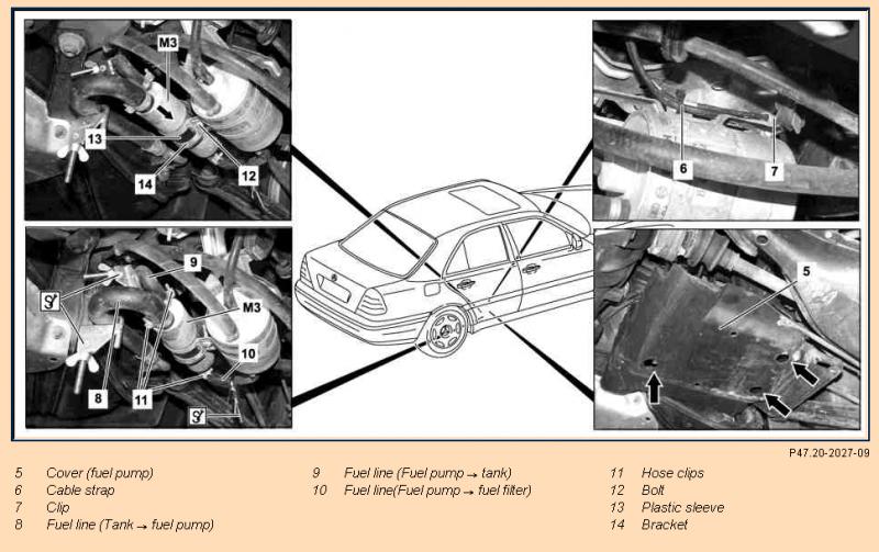

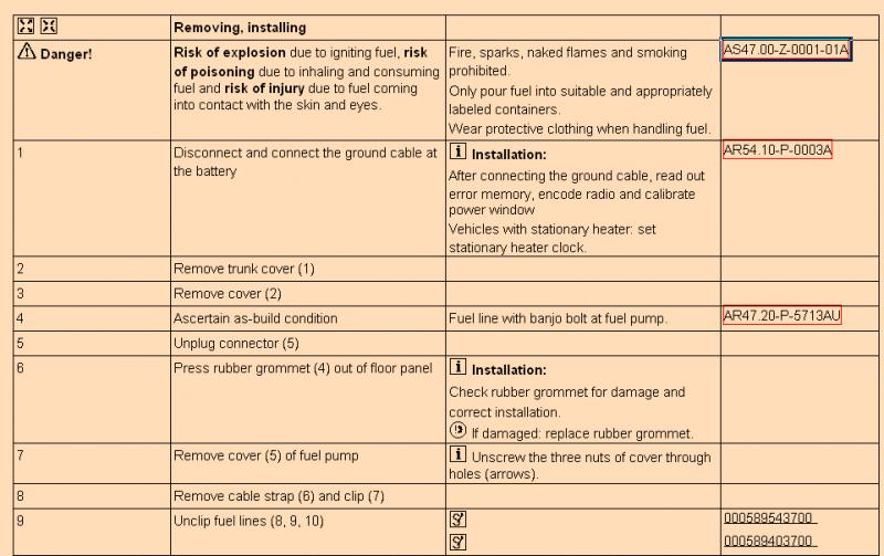

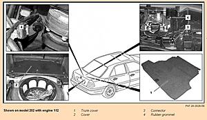

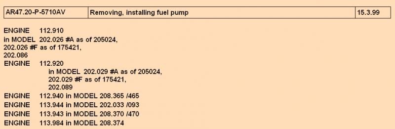

Here are some screen shots from the WIS on how to replace the fuel pump:

Did you hook up a fuel pressure gauge to check what kind of fuel pressure you've got? 202 fuel level sensors go bad all the time. You could be out of gas an not know it.

nope not the fuel pump hooked up a fuel gauge and had no fuel pressure to it when trying to crank it so switched the fuel pump but still no start ....took it to the stealership we'll see hopefully tom.
