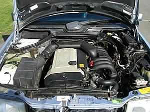

Was not designed for 0W-40 mobil1 synthetic.
10w40 Conventional oil in your 3.6 liter M104 engine.
Synthetic is for FSS designed engines that have longer change intervals and fleece filters.
No need to be dumping synthetic oil at the shorter change intervals your 1995 engine requires. And no need creating the common leaks that running synthetic oils create in an M104 with 140K miles on it.
