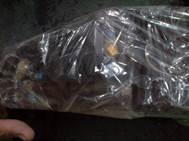

Pics of the brabus dash

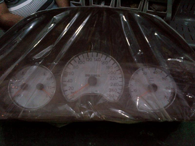

Old Jan 20, 2013 | 01:05 PM
sultan hamdi's Avatar
Joined: Dec 2010
Posts: 30
More pics

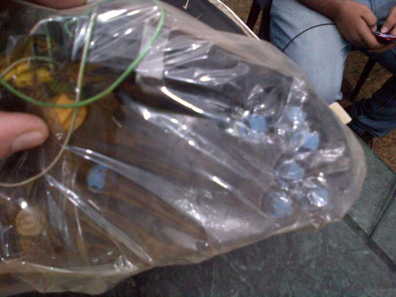

Old Jan 20, 2013 | 01:11 PM
Joined: Dec 2010
Posts: 30
Some more

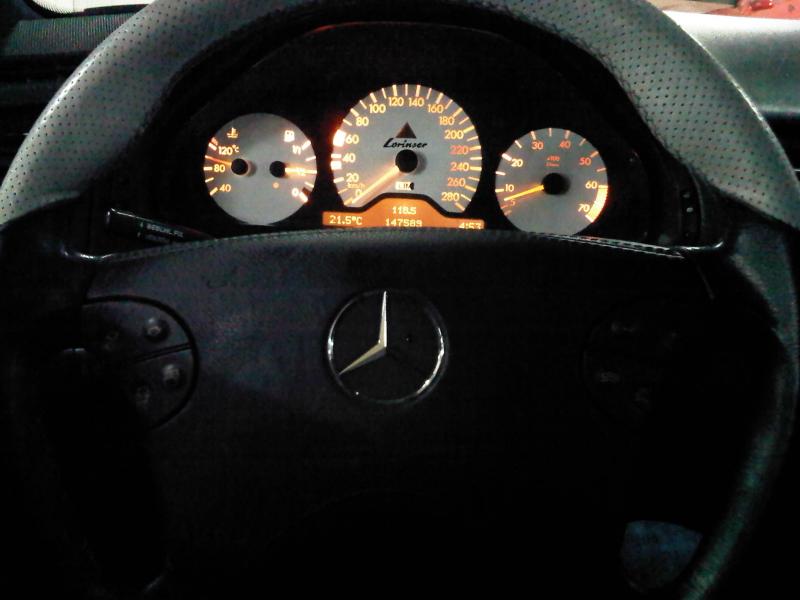

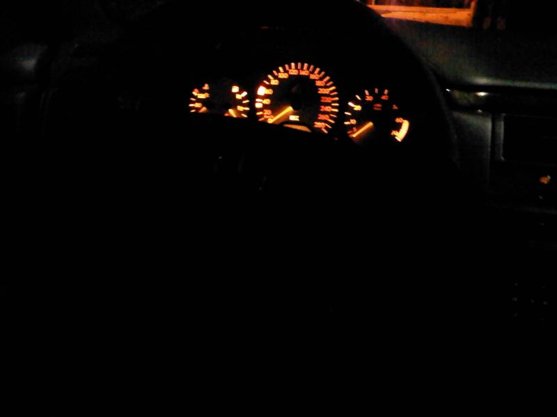

I Dont think u can put the w210 speedo on w202,but would like to share this,its on my brother W210 E320
Attached Thumbnails w210 gauges w202-img-20110329-00342.jpg   w210 gauges w202-img-20110329-00348.jpg   w210 gauges w202-img-20110404-00443.jpg
Old Jan 20, 2013 | 10:44 PM
nd4spd13's Avatar
Joined: Dec 2009
Posts: 940
From: Chapel Hill, NC/Montreal, QC
1995 C36 AMG, 1998 C43 AMG
Thanks for the pics. From what I can tell, that cluster will match the connector style on your car. It looks like, from what I can see (it's hard to tell) that the connectors are already in their place on the cluster. As in, they are already "plugged in." If this is the case, and I'm wrong about the connectors and they are a different style from the ones already in your car, you could do the work, and probably wire the connector using your current connectors (assuming they are different, but I think the connectors are the same.) So it will fit, it will plug in, but as I mentioned, the fuel gauge won't work properly and you will lose your gear display. Also you have to get it matched to your car using STAR within like, 50km of plugging it in or something to set the mileage and stuff.
Good luck!
EDIT: Saw you don't have tip, so you won't have to worry about losing the gear display

I could buy for his old E320 a black AMG speedo,but since the car had interior black and white,and the steering wheel had white also,so i found the speedo with white will look nicer and as well at night,even it wasnt AMG,but i liked it so i install it....Thanks
