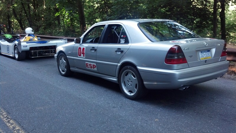

and here is a pic of the stock hill climb car. New suspension will be on before the next event....hopefully.
