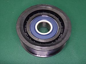

Do you have a part number for that pulley? Is it the belt tensioner pulley?

Idler pulley #: "000 202 09 19"

Perfect, thanks. Pelican has a kit with that pulley, the belt tensioner and the belt itself, I'm about to 100K so I might just do the whole kit, water pump and fan clutch at the same time.
