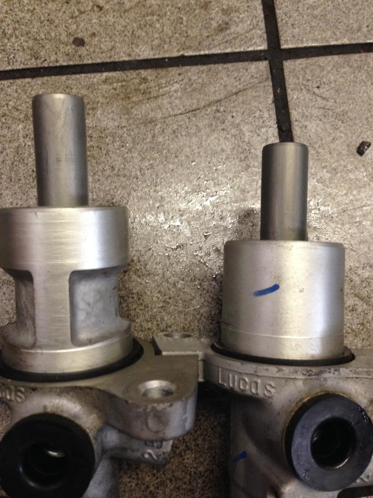

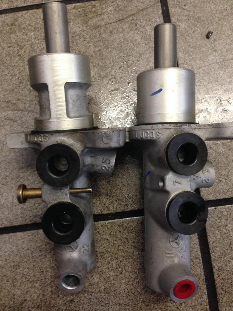

the master cylinder on the left of picture is my original one the one on the right of picture is from a sl600. the sl600 cylinder is too sort and will not fit my car so ill keep the one I changed from a clk 430

is there an improved difference between clk430 master brake cylinder vs C43 bmc?
for my c32/c55 brakes maybe i should get the mbc from c55amg?
Reply 0
Jul 10, 2014 | 02:42 PM
  #56
What's the problem with short or long..?!?, i put that in my "3" previous C43's without any issue...!!
ZAYED,,
Reply 0
Jul 10, 2014 | 03:35 PM
  #57
Quote: What's the problem with short or long..?!?, i put that in my "3" previous C43's without any issue...!!
ZAYED,,
ok then ill try it thank you
Reply 0

Very early E55/C43 (C43 upto ident F737081) had A005 430 83 01(I think this is 23/19 combo)
later E55/430,CLK55/430,C43 (C43 after Ident F737082) had A005 430 88 01(25/22 combo)
All 98 C43 we have here are ~F75**** so must have been VERY early C43 only with 23/19?.
Mine is 99 F780045 so already has 25/22 combo.
Cheers..
I would wager the M/C on the left is used with the dual diaphragm brake booster.
