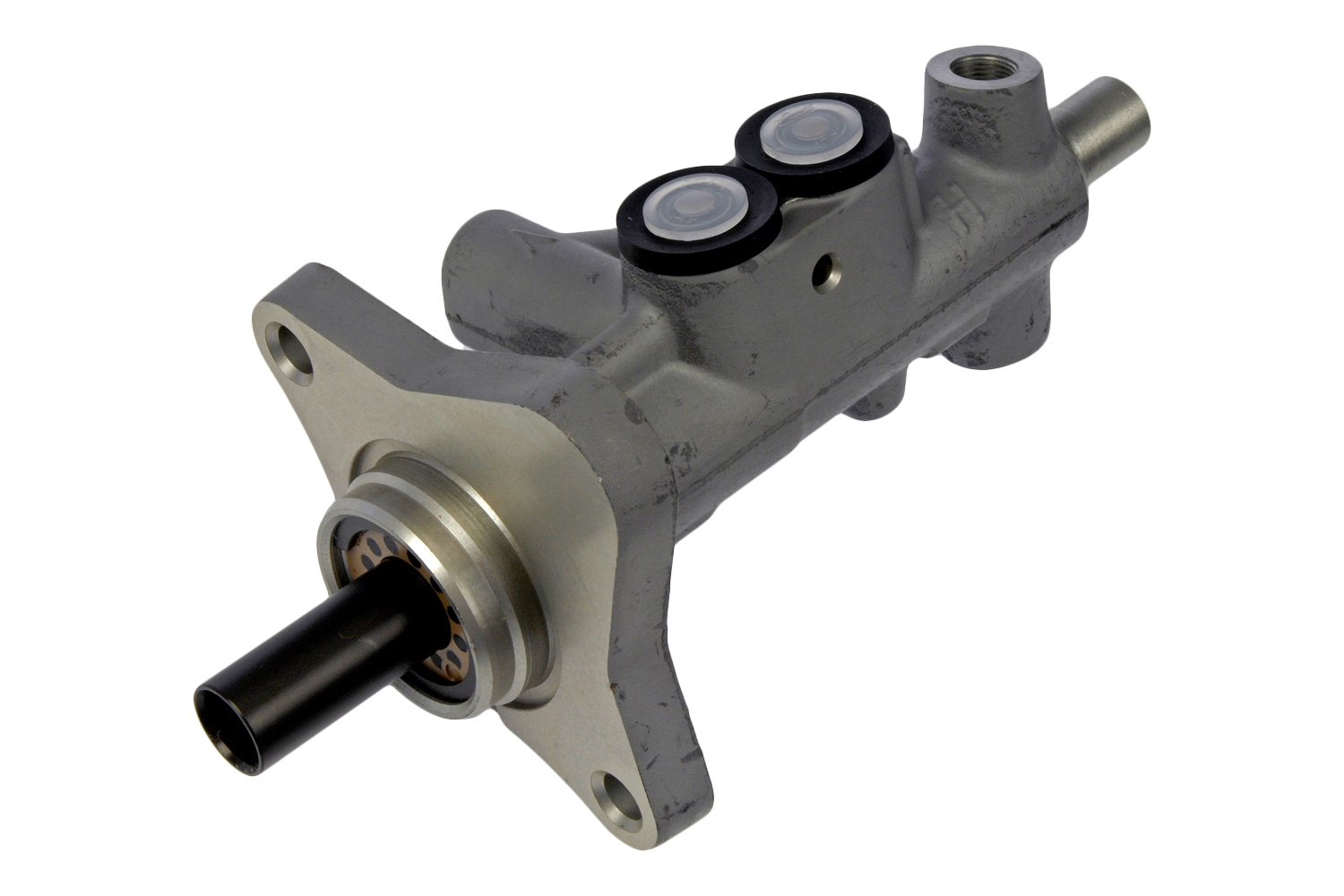

Sure, it's "005 430 89 01"...
ZAYED,,

the SL600 master brake cylinder is it heavy duty vs MBC for C43?
does SL600 MBC fit on C43 brake booster w/o modifications?
i have the w203 C32/C55 4-pot front calipers
do i need to get a better master brake cylinder for these calipers?
maybe C32 usese the same MBC as C43?

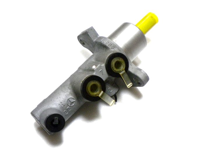

Honestly, what i remember, bend the line that attaches to the M/C, i didn't remember done anything else,
SL600 M/C is the last update mechanical version, i can tell it's a best one, of course this is my IMO,
pls if any one got another experience with it chime in,,
C32 got a differ. M/C with brake pressure sensor in it...
ZAYED,,
Attachment 288462
ZAYED,,
do you think it's a good reason to swap the C43 MBC for a better heavier duty version even for w203 C55 calipers?
you had the same 4 pot calipers in your car before, did brakes feel good with C43 MBC?
