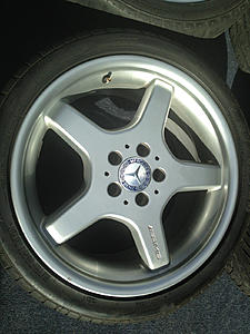

Just wanted to know if these wheels from a w211 would be a direct bolt on, and if I would have any rubbing issues? and also if anyone has run the H&R sport springs and how they liked the drop? did it eliminate most of the wheel to fender gap? Thanks, Im still trying to figure out what to go with so this would help alot.
Here are the wheel details:
THESE WHEELS ARE STAGGERED AND MEASURE 18x8.5 WITH A 30mm OFFSET IN THE FRONT AND 18x9.5 WITH A 33mm OFFSET IN THE REAR.
THESE WHEELS HAVE A 5x112 BOLT PATTERN.

I believe a few members here ha e those wheels on their c43
See my sig picture for h&r sport springs
My wheels are 18x8 ET 31 and 18x9 ET 35

Dimension is ok.
But I think those wheels are made for M14 screws. So you will Need Special screws with M12 shaft and M14 head (R=13 instead of R=12).

dont listen to just me but i think those front wheels at 8.5" might rub a bit. esp if you run a 245 tire?
it might only rub slightly at full lock on the inner plastic fender shroud. but i know there is not much room to go wider in the front, i have 8" front with 225 tire and there is not much extra room. though i wouldn't worry about the fender shroud, but might want to double check on the inside against the suspension components. will depend on the offset i guess?
i know the guys at the tire shop were iffy if i could even fit a 245 tire in the front of my car without rubbing, only way to know is to mount it and take a look.
or i think the stock REAR wheel on our cars is 8.5" wide with 245 tire right? might be easiest to just put that rear stock wheel on the front and see if it rubs. again have to have same offset though.
hope it helps, i would like to know if you can CLEANLY run a 8.5" with 245 tire in the front too, would help the understeer on this car!

They will fit like popey said, but your going to rub at 245s. I mounted a 235/40r18 on a 8.5 wheel with a 33 offset and I had to pull the inner fender forward to stop rubbing about mid lock. I can imagine with another 10mm wider tire, 3mm further out on the offset your going to have to address some rubbing issues. But there is only one way to know for sure... Try it out and see

Go on 225/40 255/35.
It is always difficult to discuss if a tire will fit... unfortunately manufactures don't respect their customers. You can have 30mm difference with same tire Dimension.
