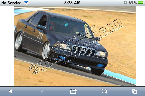

Ill post a pic of a c36 on h&r cup kit on 18s being pushed around thunder hill circuit as soon as i find it that way you can compare the body roll
Old Jul 17, 2014 | 03:51 PM
PJmak's Avatar
Joined: Sep 2007
Posts: 4,566
Likes: 421
Two people me in the passenger seat and im close to 190 lb.
The first pic is actually on stock cut springs and bilstein sports.
The second pic is with a cup kit and slicks and a lighter passanger
The car is being pushed pretty hard
Attached Thumbnails Springs: Euro vs H&R Sport/Eiback pro-img_221755361447820.jpeg   Springs: Euro vs H&R Sport/Eiback pro-img_1911.png
Old Jul 17, 2014 | 04:00 PM
Dziner82's Avatar
Joined: Jul 2012
Posts: 424
Likes: 13
From: Grand Rapids, MI
99 C43 AMG, 2001 CLK55 AMG
nice pics!
though they may be a bit deceiving, it looks as though you are on a pretty steep incline/embankment, which is a completely different dynamic. my shots were on virtually flat ground.
i have some pics of a monza bowl secton of a road track near me that looks similar yours, though my tires may not be tucked as much
Old Jul 17, 2014 | 04:07 PM
PJmak's Avatar
Joined: Sep 2007
Posts: 4,566
Likes: 421
True but that only means even less roll on a flat surface.
Btw on slicks hes gripping way more which means more body roll.
And this is a 6 speed c36 that was pretty quick

HI - yeah I do still have my C43 - and I also had since acquired a 2001 CLK55.
I transferred my H&R super sport springs and the B8s to the CLK. I ended up ordering the Euro spec springs for the C43 and Just last year I replaced the OEM euro shocks with Bilstein B6. B6 is the closer equivalent to OEM for the C43 - though still a bit firmer. B8 as i understand it have the same rebound/damping rates as the B6 they are just in a shorter housing for less travel on lowered cars, and therefore with less travel the feel is a bit different. (I believe they recommend 2" lowering for the B8). I would not recomment the B8 for anyone who wants to be close to OEM or is not autocrossing or tracking the car (which is what I do with my CLK). Im pretty sure im probably the only person that is currently running both shocks and in the past 3 different sets of springs on the C43 (super sports, NA OEM, and Euro) , maybe im wrong there - someone else probably has in the past.
For what you are describing I think you have 2 options, but both would involve bilstein B6
1. B6 shocks, H&R SPORT springs, and then experiment with the spring perch pads.
2. B6 shocks, OEM EURO springs, and then experiment with the spring pads, but I can tell you if you use the euro springs you will want probably 3nub or 4 nub spring pads to not have it be quite low.
See attached photos, this is my C43 just a couple days ago, B6's about 1.5 years old on it with the euro springs and I think I now have the 1 num (thinnest) spring pads on it. lighting is not perfect, but I have probably a 1.5 finger gap in the front and 2 in the back. the front is quite low but im happy with it, the gap on the fenders are close to uniform all around the tire - which is the look I wanted.

Thank you very much for your help Sir! This is really helpful, do you still remember B6 Product Number on your C43? Visited Bilstein website, they don't have anything for C43, should I get something for W205 CLK55? or CLK430?
