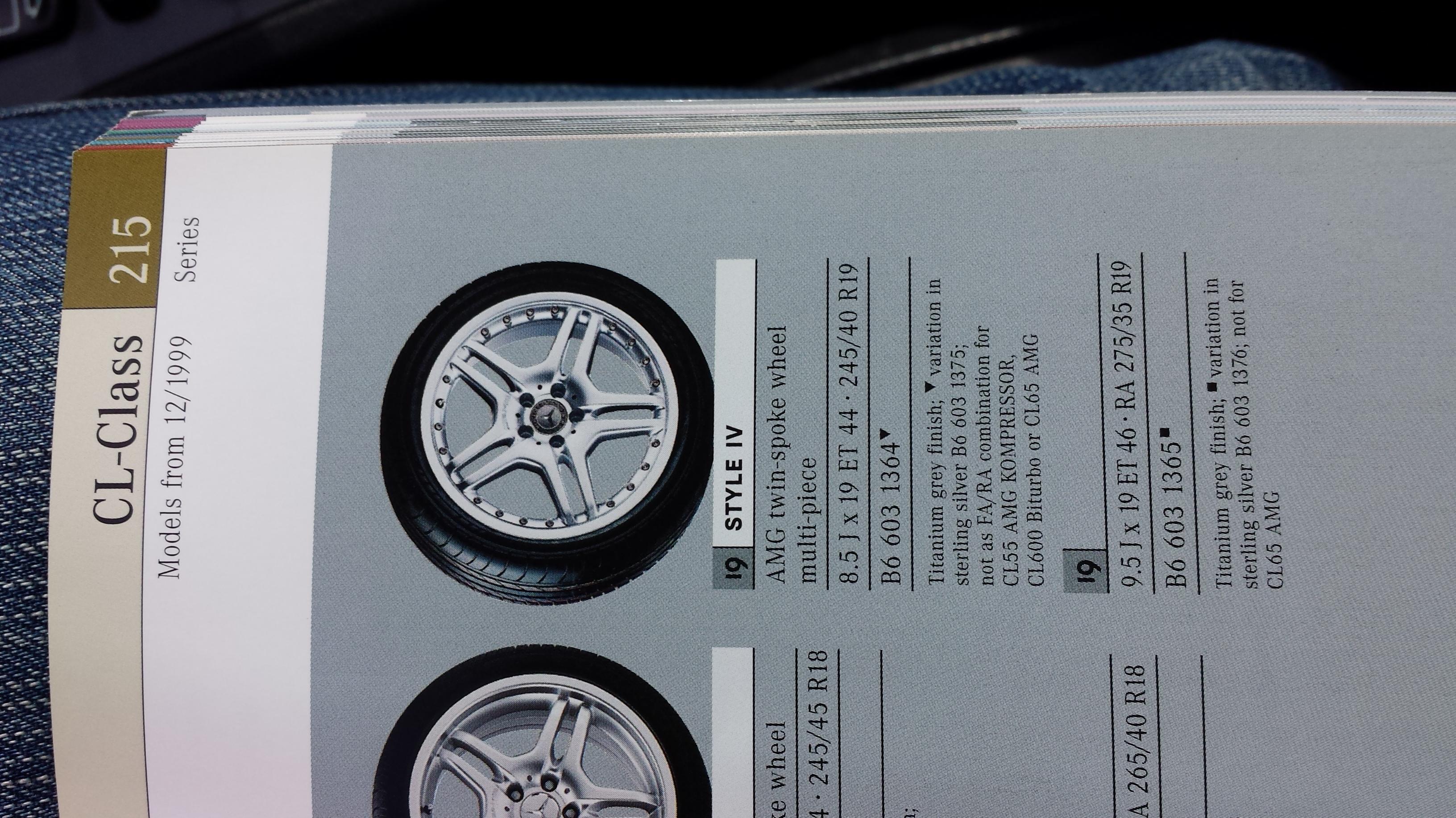

Btw your 19s come on a cl and cls and have different offsets

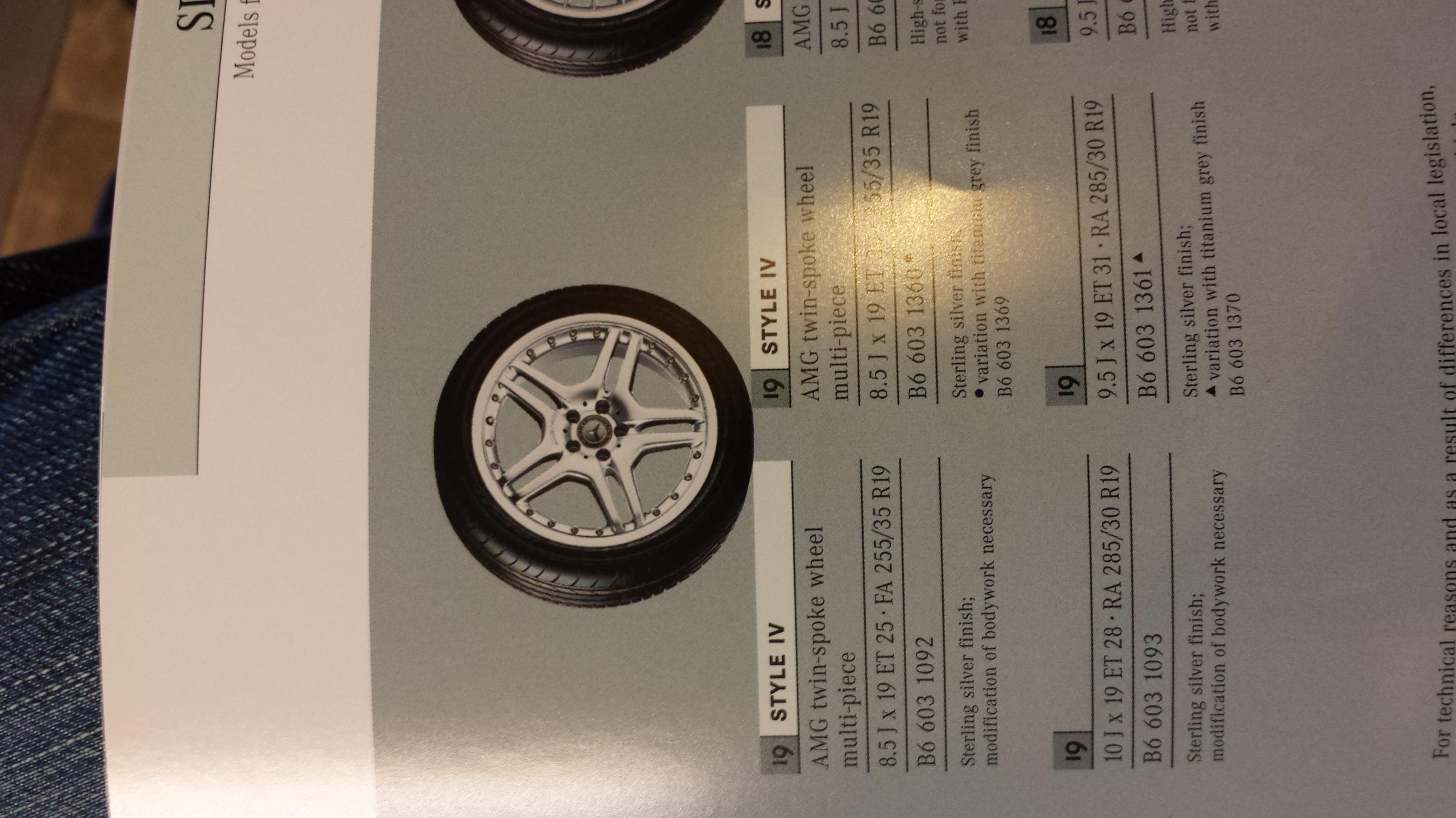

And sl sorry

Thank you, thats great to know. Unfortunatley mine are replicas but still great info.
Seeing your set up has me on a man hunt for the same.
