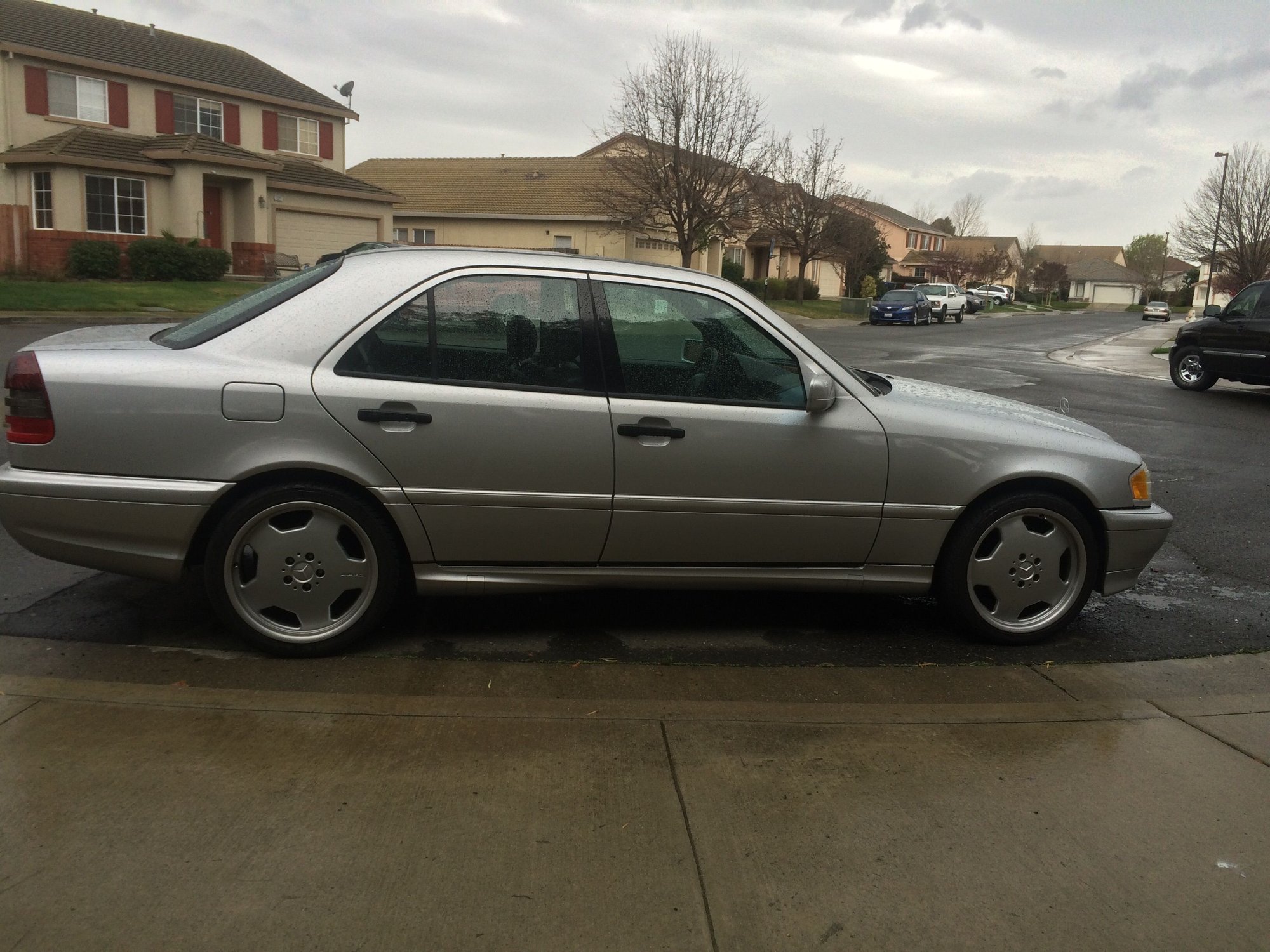

Here is mine on 19s and Eibach Pro Kit (just bought it with this set up)
I like a rake look so I just ordered the pads in reverse
4 in the rear and 3 upfront lol
Pictured Below is -
Eiback Pro Kit
W210 Front Pads #5
W210 Rear Pads #3

Current is in picture as shown above
#5 up front
#3 in the rear
I just purchased
#4 in the rear
#3 in the front
I wont have pix till Sunday - but keep in mind I want a slight rake.

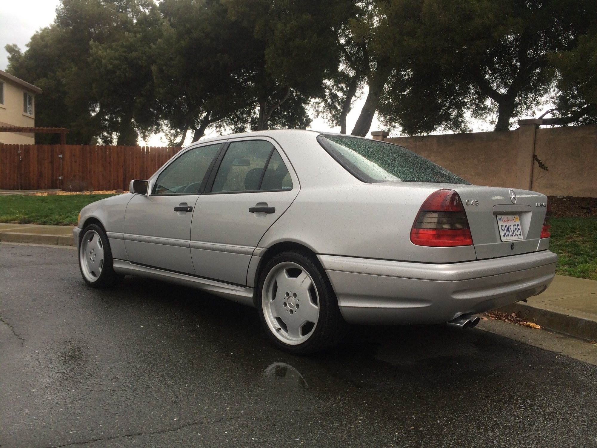

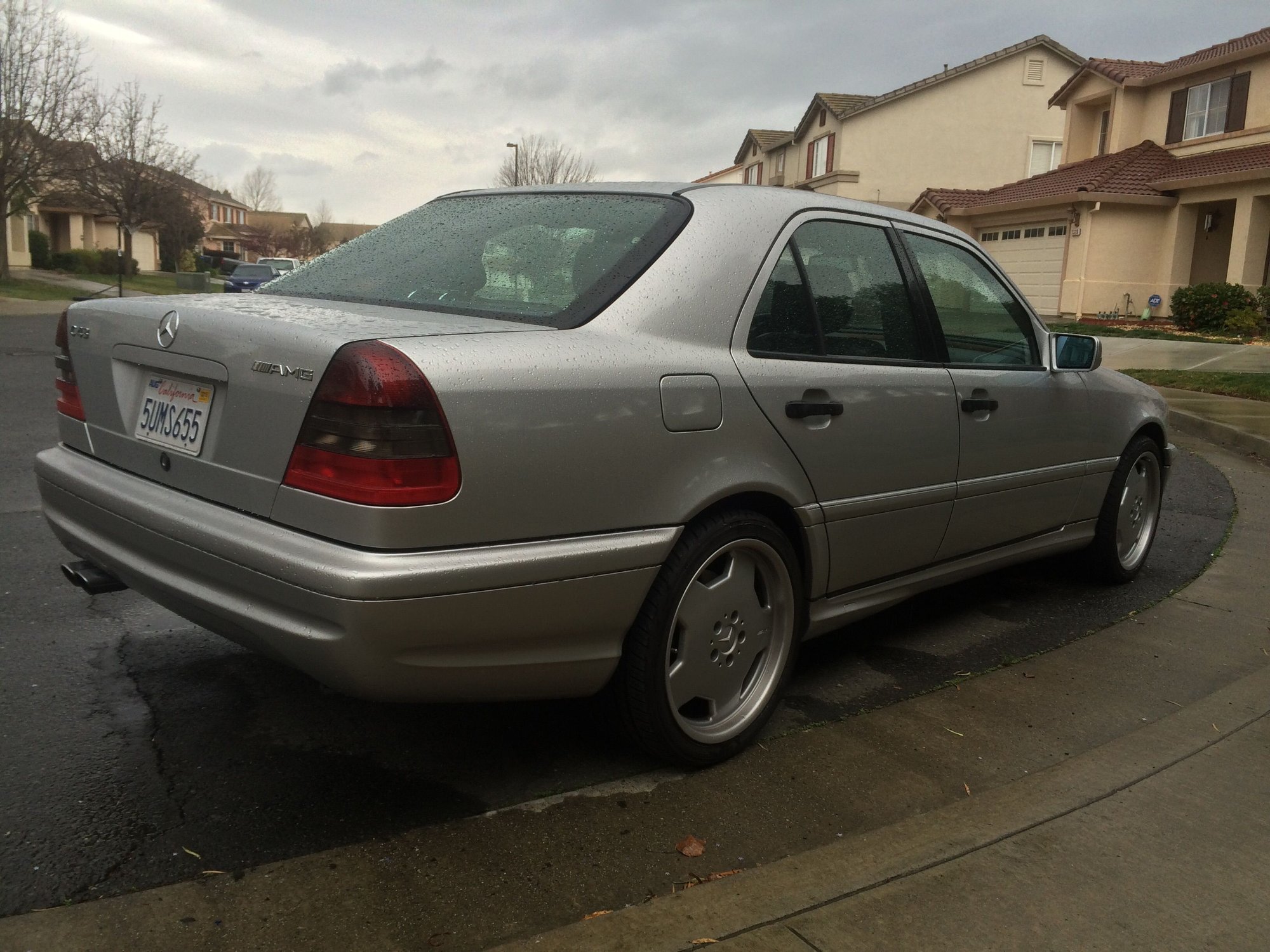

I will post pics tomorrow. My front bumper is from a kompressor though. Still trying to look for an AMG front bumper. I got the fog lights already.
Also, I have this pad - A 210 325 01 84 which I believe is pad #1 for the rear. Will that seat too low with this pad on the rear?

#1 in the rear would be very very low with a pro kit, I have a 3 in there
and its right above the wheel and most would say it looks great , I would have left mine but I want more rake.
To answer your question IMO #1 pad for the rear is extremely low.I would say go with the #3 that I have and go #1 or 2 upfront .
If you want low and level.

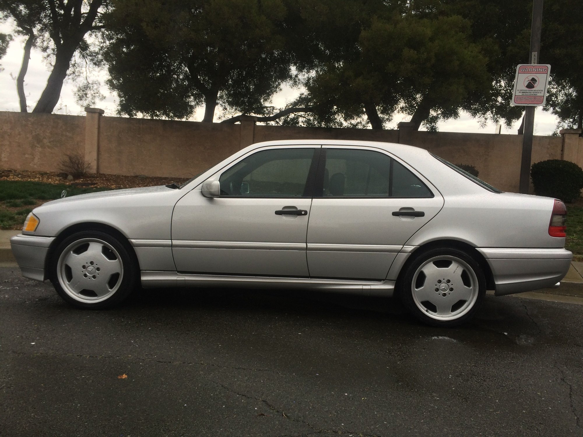

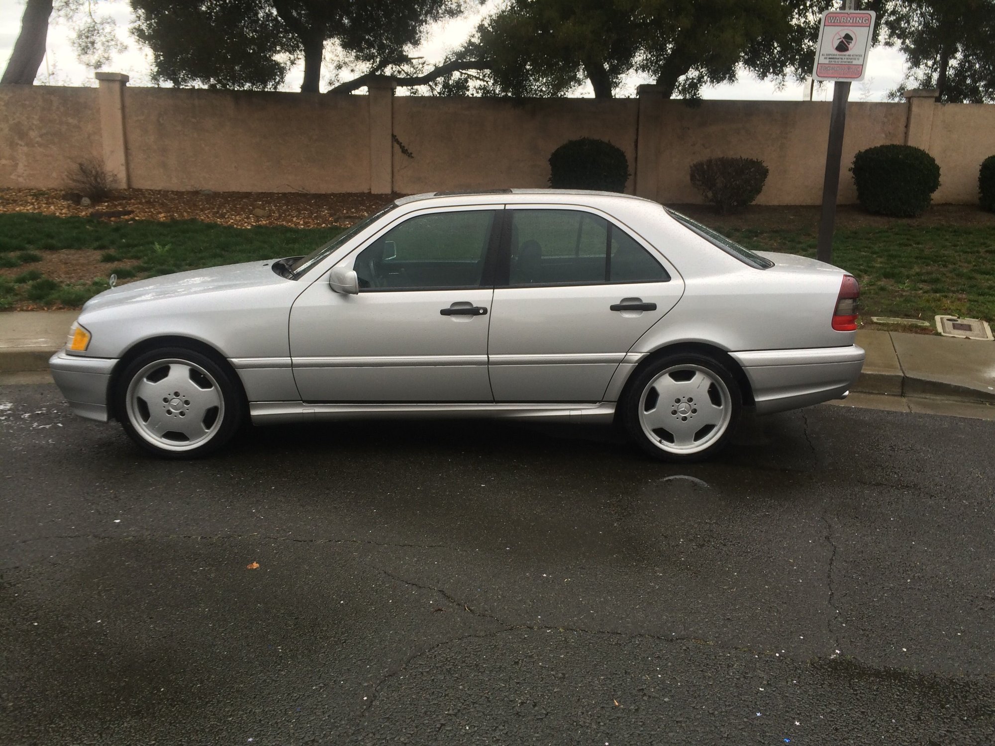

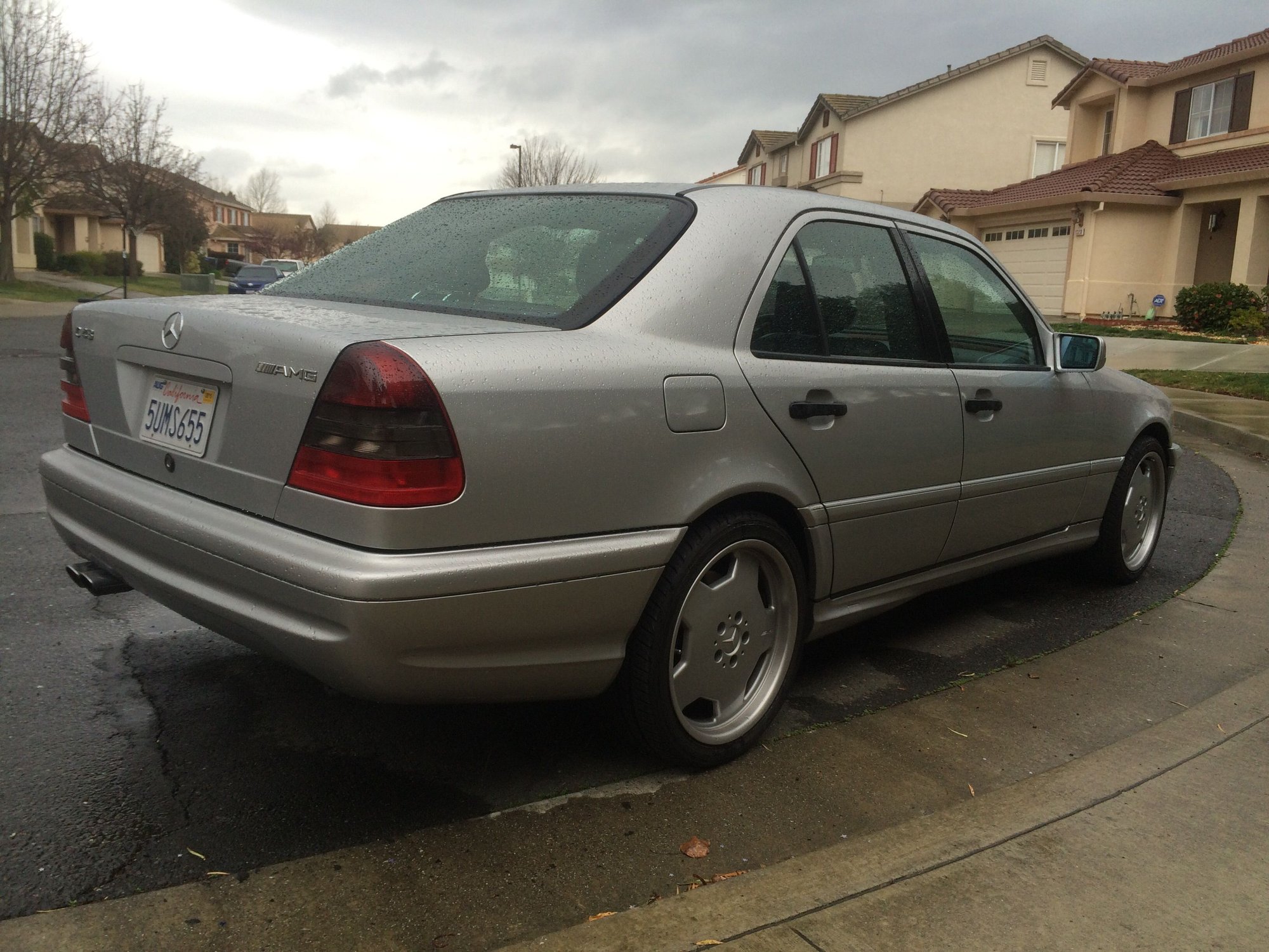

Im happy with the pads that I purchased after looking at your car, thanks for the pix.
with my Eibach pro kit #3 Pads Up Front and #4 in the rear should be just right =)
Eibachs always hang low in the rear, in some cases it just appears that way because of the
body lines and fender wells being different cuts. But appearance and they way it looking rolling
or stance as some call it to me is more important than Ground to Floor measurements

Originally Posted by kowalski
what da heck?
that's some serious wheel gap height!
It is stock that is why. I have the springs but dont know yet what pads to put. I am waiting for MPOW33R's setup so I can see what pads to use.
