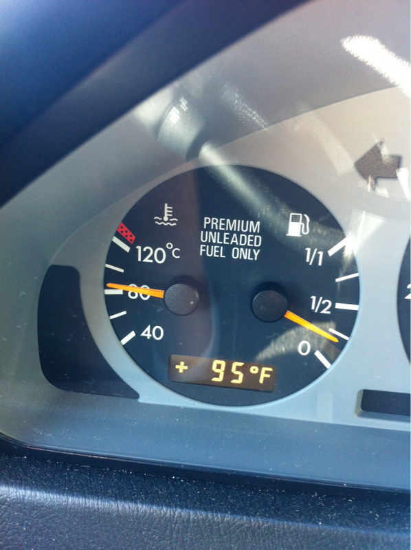

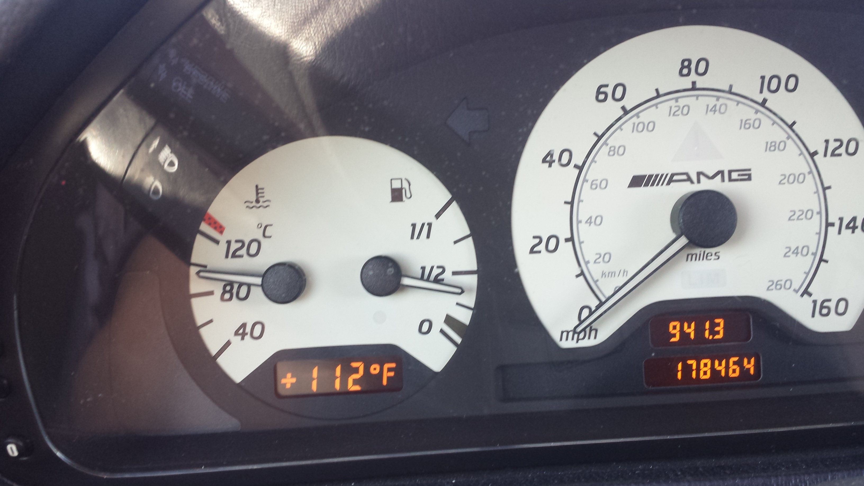

My 36 never gets over this unless something was wrong. Only time I have ever seen it get to 100 is when the top half of the thermostat failed. Picture was take with AC on while running around town and then idling in parking spot.

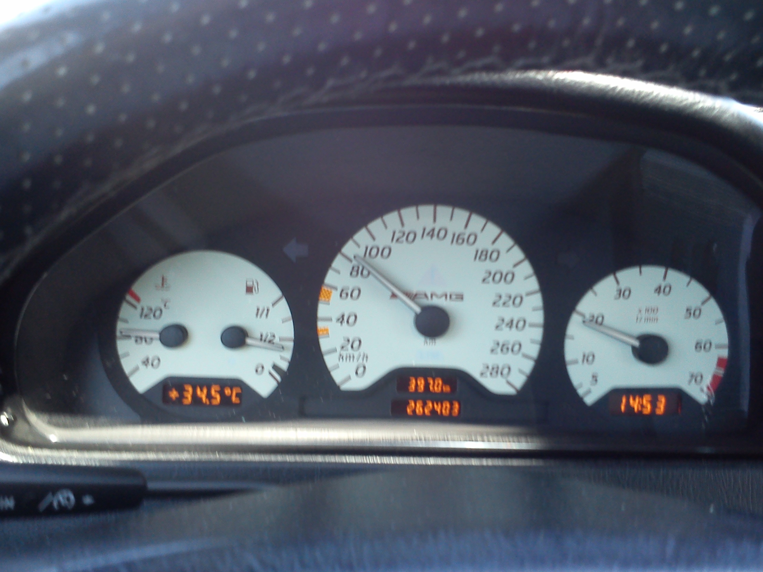

Originally Posted by RPB
I appreciate all the help guys! Very helpful and responsive section of the site here!! I hear you Vince, what you're saying does make sense to me. It was quite humid here today, I took these pic's and I was barely sitting in any traffic when it was registering these temps. Do you think this is normal? I will try the test you recommended, it was raining all day and did not have the chance to rev it up like you told me to. Please let me know your thoughts:
On the temperature question, we are starting a hot dry spell which should extend over the next days and probably next week too.
First photo shows engine temp when running at stable speed (driving with the tempomat) on the highway.
Second is in city stop and go traffic.
Hope that helps but you are running a bit higher than me. Influence of extra humidity level perhaps?
Attached Thumbnails Viscous fan clutch?-motorway-running.jpg   Viscous fan clutch?-stop-go-city-traffic.jpg

Been in stop n go traffic for 15-20 mins with ac on low one bar below full blast. Obviously its hell outside here in Nor. Cal.

Interesting comparison. I see that temp level if I'm doing a mountain pass at speeds
