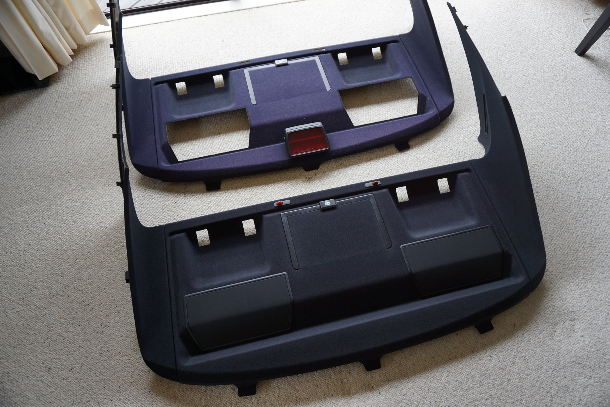

Thought I would share my experience with this as I think many like the thought of replacing or painting to get back that original look.
I decided since installing the amg boot spoiler with 3rd light I would no longer need the original mounted to the parcel shelf, amg supply a black stick on cover for this as part of the spoiler kit but I think that is a bit cheap.
Having wanted to restore the shelf to original black I looked into spray alternatives and even original farbrics however because the material goes very brittle, it was unlikely it would look good or even consistent at best, so I went with a complete new shelf and C-pillers.
I was a bit surprised when it arrived, even though I had ordered it as the correct part for my C43 specs, it arrived with no speaker cutouts,or cutouts for the seat latch indicators,these had to be very carefully cut in with a ruler and sharp knife. I checked in epc again and even the picture and description there shows no speaker cutouts. There are some faint indents on the rear to show where to cut, which helped only a little.
As a bonus, the new shelf did not come pre drilled for the 3rd light, so no need for any covers now just re-wire to the spoiler, very happy with this
Now always garage your C43

Awesome! I hate that I always notice that aged blue look on mine
How much was that? Looks perfect

It bugged me a lot too on my previous 202!
It is hard to justify the cost as the parts add up to around $400usd if only doing for colour refresh,but it works out well with the spoiler install.
Not much beats the new finish on these original parts
