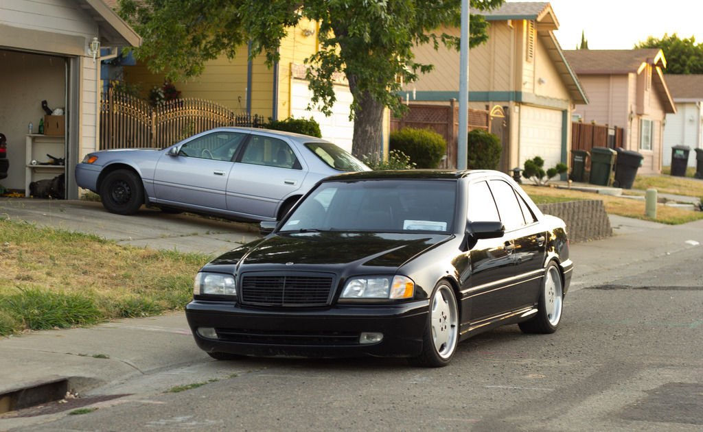

Wink
Its weak and tear my friend
Does this look like a lemon to you

are there any black lemons?
maybe lemon got to much sun
front bumpah looks fucced, uther than dat, car looks fine.
did Yo tamper this picture?
