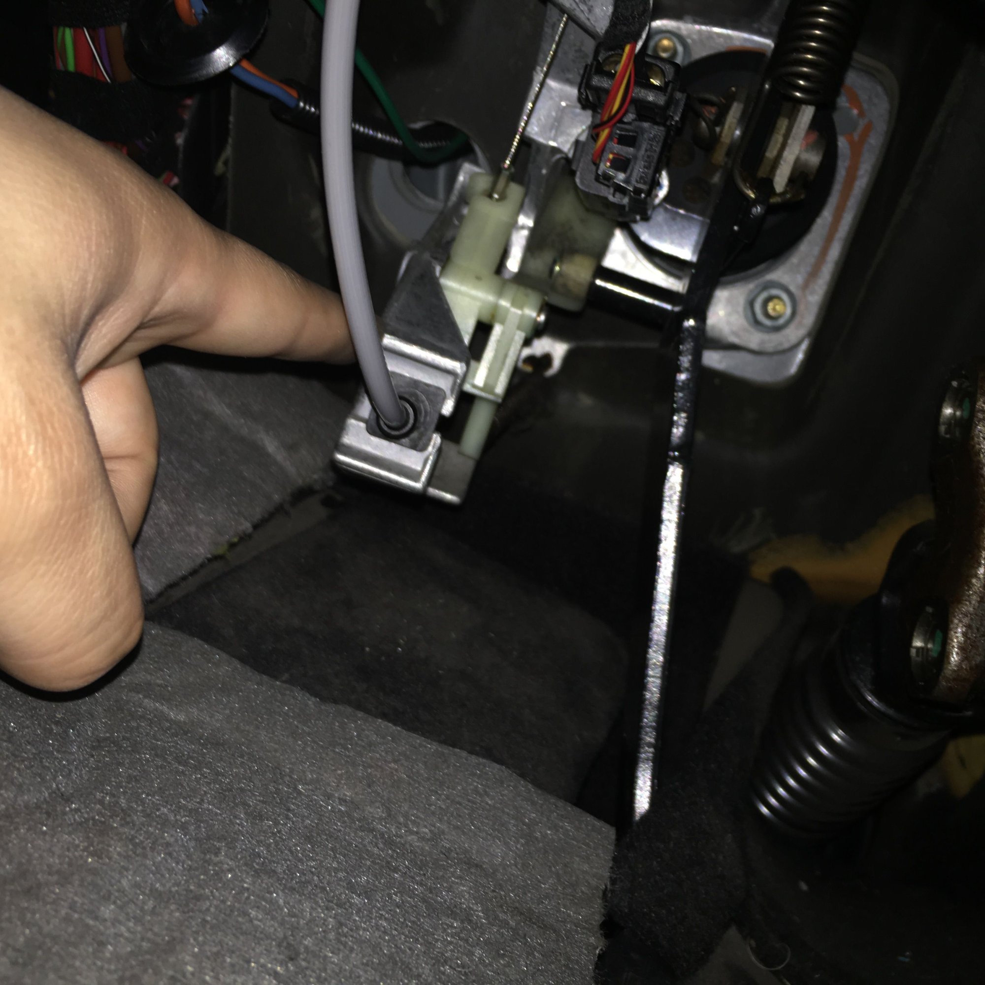

Problem fix
Ok found the problem, underneath my dash board there a broken metal piece that attaches the shifter wire and when
I press down on the brake it sense it so if it's in the right position the key will come out, but sense it's broken and I press on the brakes, it moves the metal so next time I start the car key won't come out unless I manually adjust it to make key pop out , tricked it by removing top metal ball piece now I can remove my key

I have no idea quess it's been broken and I just got a bad brake sensor and checked up on it and it was broken, looks like you needed to force it to be broken, which is strange I don't no how it happen so I just took off the silver ball out like it was to trick the system to take out my keys again, and now I have no abs lights on and my car has no check engine light or anything.
