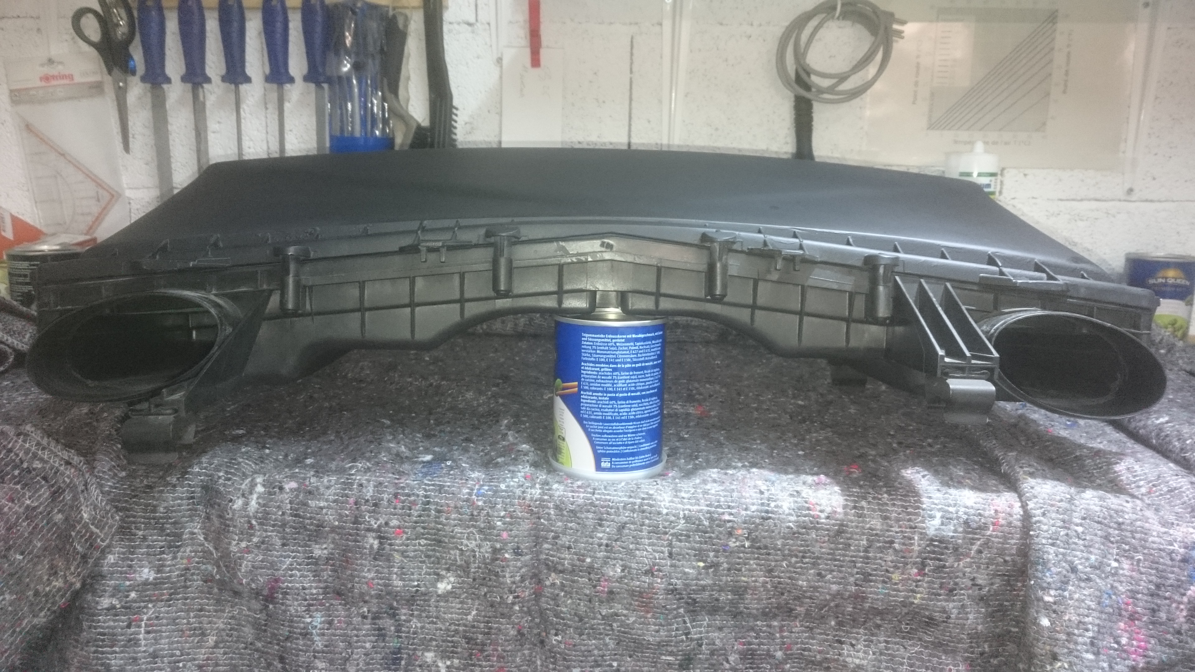

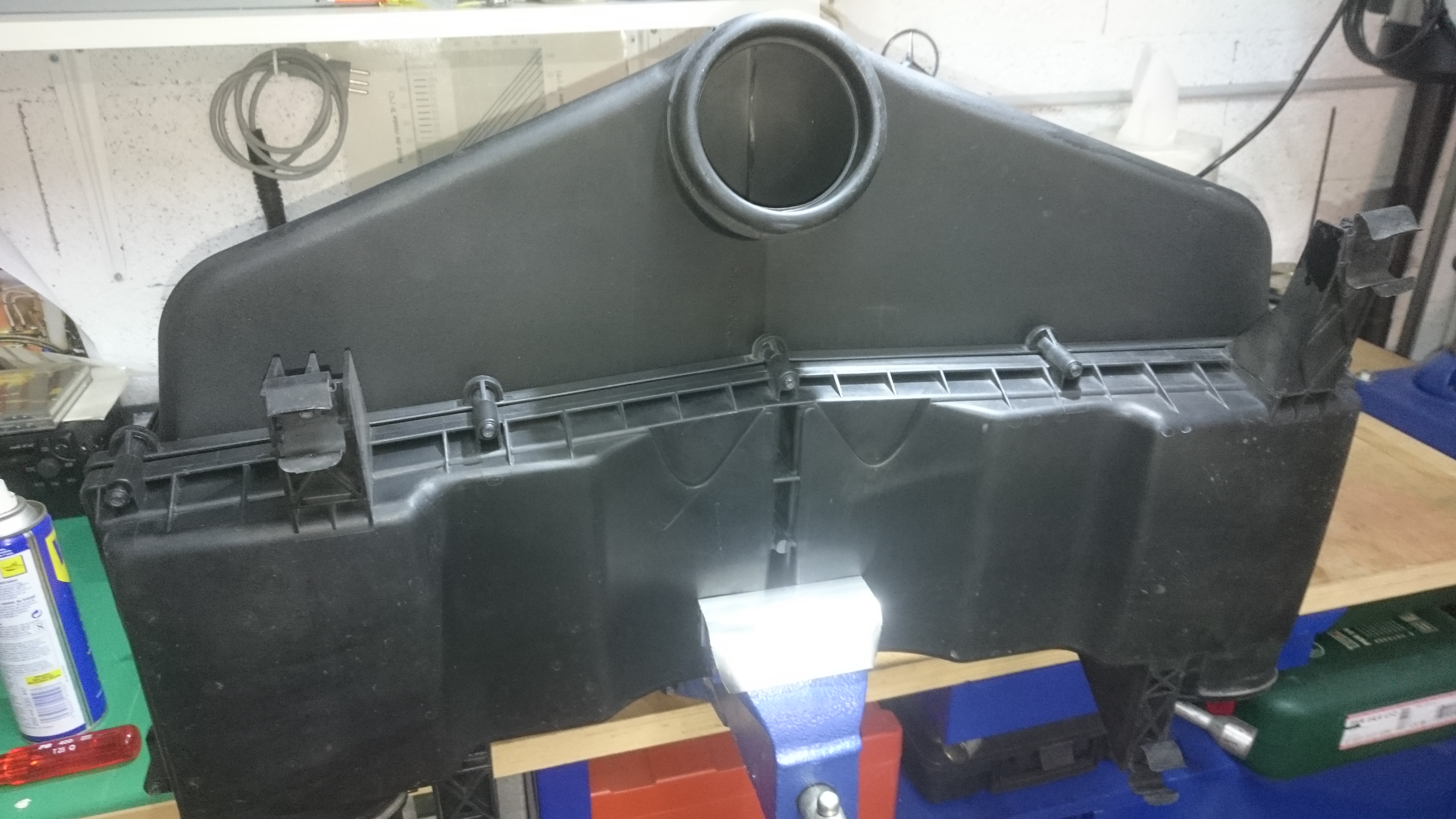

As I mentioned in the thread https://mbworld.org/forums/c36-amg-c...air-boxes.html I'm starting a new topic which will cover the discovery, installation and later on some driving impressions using this upgraded air-box.
The beginning: the Postman delivered a parcel this morning after it was held up a week by the Swiss customs authorities
Old Apr 18, 2016 | 08:12 AM
DRBC43AMG's Avatar
Joined: Mar 2010
Posts: 5,889
Likes: 323

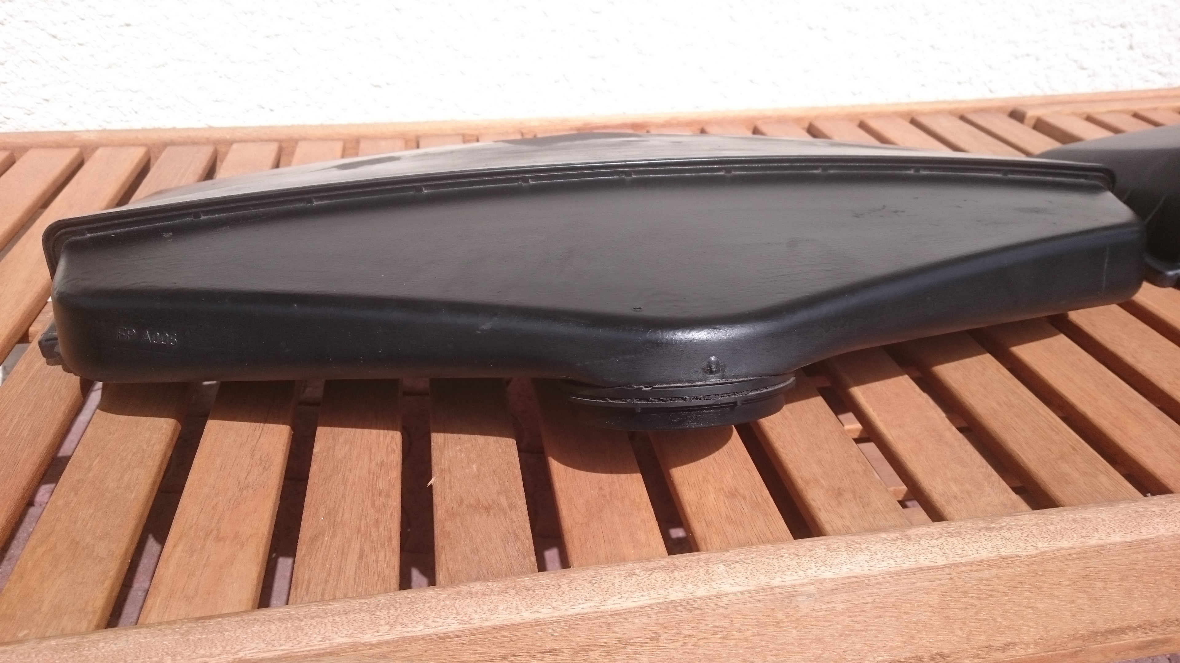

Surprise...
The difference in size between the OE and modified air-boxe is ENORMOUS. George you have done a great job
Attached Thumbnails Spring preparation 2016-dsc_0644.jpg   Spring preparation 2016-dsc_0645.jpg
Old Apr 18, 2016 | 08:14 AM
DRBC43AMG's Avatar
Joined: Mar 2010
Posts: 5,889
Likes: 323

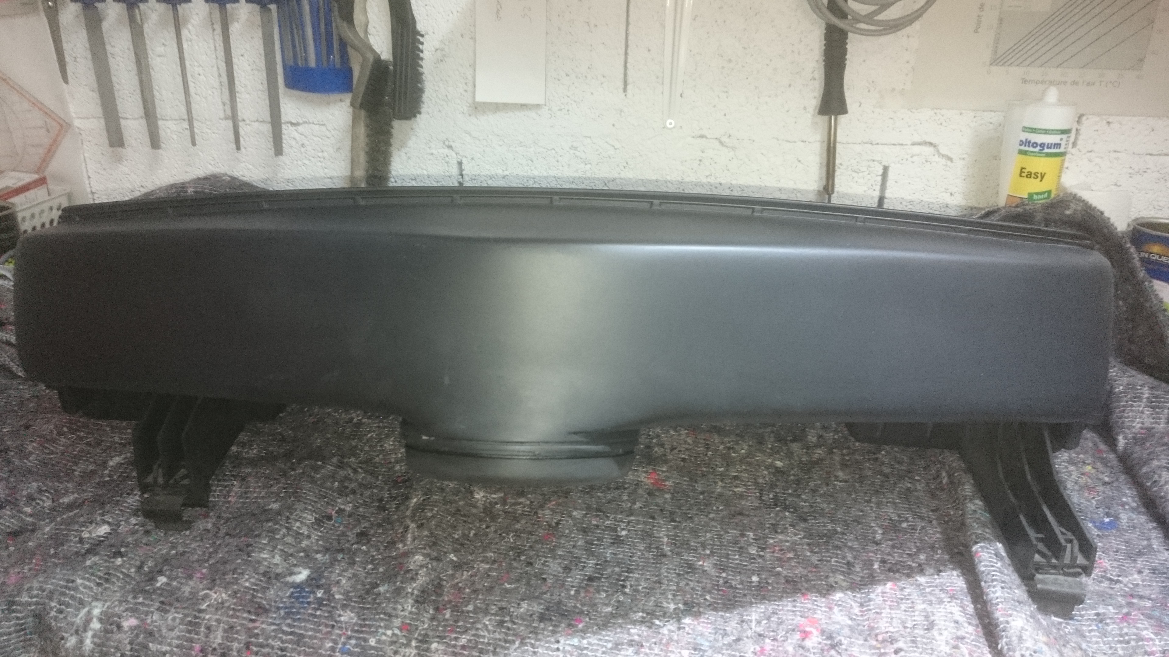

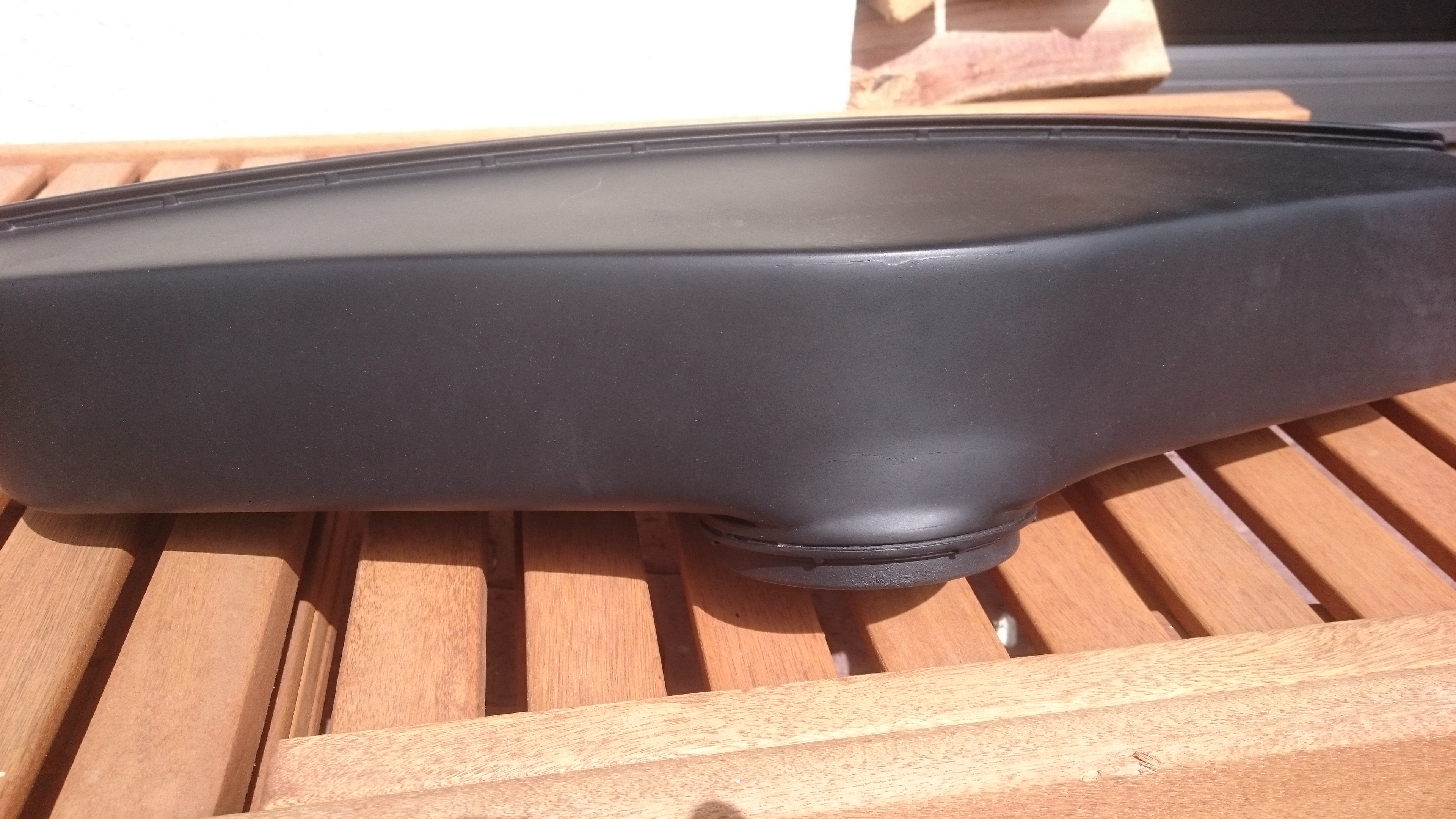

Placing the two boxes side by side or one on top of the other (depends how you look at them) like two pieces of bread in a sandwich, the difference can clearly be seen. No denying the new one is BIGGER

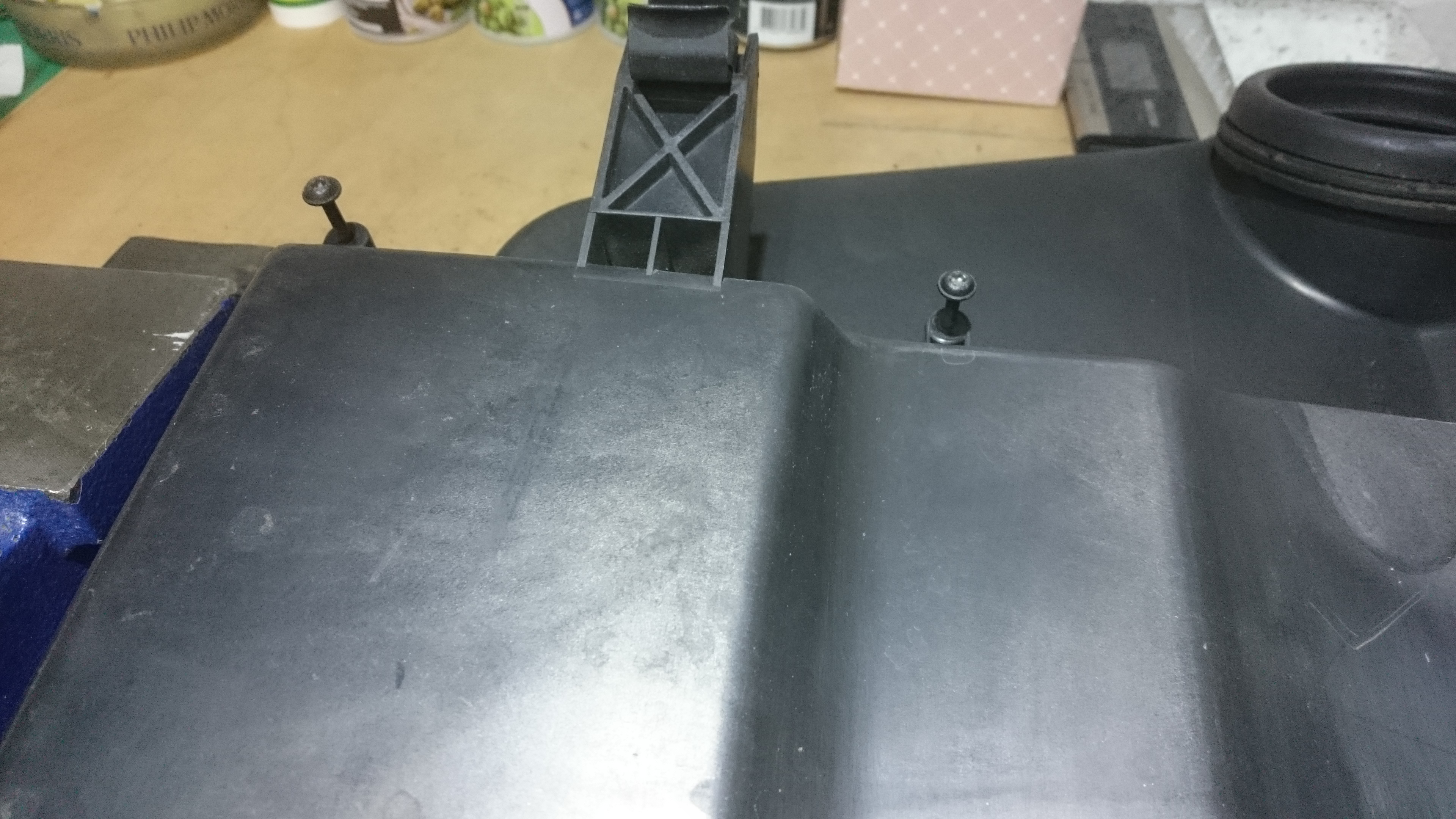

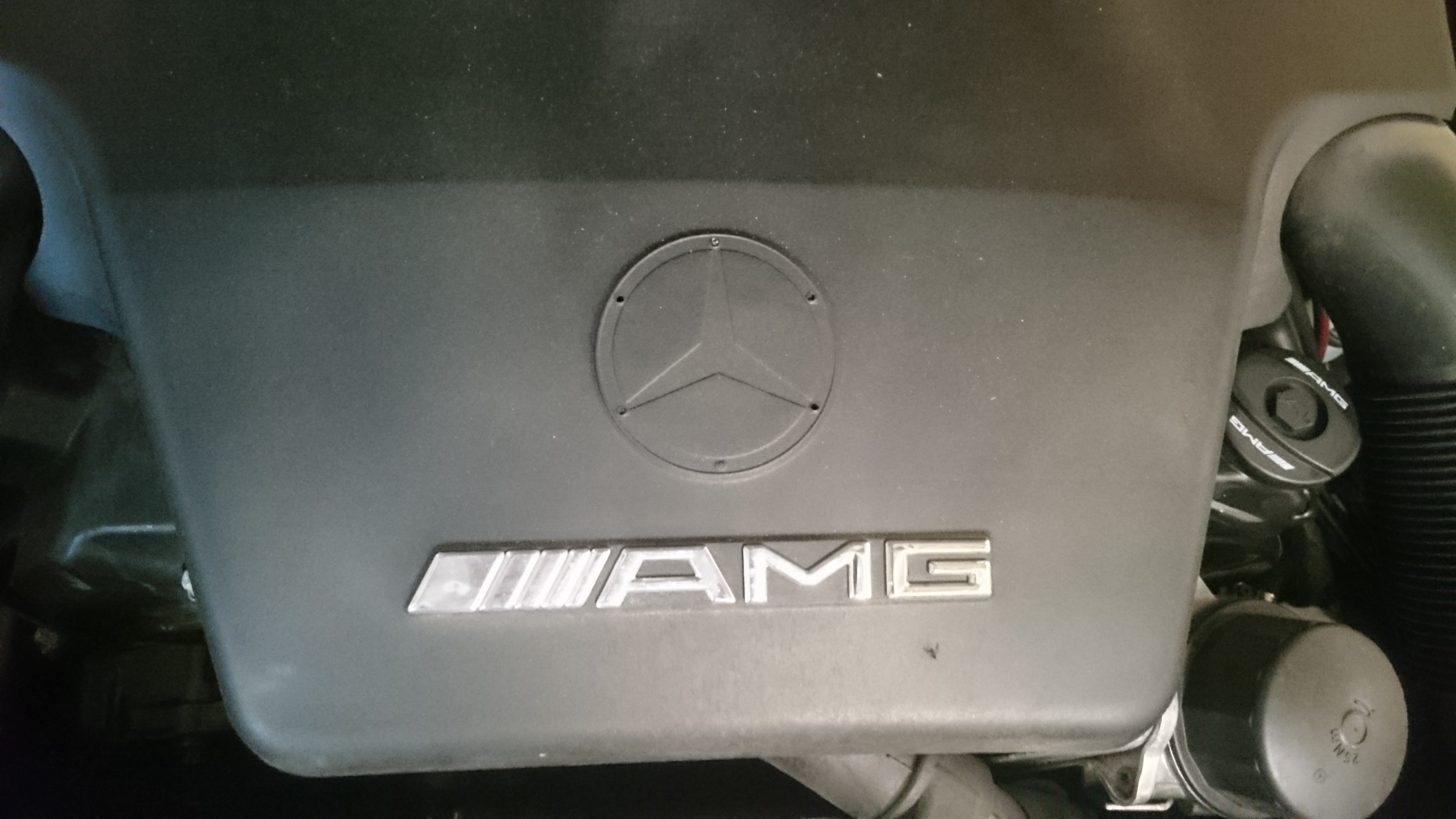

Getting things ready
After removing the front engine cover (the new Star has been ordered and will be replaced, thanks Vicious_c43 for the tip https://mbworld.org/forums/c36-amg-c...air-boxes.html), you remove the front left and right air intakes from the air-box (they were tight to remove but I managed without any damage), then pull the air-box off the 4 clip retaining block nipples and the throttle manifold. Best to cover immediately the throttle intake with some paper or masking tape, to minimize the risk of unpleasant things dropping inside. BTW I use a rubber work glove to cover the intake. That works a treat.
Flip over the air-box and using a n° 25 size torx screwdriver or similar tool unscrew the 11 retaining screws. The screws don't screw totally out of the box (at least mine don't...), so just make sure to unscrew and pull them back as far as they will go so as to facilitate removal of the base.
Separate the two parts of the air-box and remove the two rectangular panel filters. I have used Green filters for 4 years now with a yearly clean and thin oiling. After cleaning and oiling they will be reinstalled in the upgraded air-box. That should also help engine breathing.
Next will be some work on the new air-box. I see that some fettling inside will further improve air-flow. More on that in the next episode

Old Apr 23, 2016 | 04:31 AM
DRBC43AMG's Avatar
Joined: Mar 2010
Posts: 5,889
Likes: 323

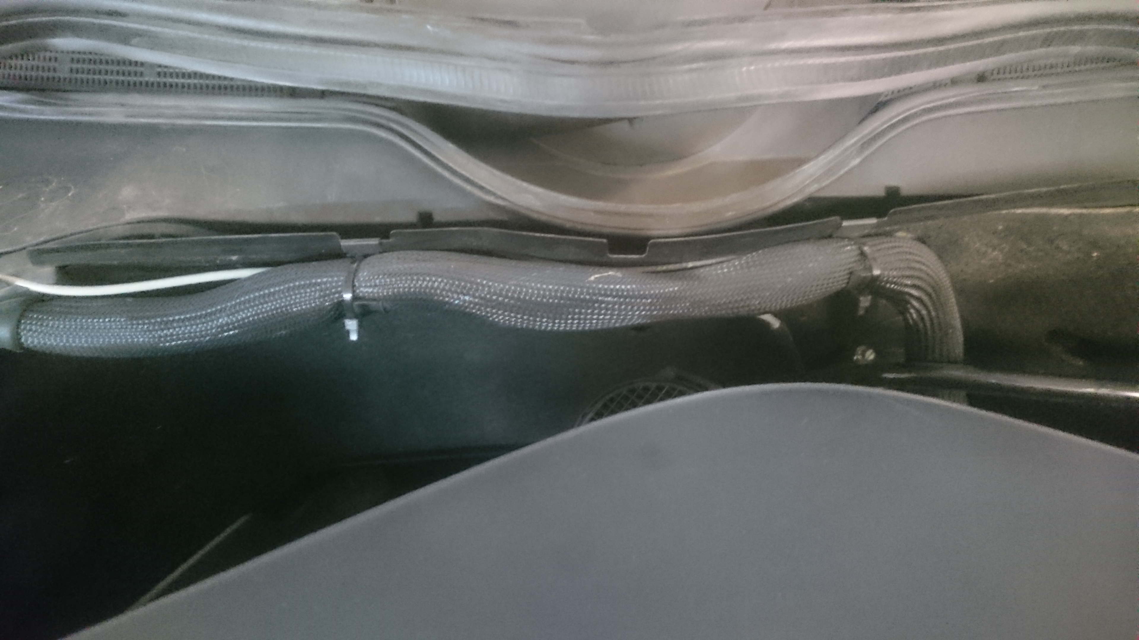

After cleaning the filters, I assembled the lower filter framework to the new upper air-box. Everything fits perfectly and I just had to remove and swap the throttle body rubber O ring.
I then dropped the new air-box in place making sure it fits snug onto the throttle body and the clips fit nicely on the four holding nipples. The loom which passes on the frame behind the engine needs to be unclipped as it is impossible to place the air-box with the loom in place. As I have the BIG 4" version, perhaps the newer lower ones will pass without having to remove the loom. I'll see if I can place the loom above later
Everything is now in place, except the front engine cover which needs to be repaired with the new Star I obtained last week.
Engine is ready to be started after the battery is connected, but no driving will be done till next week as I need to collect my plates as I deposited them over the winter months.
Stay tuned peeps for some driving impressions!
