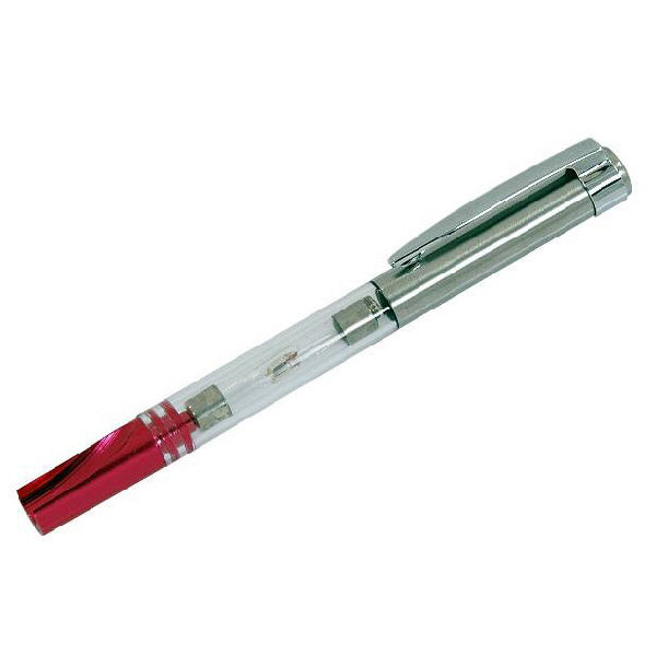

tool
This is the item i use to check for faulty spark .
Ebay item in UK so you may get them in the USA also i bet they are made in China. -Ingnition Indicator Testing Tool . Just pop it on the wire to see it sparking .
Can you tell me what brand it is and what the name of it is?
Even if i put in the wire i won't be able to tell if there is a spark and from the sparkplug?
I got "Lisle 19380" last year, it's good,,

CM60 just the same but another packing .
