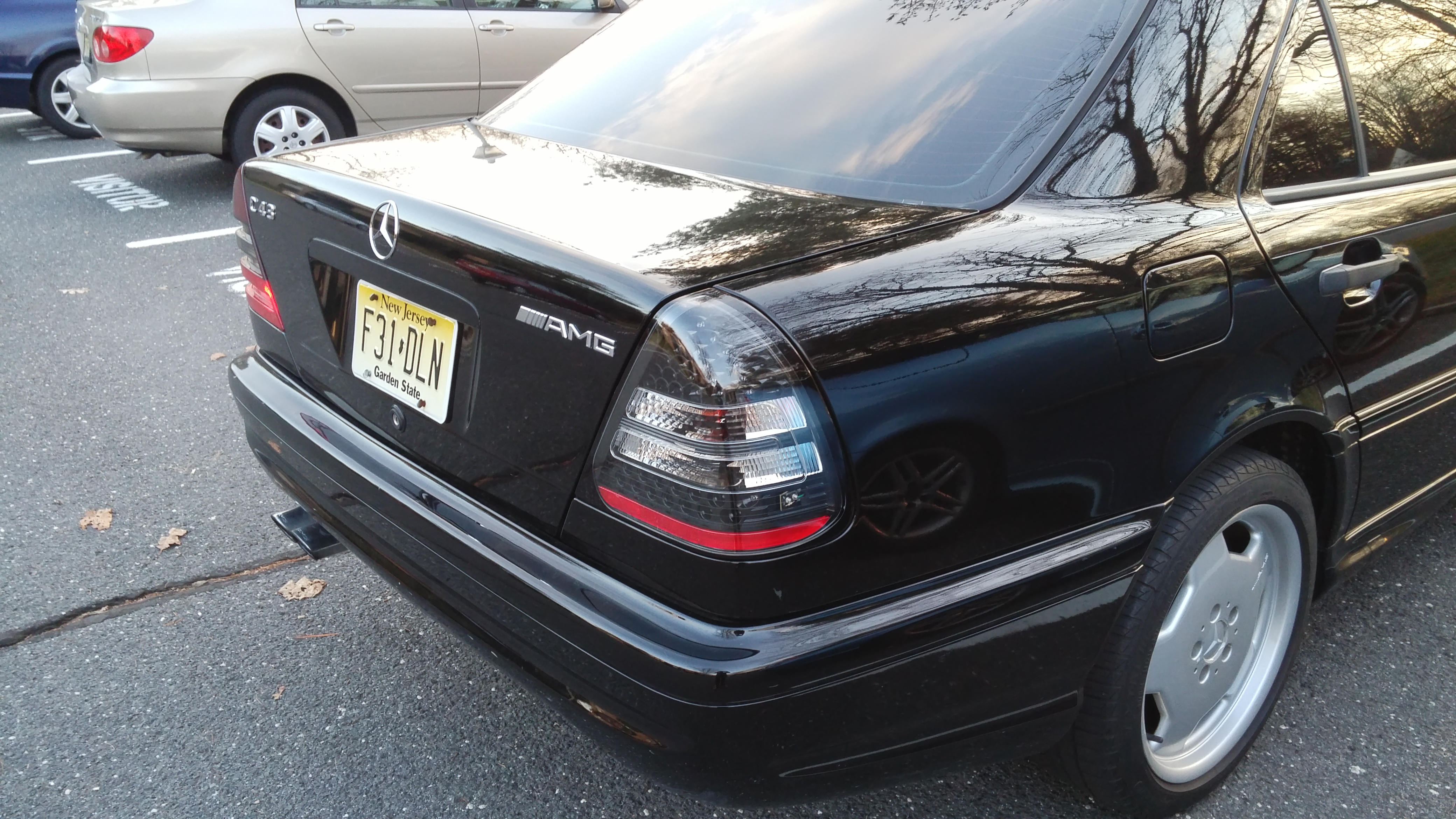

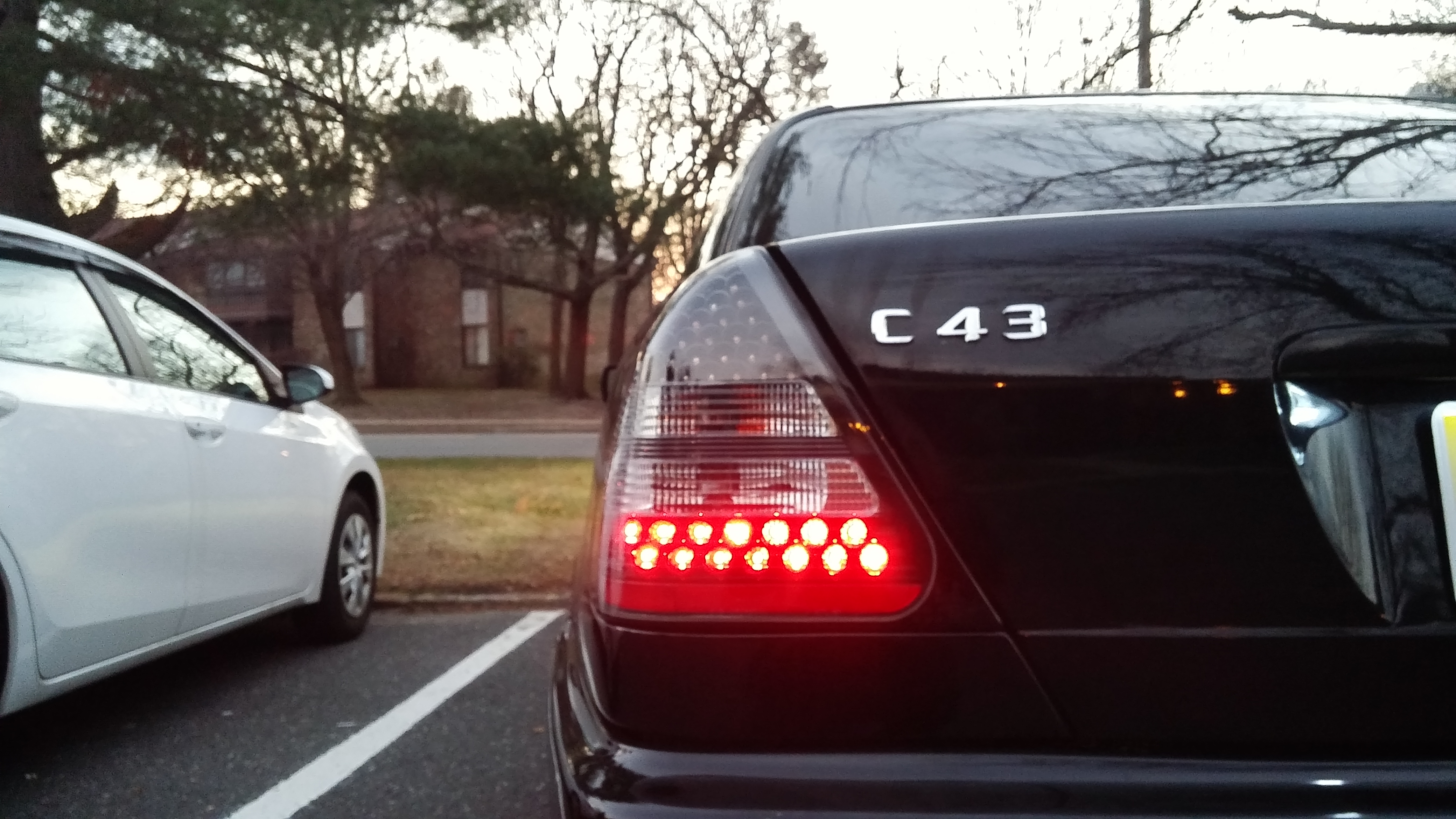

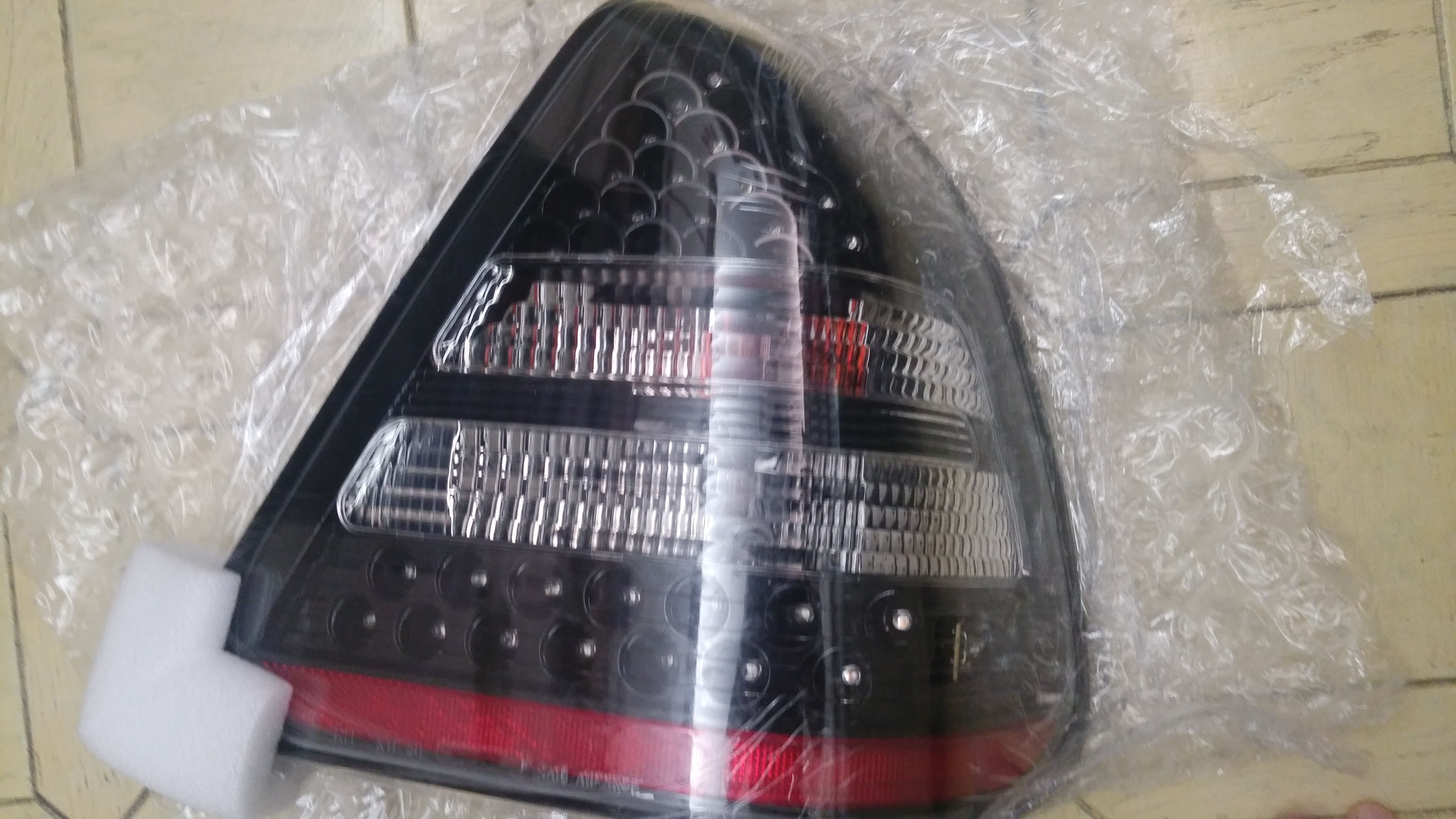

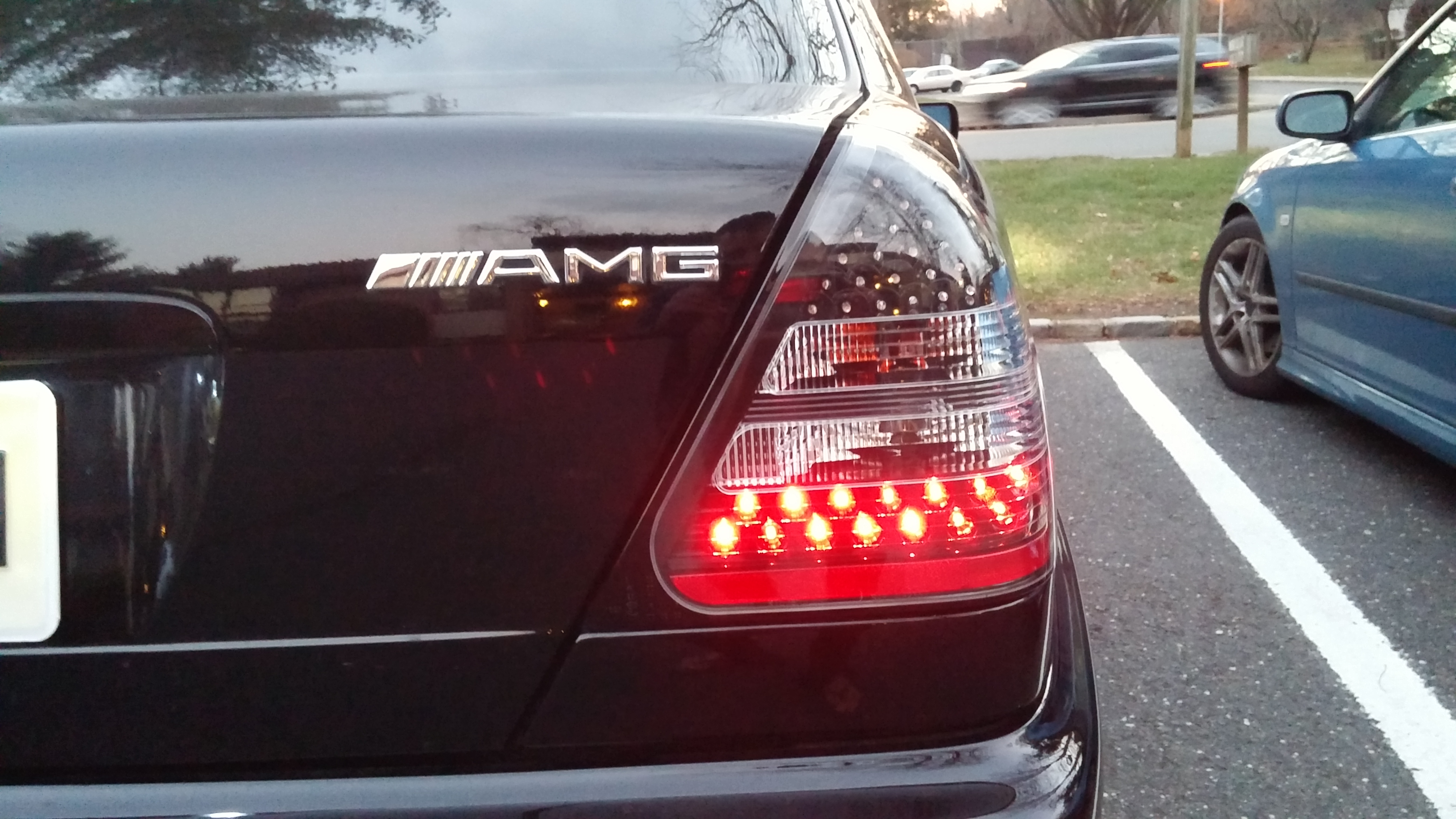

i got them and put them in but i damaged the first one on install because there are so many wires inside the lens so when i tightened it up i must have shorted some wires (i was really squeezing it in). these were the last pair and shipped from the UK so instead of the return process, i started unwrapping around half the wires and found a short, i could see they were pressed together from me. i taped the wires and i also pulled out two converters/resistors out of the housing and let them hang on the backside, that really cleared up the housing for space to close. but theres another short because i hit a bump and it went out again.
so i'll pull it tomorrow and go over all of the wires. here are some pictures after i straightened the first short.
Also, after the install and solving the first short, my "mystery" light out dash warning that i've had for more than a year went away. WOW. She likes the new lights. Funny because I replaced the electrical housing on the side where the bulb was out and it didnt solve it.
will follow up tomorrow after i disassemble this thing again.
fit and finish was pretty good. i felt like fit was a bit better on the passenger side, it didnt take much to adjust it and it looked good. fit on the drivers side took more time and just didnt look as perfect, but with some fiddling it turned out OK.
