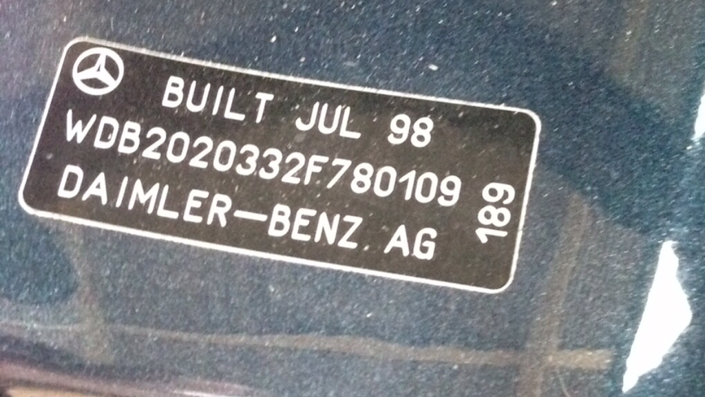

Feb 27, 2017 | 12:12 PM
Quote: Post your VIN!
See attached:
