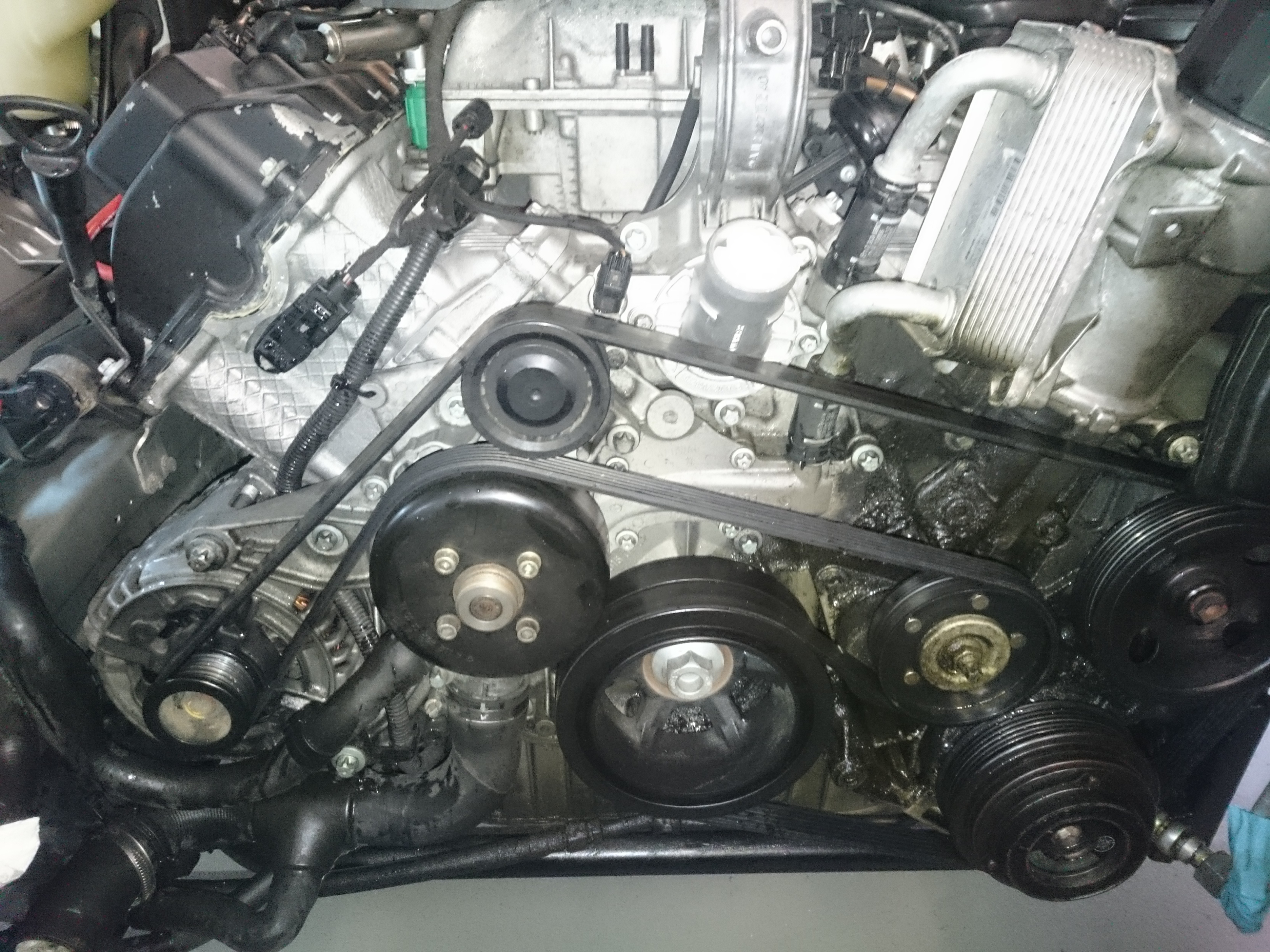

To the OP: I would change the serpentine belt and if you want to do a simple preventive job, replace the idler pulley above the water pump and to the left of the thermostat. You can find plenty of DIY videos on YouTube for this job
Sorry for the dirty engine but I hadn't cleaned it yet, and I did find the oil leak which has been bugging me for 2 years now! It came from the lower side of the oil pressure test port (see the rectangular top caked in oily crud just above the tensioner)
Attached Thumbnails Is this a belt noise-2017-03-15-16.27.23-223-dsc_1529.jpg

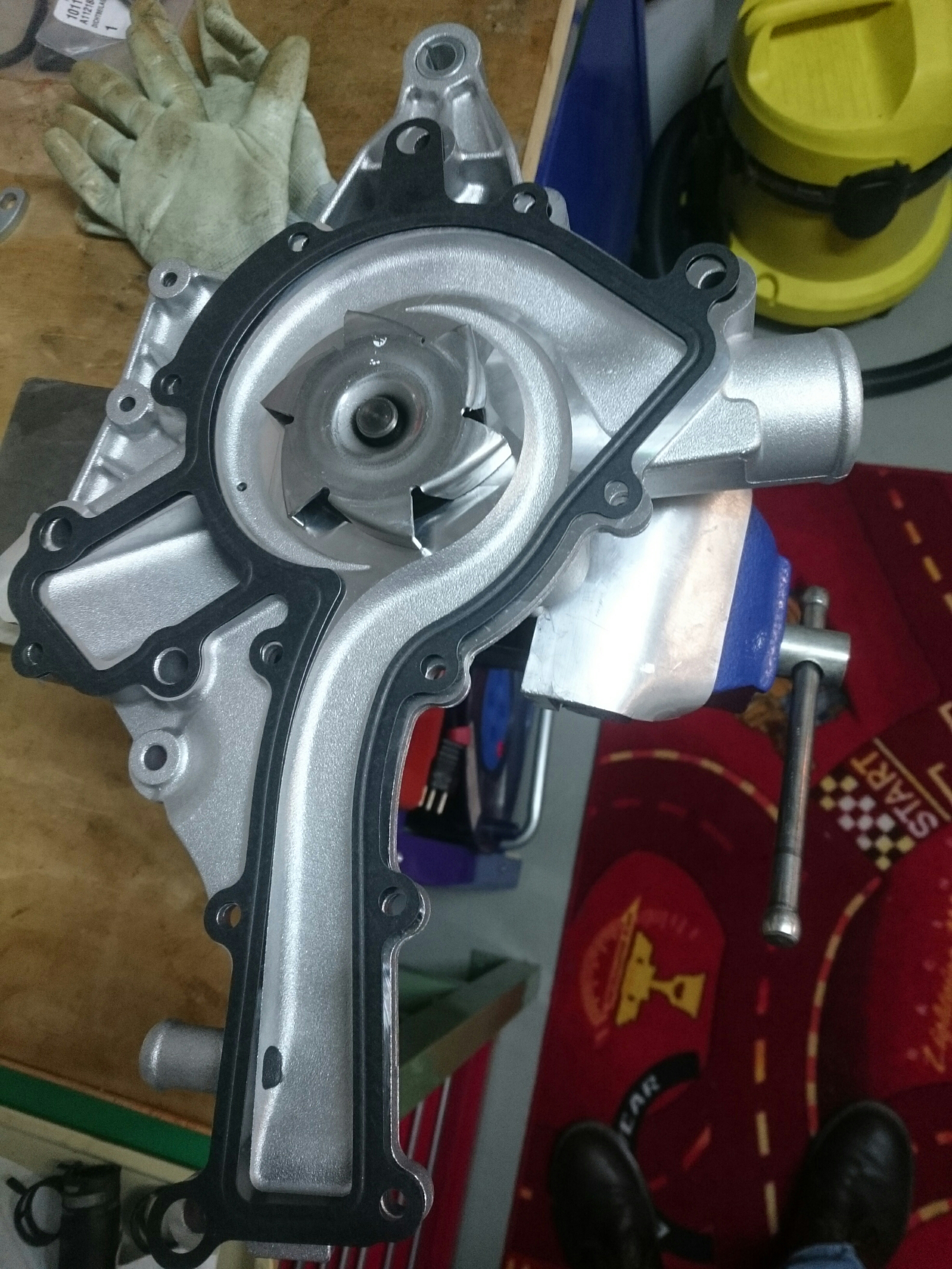

Yeah, probably change bearing, axle, rotor and pulley. Plus a nice polish. I'm 100% for sustainable products when possible. Look at the photo below. It looks brand new to me...
