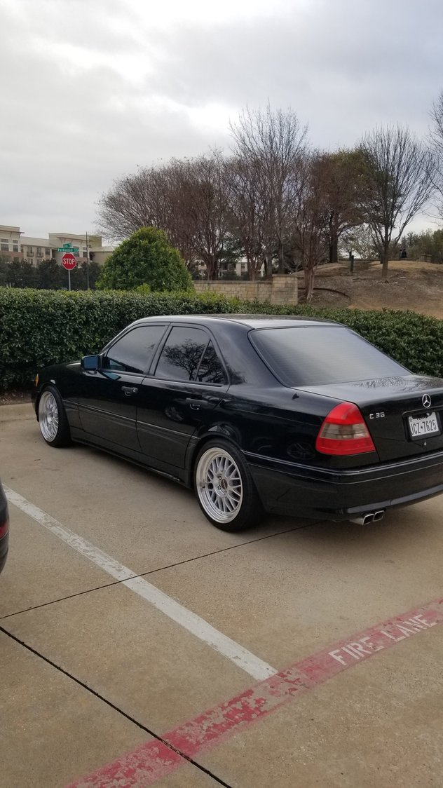

I am picking these up thia weekend if they fit, Am I correct that S class W220 are M14 bolts? Not worried about the offset I have hubcentric spacers at 10mm, 15mm, 20mm and 25mm. But will the M14 bolt be a problem?

I am pretty sure 45 to 46mm, she is unaware. Her husband passed and she said they were off a S430 I assume a W220.
I THINK I will be fine since our wheels mount to the hubs and bolts just secure it in place.
I know they are 66.6 on both, and my wheels now are 45mm and I run 20mm front 25mm back.

My friend has the same wheels on his c36.
Now these come in a few different offset configurations just like most mercedes wheels.
If your are like his, they will rub a tiny bit on the inside in the rear.
They rub where the wheel rim meets the inner wheel wheel. He got his to not rub by bending the material inside the wheel well.

Can I get thosr bolts in different lengths?
I will fit wheels but would like a litlle poke,
I plan on 215/40/18 front ( size on C36 now).
And 235/40/18 rear.

Let me know, I would like to run 15mm front 20mm rear, what bolt lengtj would I need to order from RAd
12mm bolt with 14mm seat?

(215) Fronts & (235) Rears may too short, with these W220 AMG Rims offsets,,
also, can't assure about the bolt length,
you have to put the spacer and try the bolt length that required,,
then you can order the proper bolt length..!

Those sizes are a little shorter then OEM, but I plan on a little "poke" and lowering on #1 pads all around. SO will need to stretch rear tire a bit
i have all the bolt lengths for 15mm 20mm and 25mm spacers, I think I am running 15mm on rears.
