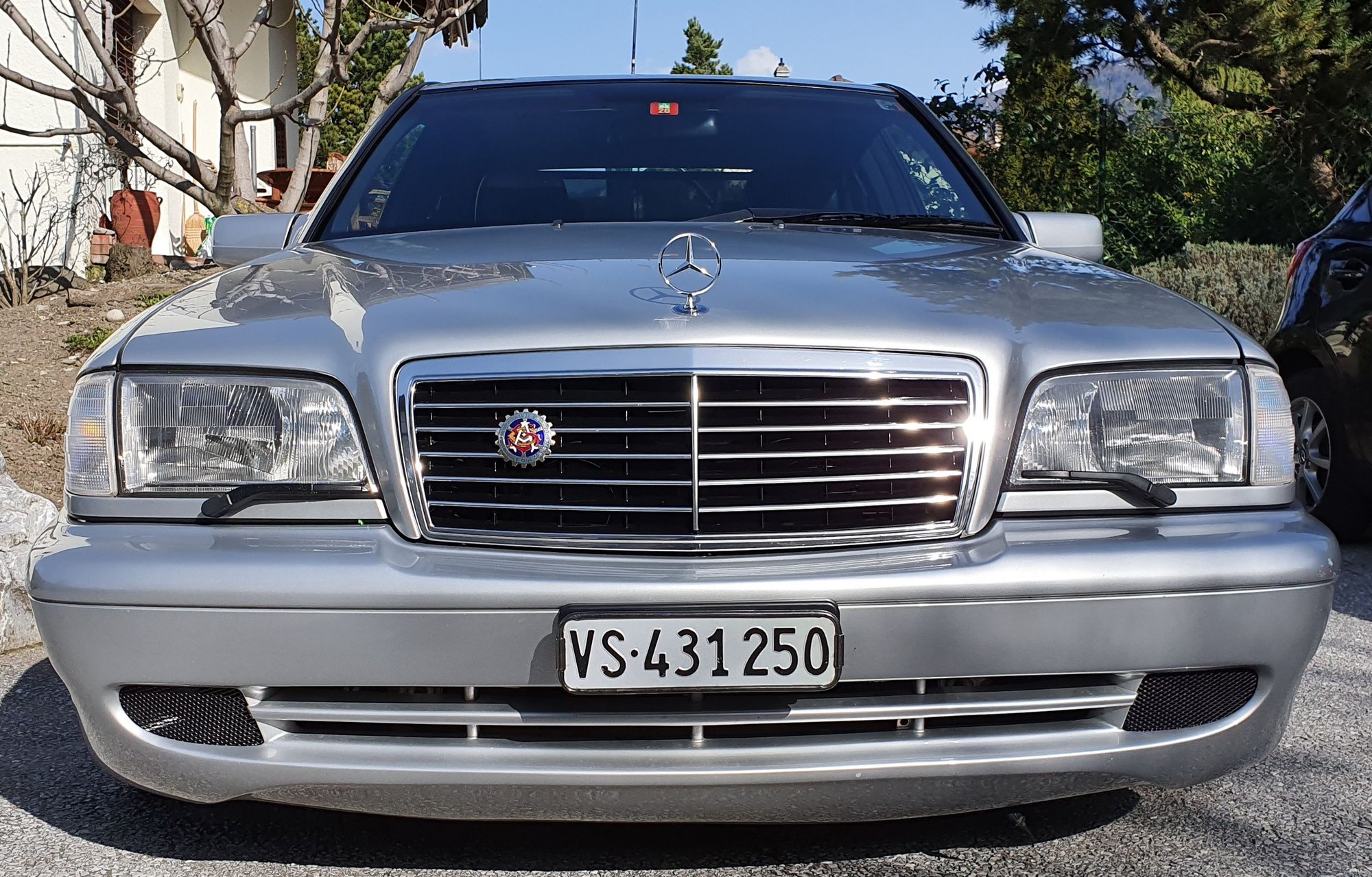

Took a full face shot of the front and grilles for you George Still haven't got round to picking up the refurbished 18" Monos with new Michelin shoes from my tyre shop. Don't even know if they are open or not. Will need to check next week before trying to go. I may get them treated to a ceramic protection if the price is reasonable. We will see. And before somebody says something, yes I also noticed the temperature sensor needs to be fixed back onto the bumber
Front face shot with grilles in place of the fog lights. As said b4, the lights had to be disconnected/removed to comply with road rules and regulations, as they sit too far down with the lowered suspension

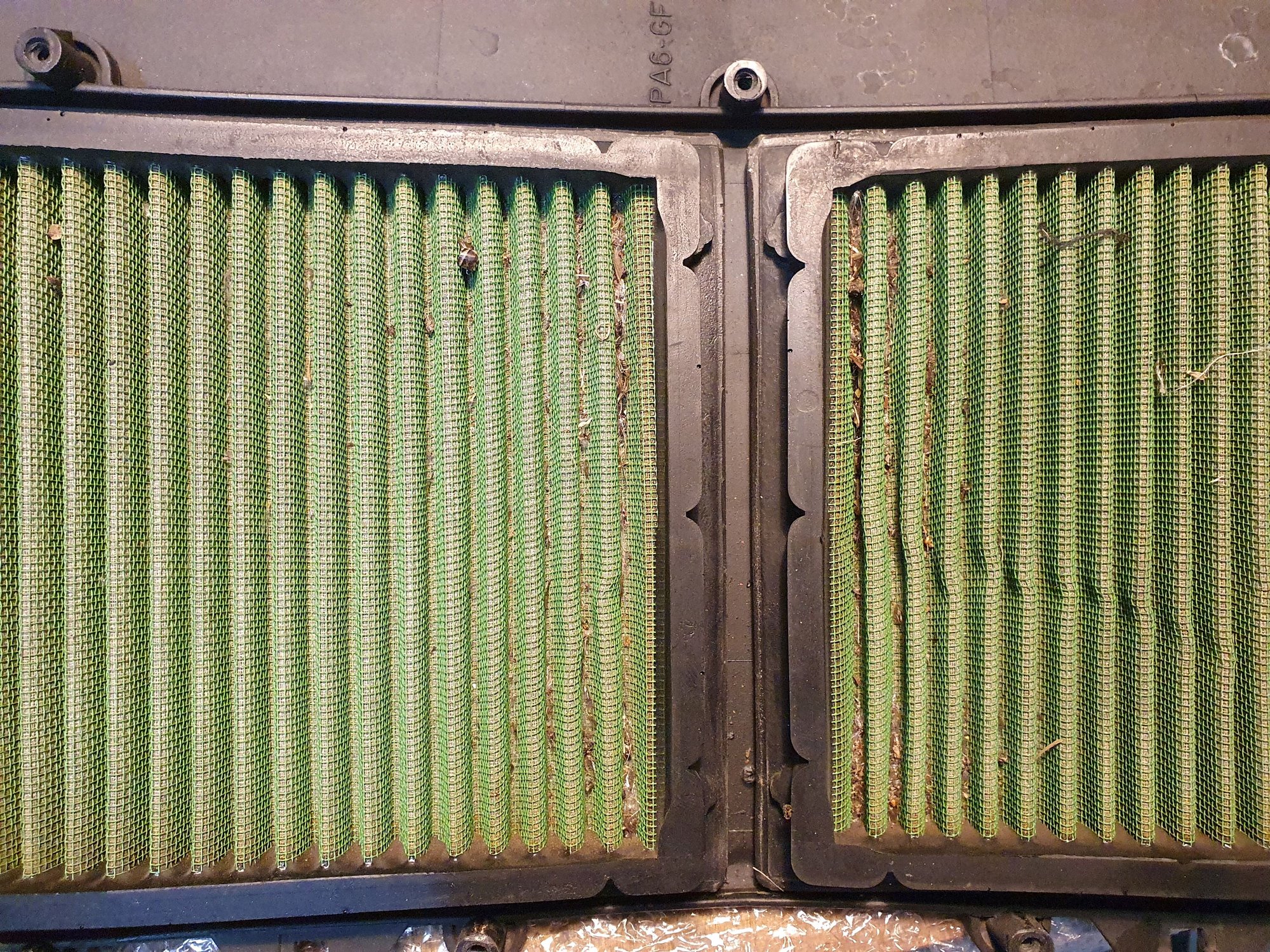

Removed the unit from the engine and split it apart. Took out the filters and using my workshop vacuum cleaner removed some of the old dried out bugs and other debris which had been sucked inside. As the "Green Filters" are reusable items, I placed them in a tub with warm soapy water and let them soak for a couple of hours, with the outside facing side lowest in the water so that the dirt and other debris would fall to the bottom of the tub. From time to time I swirled them around without turning them over. Then after a good rinse in hot water time for them to dry till tomorrow morning. Then I'll blow compressed air through the filters in the opposite direction of normal air flow. Then I'll apply a thin spray layer of filter oil over the surface, I have used this method for years and never had a problem with a polluted MAF by the oil or other things.

Green filters in need of some cleaning after a season's driving (without winter of course)
A bit of old bugs and other debris clinging to the underside. First clean with a vacuum cleaner

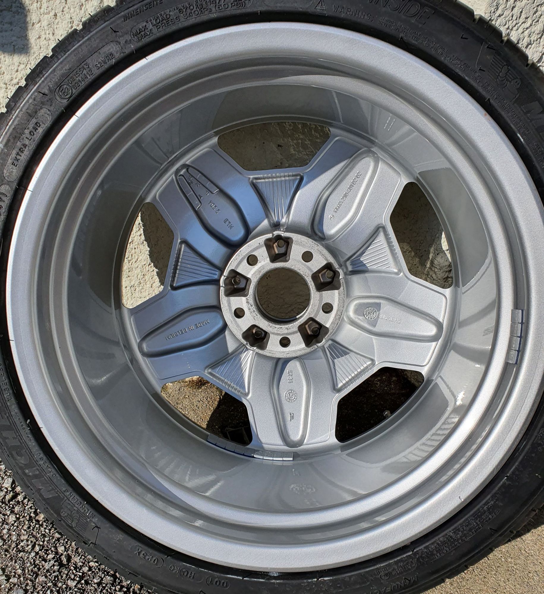

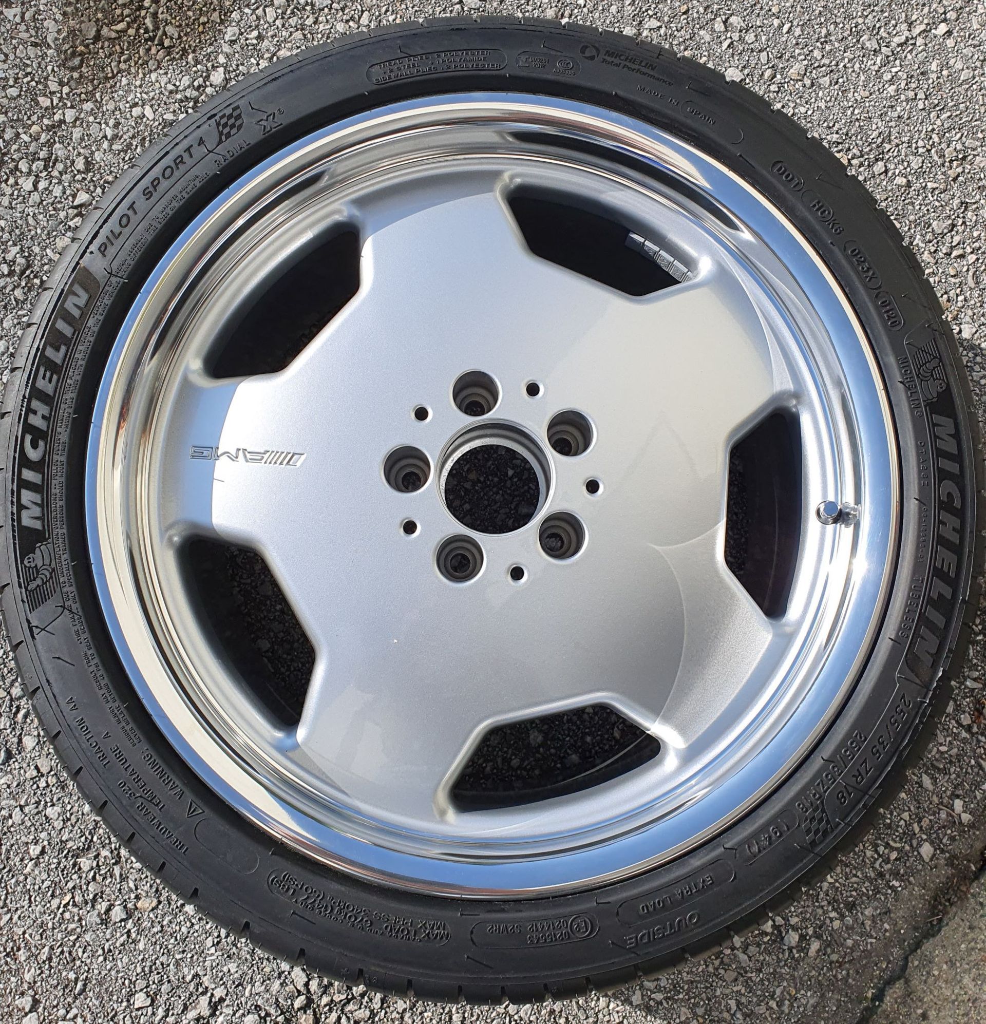

Picked up the wheels this afternoon. Here's a couple of photos of one of the rear wheels. I think they look just puuuurfect! What do you people think? I'll make some more after they are ceramic coated.
Front view of a refurbished rear 18" Mono
Just look at the polished lip and shorty valve stem
Michelin Pilot Sport 4. What else!
Even the inside of the wheels are like a mirror

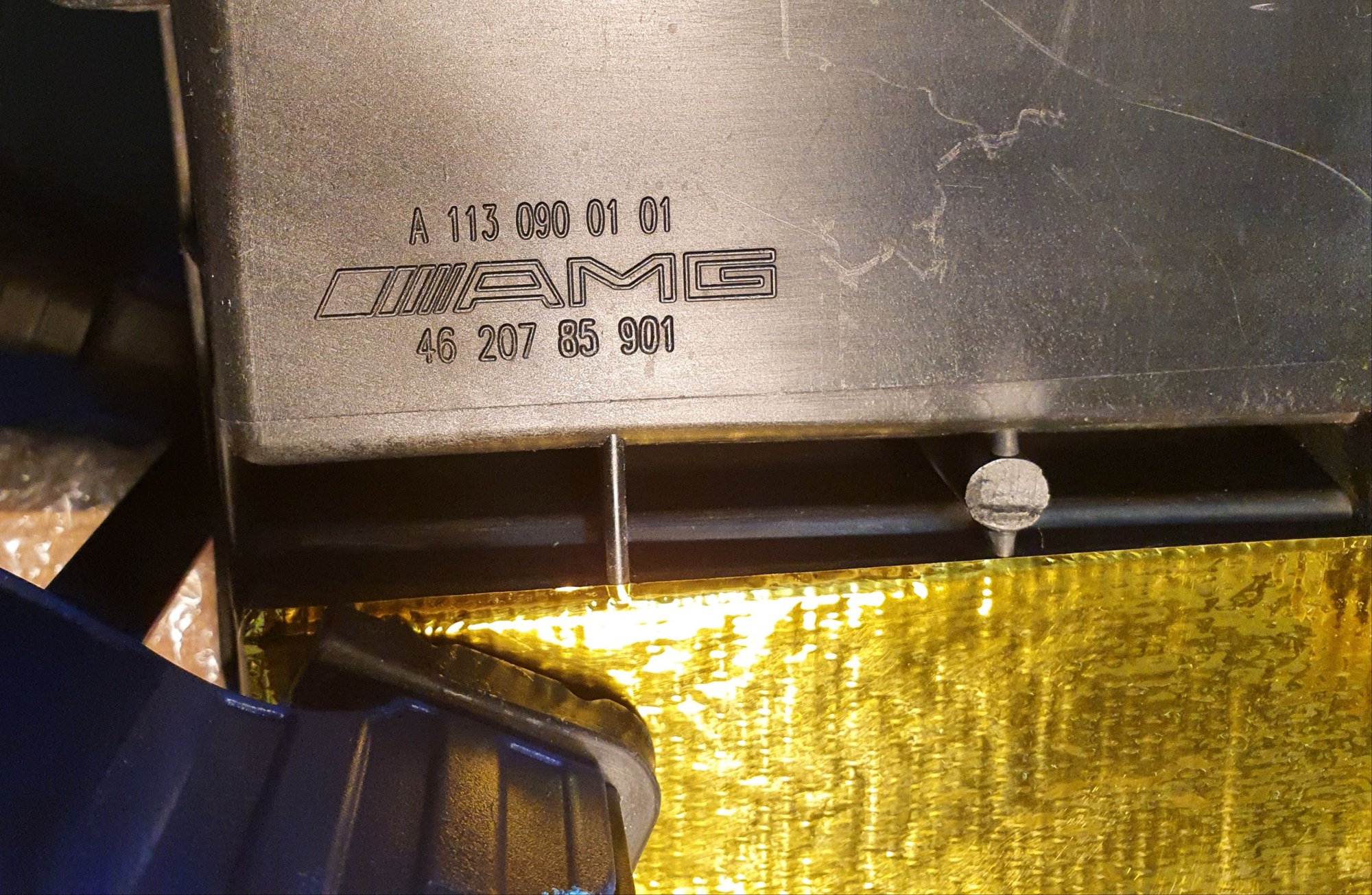

Finished today covering the underside of the air-box with DEI gold sheeting. As the part # has now been hidden under the sheeting, I made a photo so I can find it should it be needed later A113 090 01 01 then under the AMG name 46 207 85 901. Probably the latter is an internal AMG #

ID and part # of air-box for reference purposes before disappearing under the sheeting

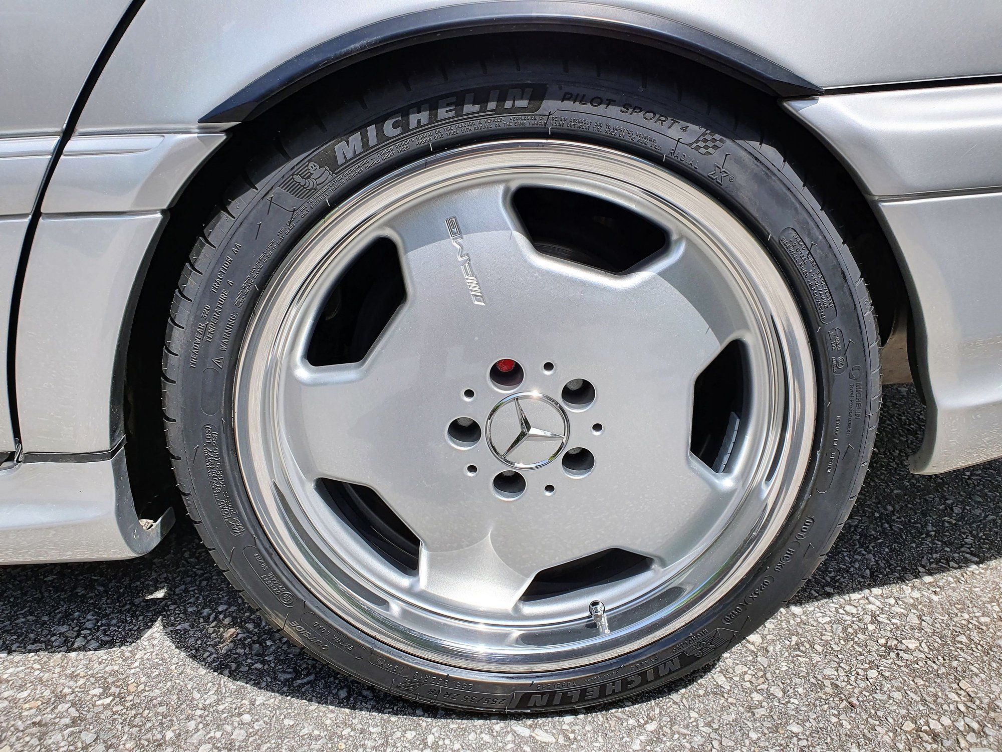

So finally swapped my 17" to 18" Monos this morning with a fresh set Michelin PS4 socks and took some pics. Enjoy

Front 18" Mono with Michelin PS4. Ceramic coated. Brake calliper painted back in 2012. Still looking great IMO
Rear 18" Mono with Michelin PS4. Ceramic coated
