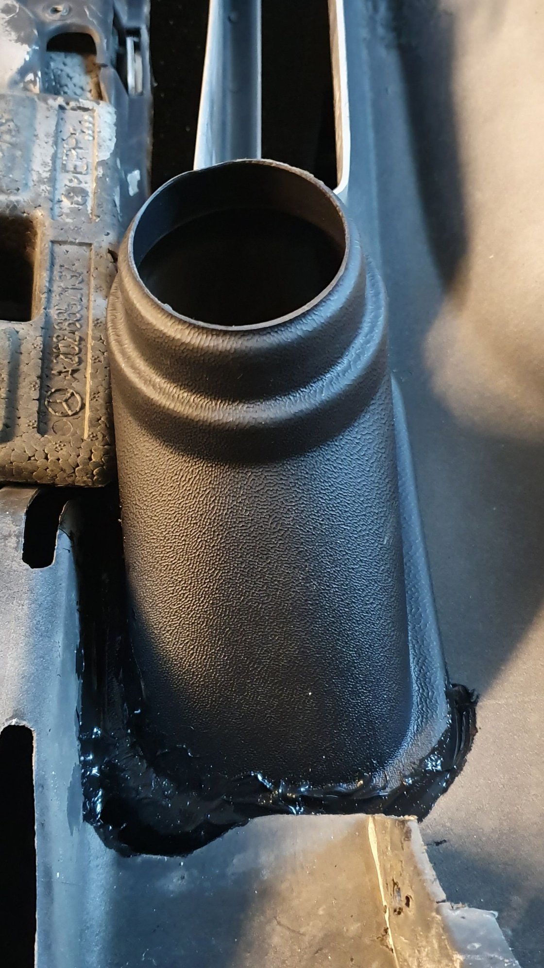

I had always wanted to install brake scoops to improve front brake cooling, as the pads have a tendency of "cooking" with hard use driving down mountain roads. I don't really want to drive off the mountain due to brake failure So installed some powder coated alloy grilles and lurking behind are some nifty scoops I ordered in a UK race shop. Next job will be attaching a flex hose to the scoop and threading it through the splash shield. Normally the hose should blow air behind the dust shield onto the rotors but I haven't figured out how without snagging the suspension parts. Need to get my thinking cap on over the next weeks
More updates as they materialize.
Alloy black powder coated grilles with the air scoops lurking behind...
Brake scoops bonded with Wurth black gunk. It really sticks when dry while remaining slightly flexible
Brake scoop from another angle
Silicone flex tubing with attaching alloy funnels which can be glued or riveted to a hard support

Oh BTW the "tooth brace" is now bonded to the bumber. No falling off ever!
Fog light covered with a grille. Behind is the brake air scoop
