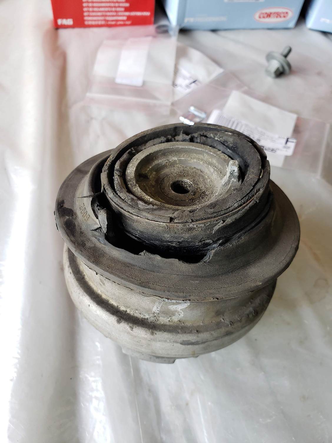

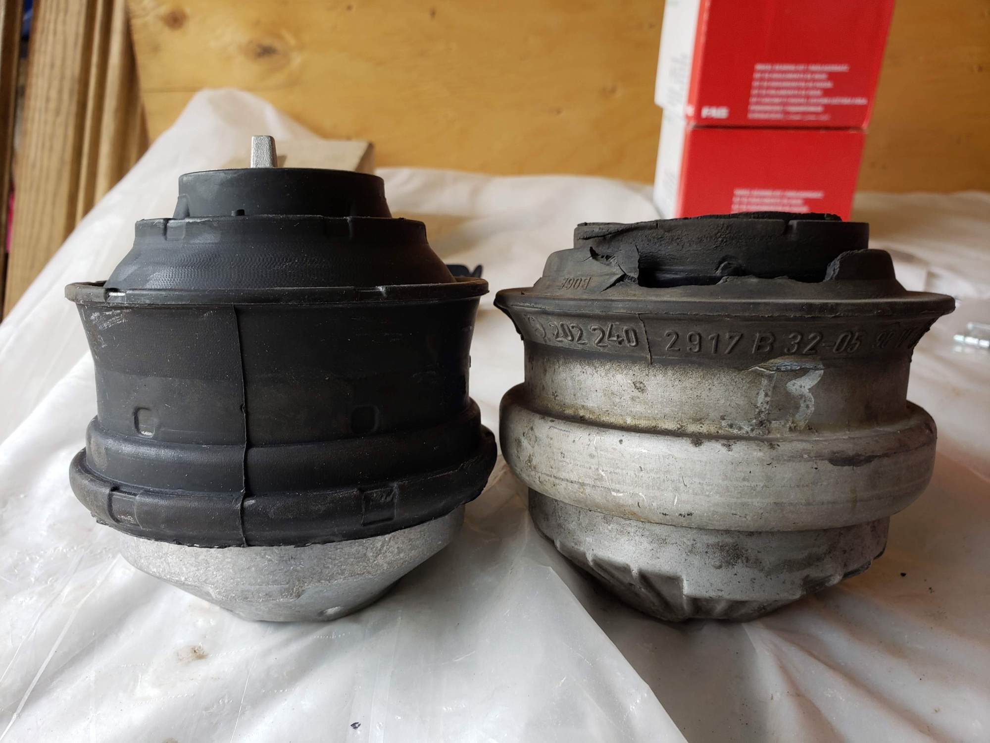

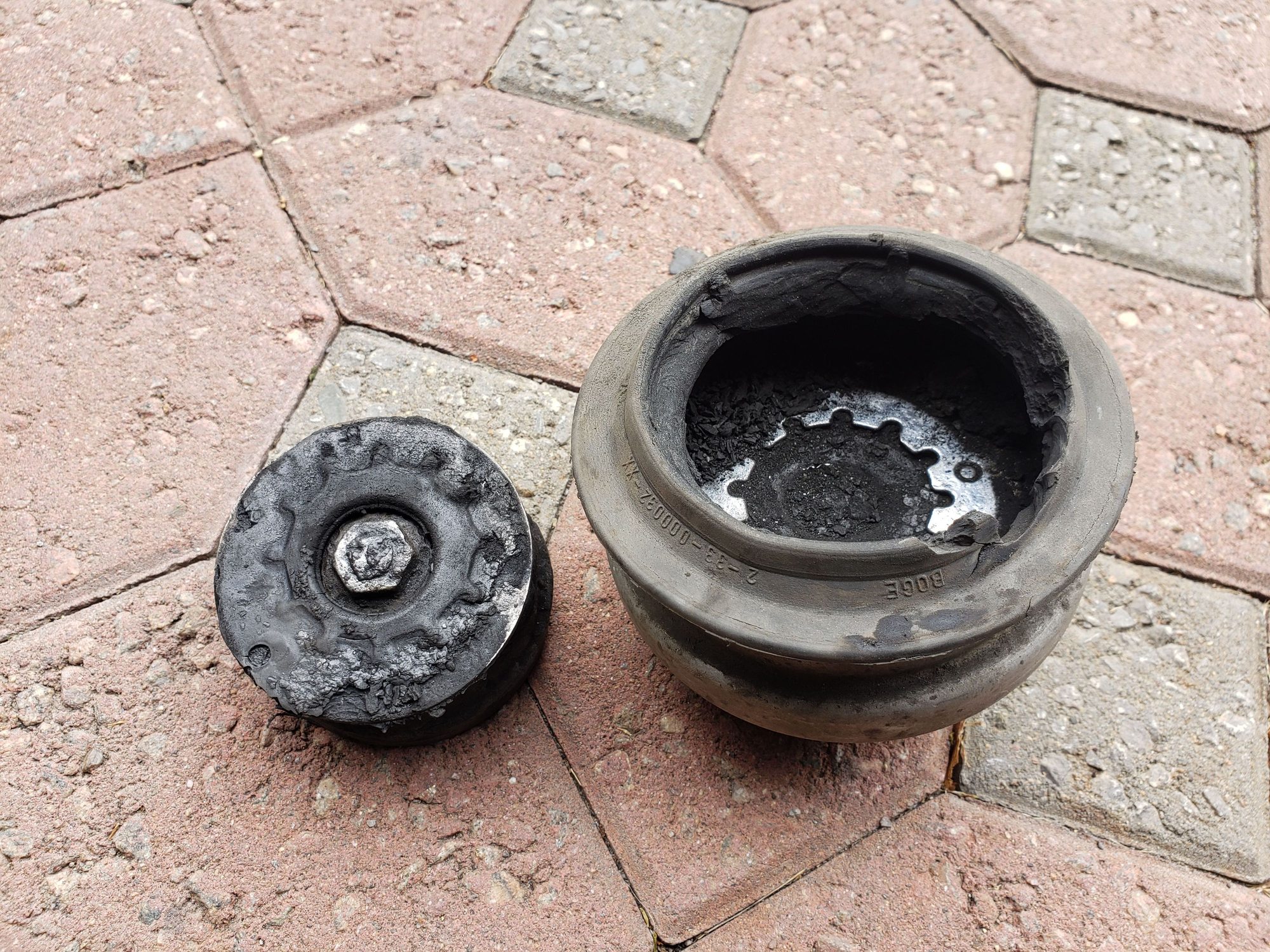

Well, my engine mounts were.. original. Like, 1998 with 161k miles original. And I'm pretty much sure that the driver's side being now a 2-piece mount isn't normal. I went with the M113K mounts.

Some photos say it all Good going BTW
