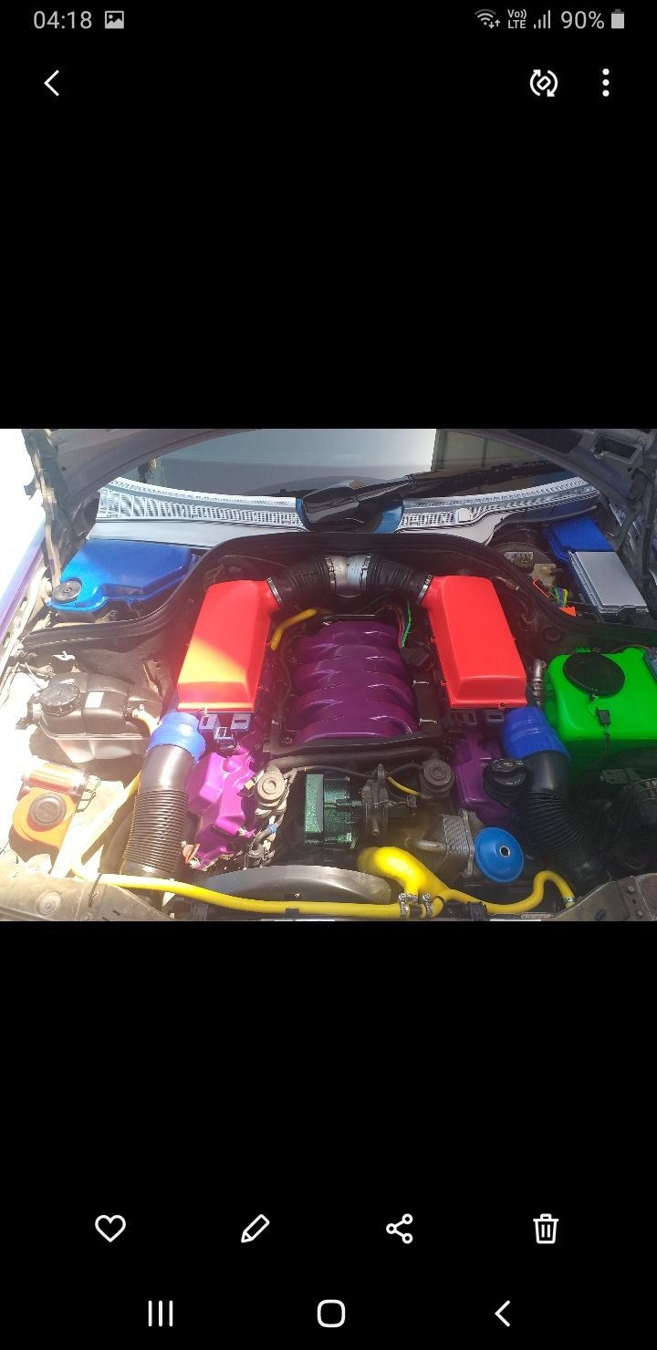

I've done many 5.4l, into C240's, including mine,
really worth every cents,,
just depends, if you will maintain it after swapping..

Wow Zayed, forgot that yours was a C240 at the beginning
