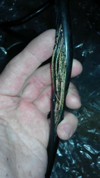

The suspicions were true, what do you recommend? Thank you very much, you are great people.
https://ibb.co/dLCRpn5
https://ibb.co/0XQQxm1

Glad to hear that you found the problem! I suppose you have 3 options to fix the throttle actuator:
  1. Fix it yourself by re-wrapping each wire with electrical tape or something better, as well as cleaning and re-soldering contacts. This is obviously the cheapest option, if you're handy.
  2. Send it out for rebuild. Costs $300 to $500 depending on the shop, however, this is not a guaranteed fix. BBA-Reman messed up my throttle actuator worse than when I sent it in. Took me months of calling them to finally get my money back.
  3. Buy a new one from Mercedes Benz. Obviously the most expensive option. I ended up doing this after the fiasco with BBA-Reman left me unable to fix the actuator myself. These things are not cheap if they are still available.
Another option might be to find a used actuator, but you will have to determine if the unit you're looking at is free of this defect. I think M104 engines built in mid-1996 and newer had good wiring, but I'm not absolutely sure.
Good Luck!

There was once a write-up on rewiring it yourself. Definitely cheapest. The trick is to make sure you re-use the connector, which requires care during the disassembly process.
Found it: M104_ETA_rewiring.pdf (w124performance.com)

4- buy a used one. The actuators are not that difficult to find on eBay. They are the same for all M104 engines. There is a part number for the ASR version and non ASR version. The key is to find the date code where it has been made after say 1998 which will not have the bad wiring. The date code is printed on the green/white sticker on the actuator. Nearly all eBay sellers are unaware of this and often times the date is faded and/or not shown.
