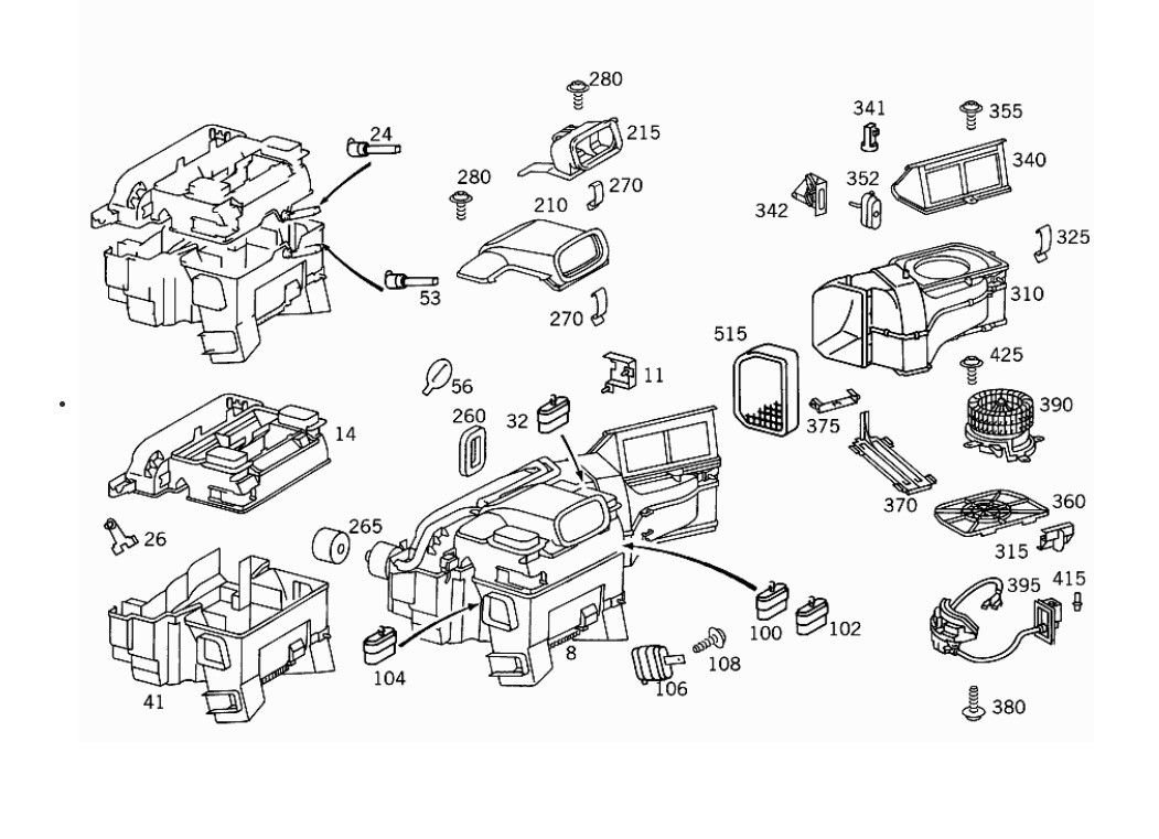

No dimensions but may help visualize -
Old Jul 26, 2022 | 10:59 AM
Hooblah's Avatar
Joined: Jun 2018
Posts: 132
Likes: 12
Merc
That's great, thanks.
It looks like it sucks air in through the engine bay? Would love to see an actual pic of one in the car.

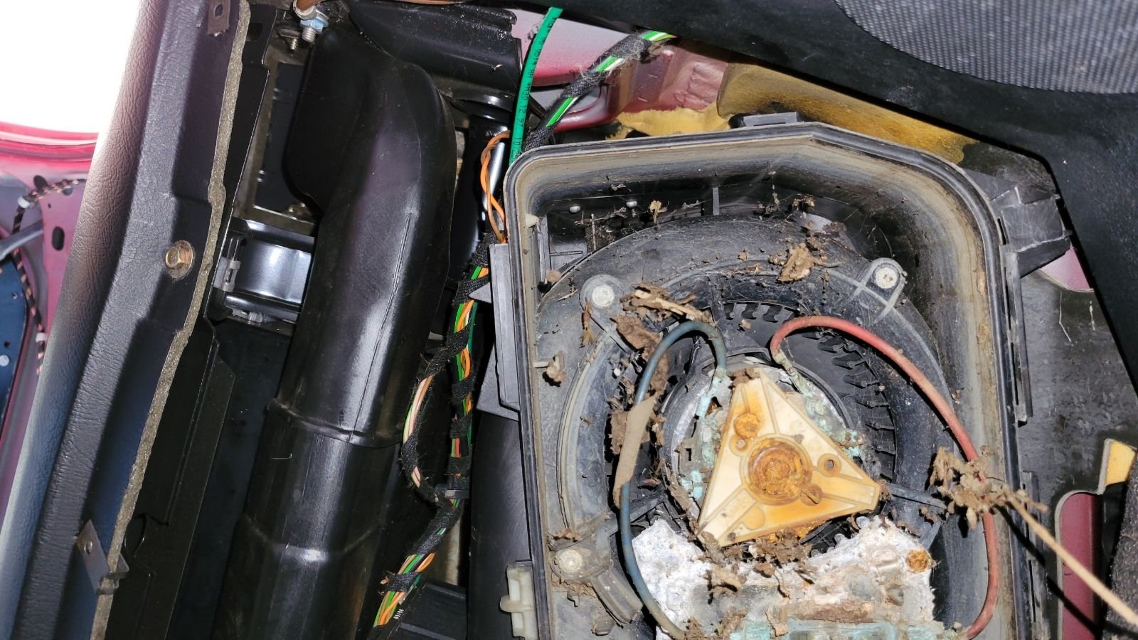

Its gonna be hard to get a decent pic because its in a odd location. Its sort of behing a glovebox and you remove it by taking off a panel thats above your feet in the passanger area.
Yes it does suck air in through the hood area above the ecu box. I had to remove mine because it siezed due to a water leak. I might have pics somewhere still

This is the best I have.

That's helpful, thanks. What I really should have asked for is pics of the dash out so I can see the whole lot and how it's installed.
It would most likely be easier to install the whole box with blower etc. The only issue is whether it would fit behind the 190e dash...

Yea as you can see its in its small little box behind the dash. Ill try to find a pic with the dash off for you.
Thats kind of a big job tho.
