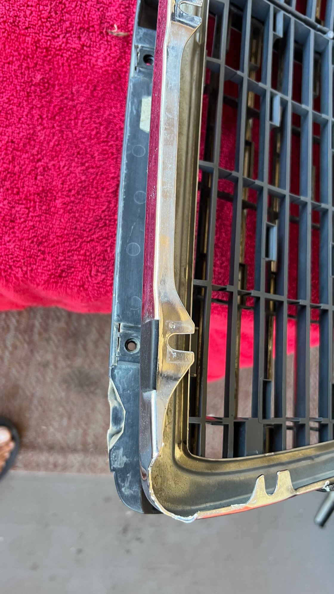

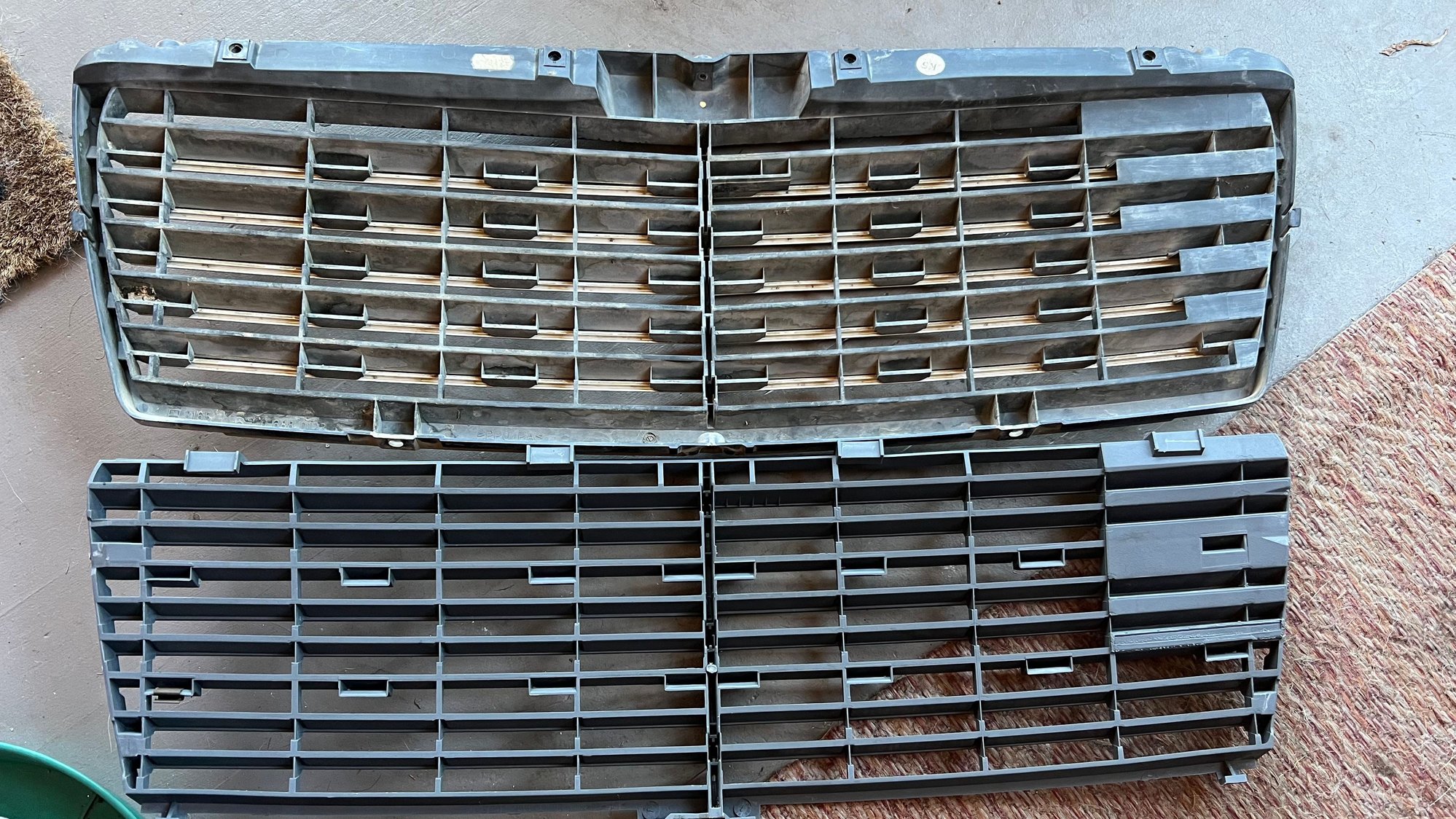

Can you show both grilles next to each other from the inner side
What do you mean? Like this?
I also looked at dudes video again and he says, “just so you know, this w210 grill has been modified to fit the w202”. What does that mean? Lol

Show the back side of both grilles side to side. The top grille is showing the front while the bottom is showing the back.
I feel like its an easy mod I just need to see the back sides of both grilles side by side.

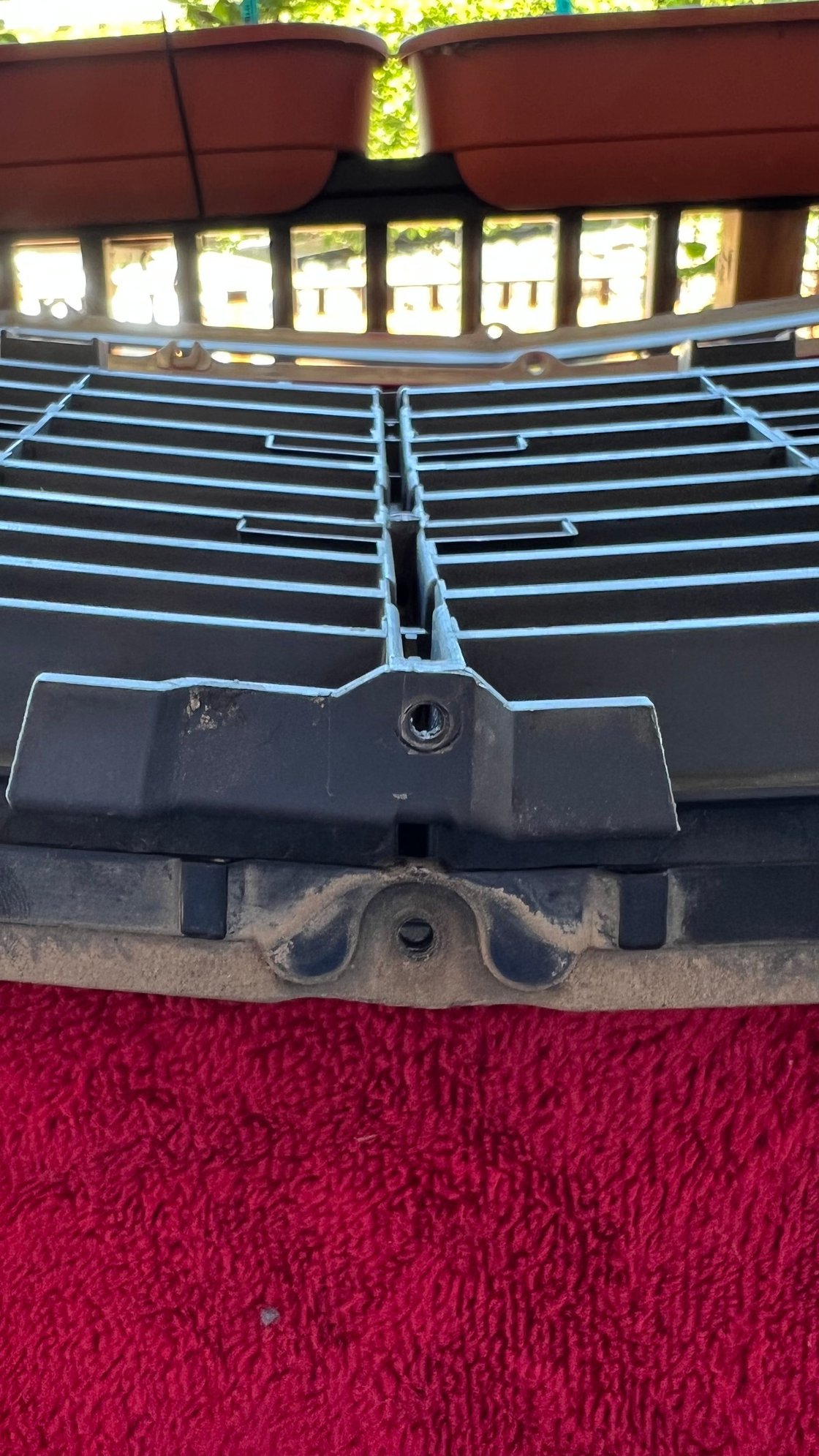

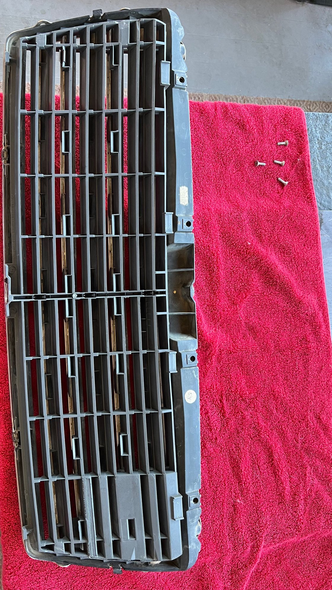

hows this?

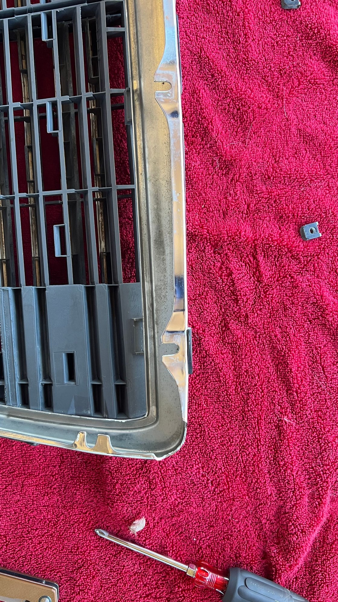

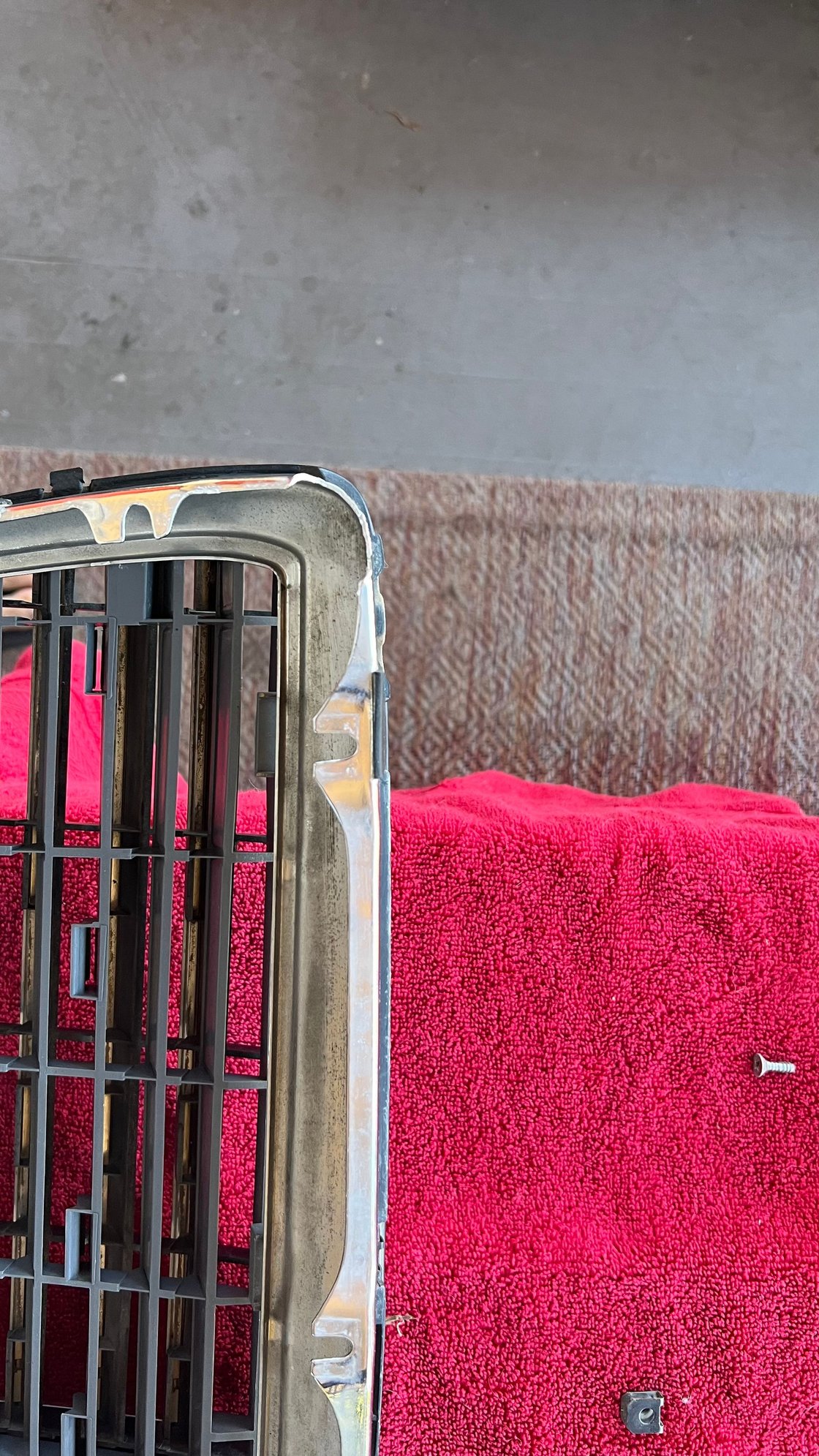

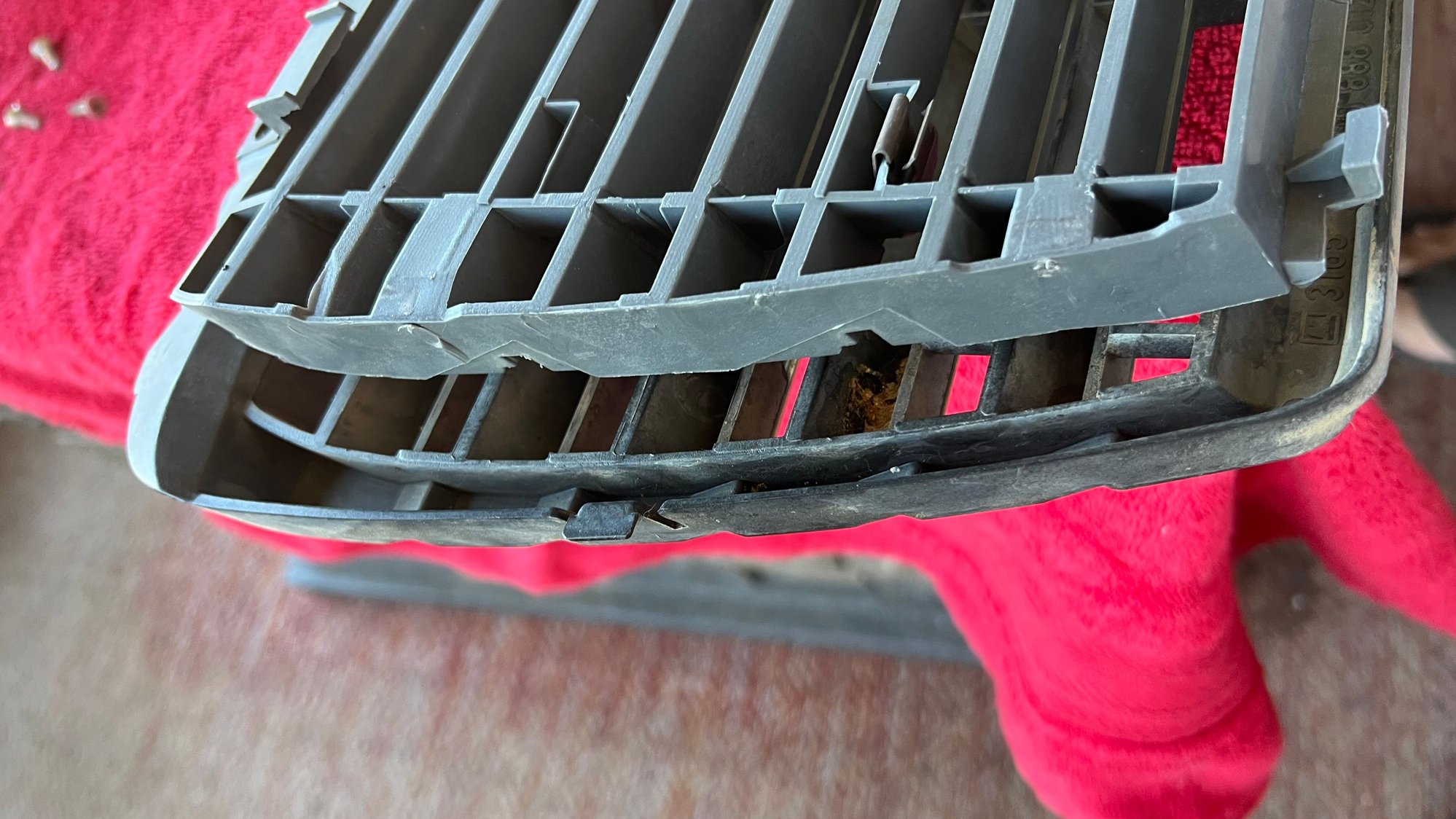

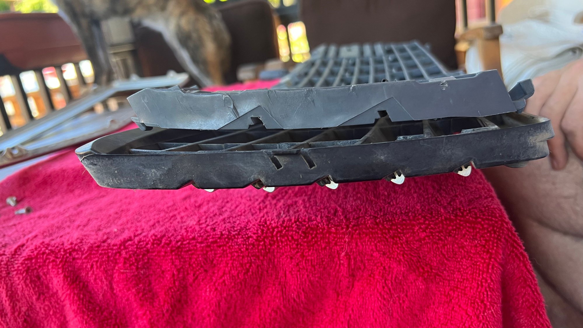

couple more angles. If I cut the sides how do the 4 clips go on the cutoff w210?
Old Aug 10, 2022 | 05:32 PM
PJmak's Avatar
Joined: Sep 2007
Posts: 4,566
Likes: 421

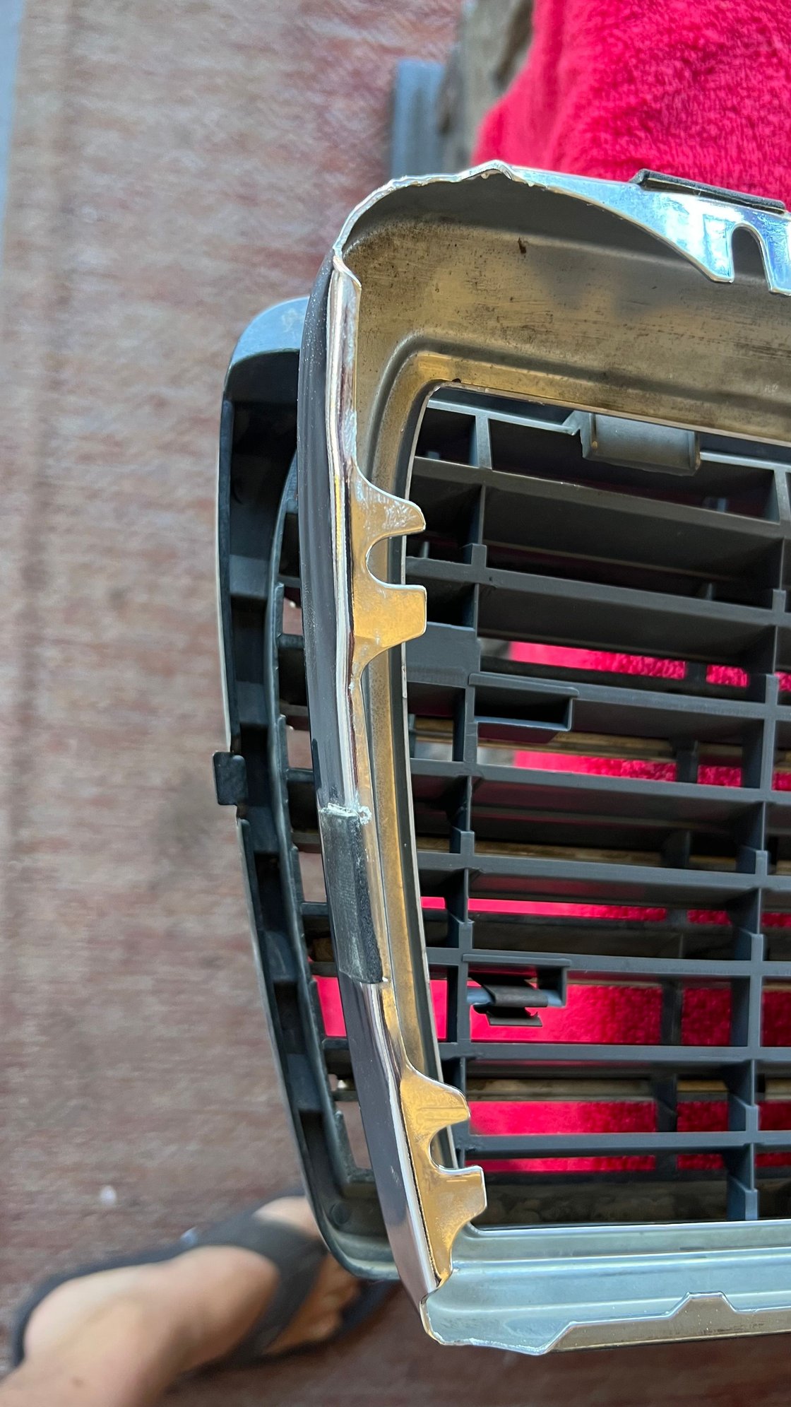

My guess is it would need to be cut like this.
Once you remove your factory insert from the frame you'll get an understanding of the fitment and you'll realize its not exactly perfect and there is wiggle room.
alright hope is being restored somewhat. I’ll cut the sides and top like you show. I think the bottom will be ok but I guess cutting less is better to see how it fits.

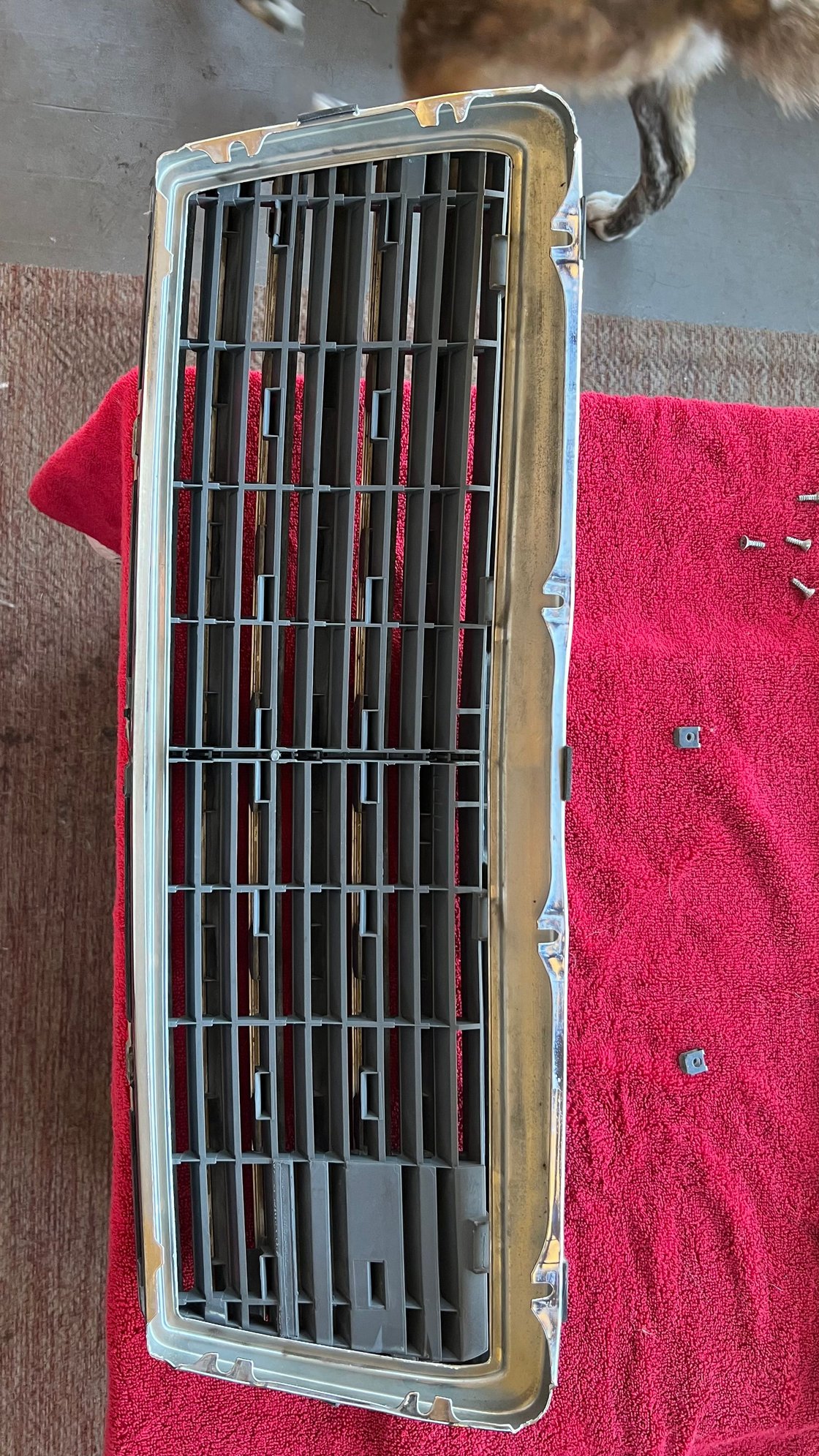

I put the w202 grill over the two inserts and feom what I can tell I might get by just cutting the sides. Just not sure on the drop in but will try that first.

So I just went for it and took my time with a cordless dremel. Came out great. Thanks @PJmak for the support!
