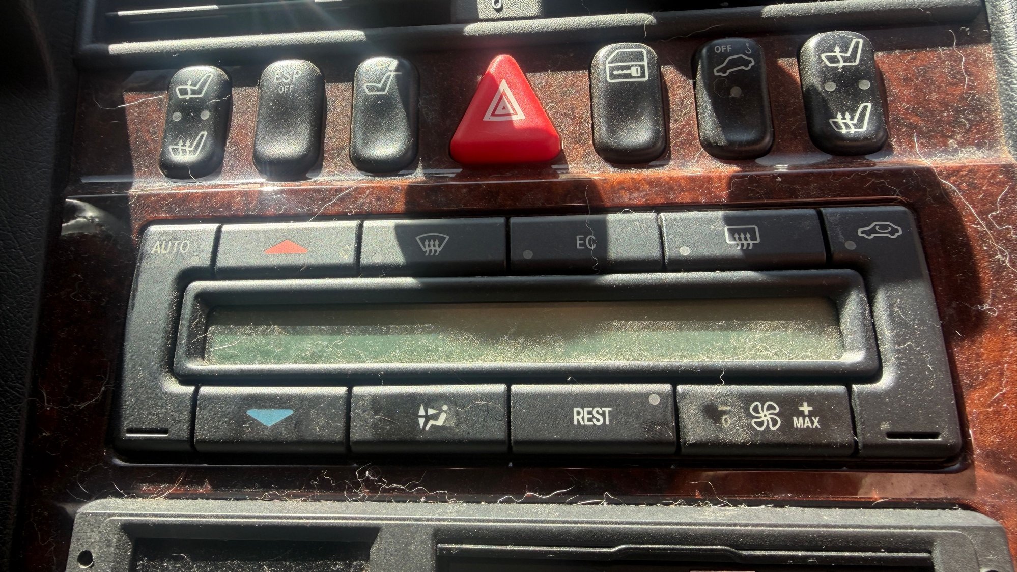

The climate control display I have is fading in and out so looking for a replacement. I see a bunch on eBay that look identical. It looks like this. Can I assume any unit that looks the same is compatbile? I can't find the keys atm but will order some to pull it but am curious.

Have you looked in the "Stickies" section? There was a long description somewhere on here by a member with a DIY who repaired the failing LED display. You can buy the removal keys at the dealer. If I recall at the time they were not expensive
Found the link to the DIY: https://mbworld.org/forums/c36-amg-c...trol-unit.html
If not the part # and diagram can be found here:
https://nemigaparts.com/cat_spares/e...33/44w/83/150/
