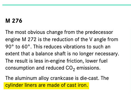

Why was it overhauled? And what do you mean by overhauled? A complete rebuild? I have 130,000 MILES on my 2014 C350 M276 NA and it runs fine. My 2015 SL400 M276 bi-turbo has 52,000 miles and runs well, too.
While the crankcase (block) of the M276 is made of an aluminum allow, the cylinders have cast-iron linings.
Old Nov 5, 2024 | 09:20 AM

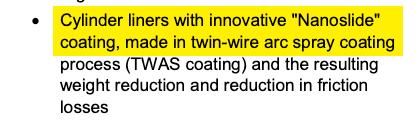

[QUOTE=EZZK;9060302]
Originally Posted by JettaRed
The overhaul means grinding bore to eliminate wearing and deform inside cylinder, replace piston and piston rings, gaskets, grinding cylinder top and cylinder head surface for better airtight, replace main bearings and conrod bearings, check valve lift clearance, grinding valve seats...etc, many items on the list.
So there are iron cylinder sleeves inside M276?
Damn! You really did do an overhaul. Just wanted to make sure we were talking the same thing. Were you having engine problems at 81,000 miles? Was the motor oil ever changed?
The non-turbo M276 has cast iron liners and the turbocharged M276 has Nanoslide cylinder liner.

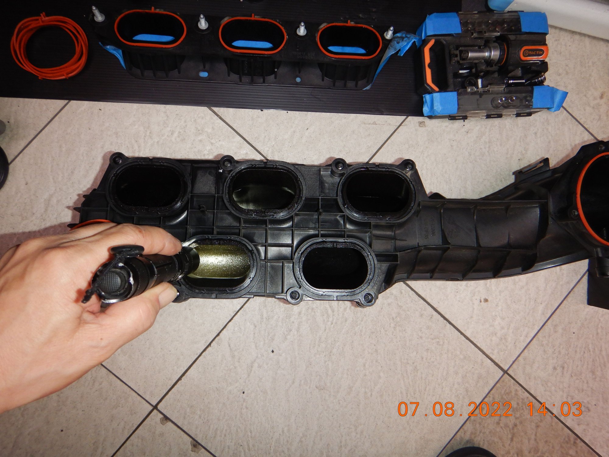

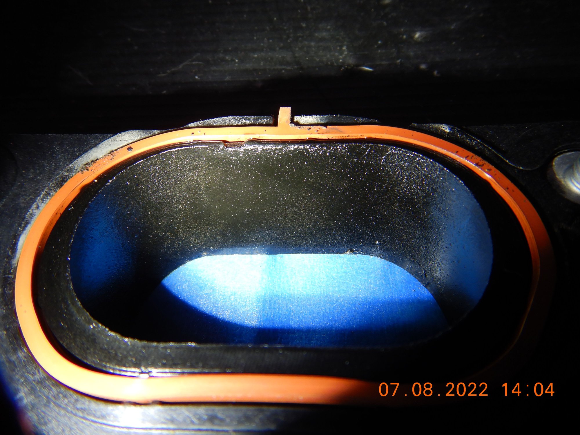

M276.8xx 3.0 Turbo has very good PCV system, double stage the one in the middle of the V-bank is the 2nd stage, much better than M276.9 3.5NA.
But there will be carbon build up at intake valve, albeit very little. We GDI-er do not escape the side effect of carbon build up.
Our air intake track is dry from oil trace, that is true.
Here is a bit over 20,000 miles or 33,000KM ish.there about.
Intake tract is very dry
This is not liquid oil, its a thin film oil trace
Watch the video, the carbon build up on a C43
https://mbworld.org/forums/e-class-w...omparison.html
This is the 2nd stage PCV. The long one on the right. The round one on the left is the basic centrifuge

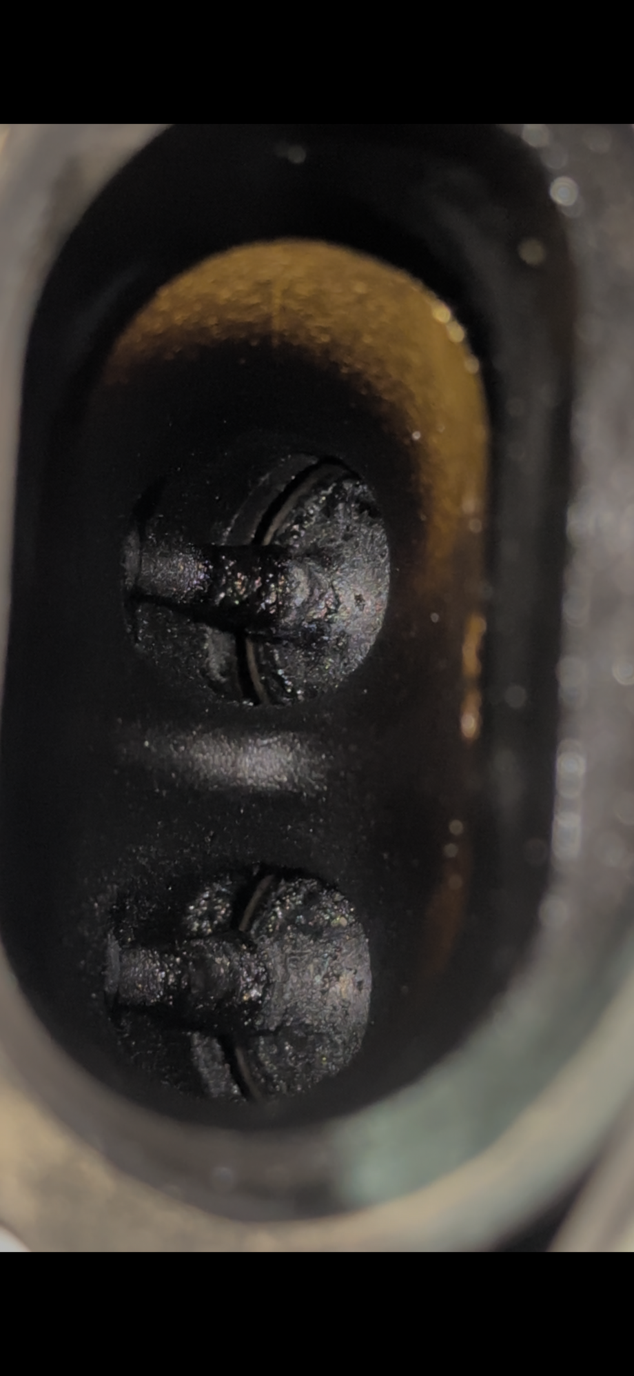

i've changed that 7k km ago as preventive suggested from Cali but i regret i did not changed the other part that clips into this PCV..
and here is my carbon build up car is 131k km and its driven only with 100RON fuel (shell v power)

That is not bad at all for a 131,000KM engine , I mean the carbon build up is very little for that mileage.

Originally Posted by KristiyanPetrov
I suggest you to go to someone with Star diagnostic or go to dealer and ask for latest TCU firmware update if you want to get rid off from the jerkyness, i got that jerky too and dealer installed latest update and that gone but i kind of miss that... haha
https://cimg5.ibsrv.net/gimg/www.mbw...cbd772f174.png
https://cimg7.ibsrv.net/gimg/www.mbw...45ac1760b5.png
That is pretty clean! The constant Italian tuneup must have helped greatly!
