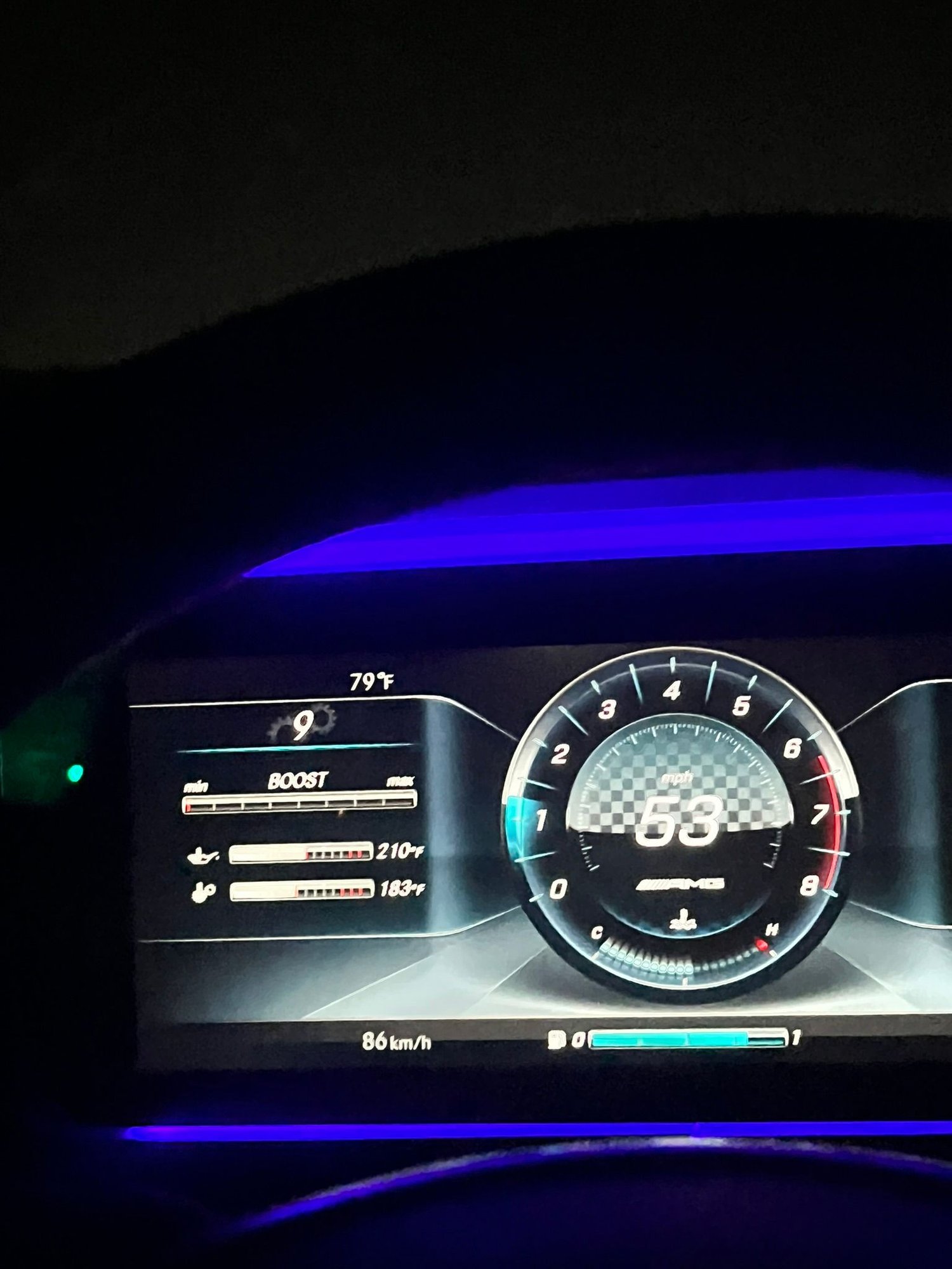

Oh wow... could it be a cost savings measure on MB's end to not include an oil temperature sensor? Hey, it's one less thing to fail right.
Regardless of how the number is calculated, I still take perhaps a bit too seriously?
But y'all... 206F seems a little too hot for just driving around a neighborhood no?
I did a very short pull (shifted at 4.5k RPM in comfort...) up to 55mph on maybe a 17% incline road... and my oil temp registered 210F for a minute before cooling down to 200F.
Am I just overthinking this or is it not quite a bit too hot? Or is it perfectly acceptable for an M276tt?
If it is... I don't even know where to start looking for the issue. Perhaps trying a different oil first?
I guess I'm not used to having a German car with no crippling issues hence a wandering mind

Originally Posted by sidnotgod
YOU COULDN'T HAVE BEEN MORE RIGHT. All of my transmission issues were resolved with a firmware update. It's awesome.
Separately, what is the correct operational oil temperature range for the m276tt? I was on my limiter (130mph) for a good 10 seconds or so and I looked down... my oil temp was almost 233F????? Not even on my M156 have I seen oil temps that high. My average daily drive in comfort through hot ambient temps is around 200F. It seems to have gotten hotter after my oil change with Molygen.
And if I did the oil solenoid mod... my oil temps would go even higher? That seems just awful to me even though I really want to do it.
Im glad i was able to help you with get rid of from the jerkyness..
What improvements you see apart from jerkyness? do you update just the TCU or ECU as well?
After Oil pump solenoid disconnected, i do have around 103C (engine oil) as normal temp when driving normal and before was between 90-100C and when i decide to push it harder it goes to 110-115C
You see higher temps because oil is constantly circulating and taking the heat (so isn't from your oil) but as MS mentioned the temps are not actual taken from sensors instead calculated based on formula, so not sure when we see 105C engine temps what is the actual temp..
As suggestion for the oil, please look for upgrade with 5w40 SP specification (im using Motul Power which is Ester and absorb the heat better than usual oils and doesn't get burned too quick), i guess your current Molygen one is API-SN? you can find more info about that in the oil pump solenoid thread in short SP specification is better for our engines
