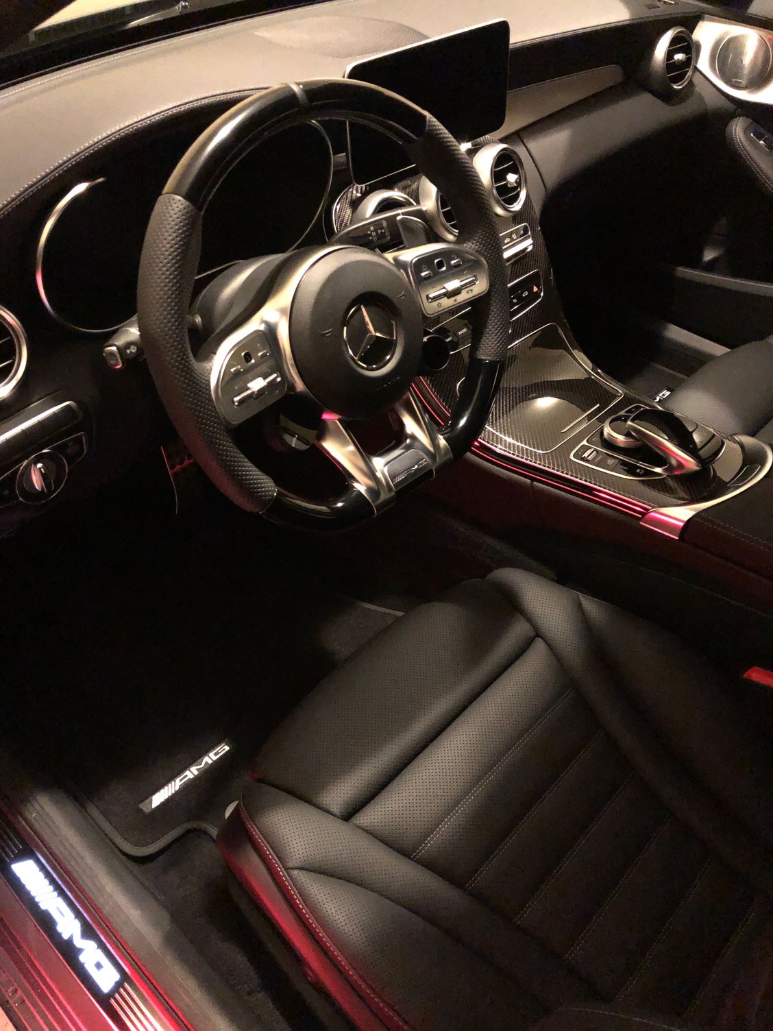

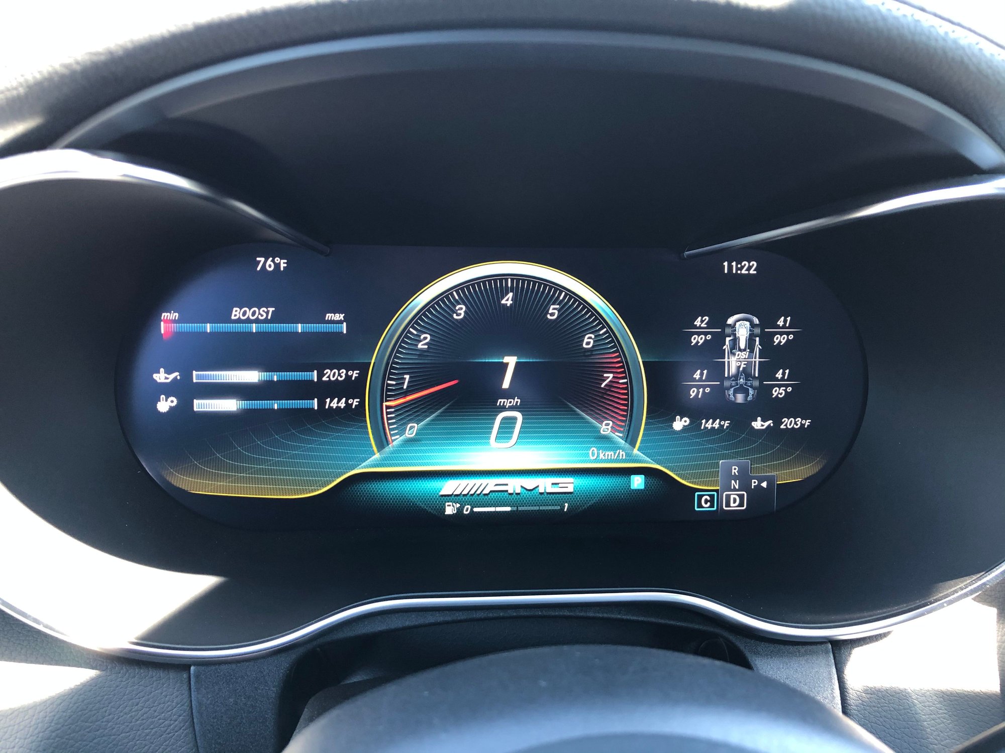

As to the FL C43, I really like the new gauge cluster displays and the steering wheel with the AMG Drive Control Unit. To be able to see my tire temperatures/pressures paired with my oil and transmission temperatures on one side of the gauges, with HP/TQ/Boost on the other, is a dream come true. I’ve wanted that kind of dedicated configurability for years.
Also, being able to control my drive settings and PE on the steering wheel is so much more convenient than I thought it’d be.
Also like the steering wheel. It just feels a bit more like the wheel in my old W204 C63 from a thickness perspective. Paddle shifters are noticeably larger, too.
As to things I don’t like I forgot to mention, I don’t like the way the transmission behaves in the FL. Particularly in M. Ripping through 1st to 2nd in the PFL was awesome. In the FL, nothing happens in first lol. I mean, I feel like I really have to beat the **** out of the FL to get it in the power band as far as HP is concerned.
On the plus side, I’ve never once had any of the jerking or wild bucking bronco behavior in the FL. It feels much more polished in that respect.
All together, it really comes down to personal preference. In almost every category, the PFL and FL have their distinct advantages/disadvantages. Except, IMO, when it comes to features and interior design. The FL wins comfortably there.

Ah yes, I noticed the addition of the tire temperature on the facelift during my test drive, it wasn't there before on pfl, you just helped confirm it for me. I do wonder how it works though and if anyway it can be retrofitted on to the pfl.

[4] I didn't aggressively downshift via paddles but, since my individual setting uses sport mode, I would sometimes upshift to knock the RPM/gear down. Note that the car does rev-matching down-shifting when slowing down, so there is some of that going on.
[5] I didn't worry about any temps the standard instrumentation didn't show me. I have faith that, if you follow a reasonable break-in strategy, the car is well-enough designed that I don't need to worry about "those other" temps.
