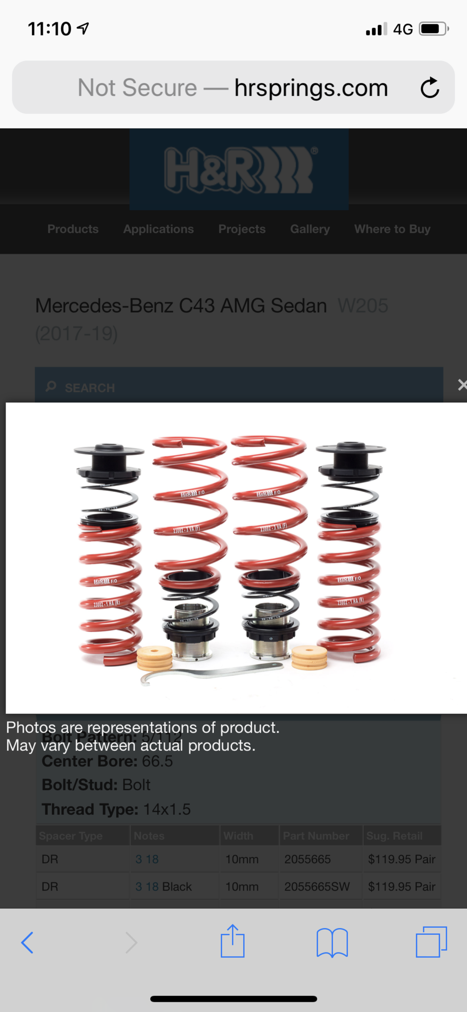

Old Jul 23, 2019 | 02:40 PM
  #35
TModelle's Avatar
Joined: Jun 2019
Posts: 1,013
Likes: 194
C190
Originally Posted by Sethseb
I thought so. Thanks for your help. I'm going to instal my VTF on Monday with SFG Autohaus. If you don't mind, how much did you lower yours?
Could you take a pic of the VTF spring set so that we can have a photo reference for the future. When I get my KW HAS set, I will post a photo here. That way, in the future, anyone can compare the two offerings before buying.
In my search for adjustable springs for the C43, most of the websites selling VTF and HAS only show stock photos of their product and not the actual C43 kits.
So I think it would be great to actually be able to see them.
I’m getting my HAS kit in about a months time, because Germany is out of stock at the moment and they have to be produced.

I didn't get a chance to take a picture of my VTF but here's a picture I had before that I downloaded from one of the suppliers.
The ride is the same compared to the stock springs. So far, I love it. I will be putting my 20 inch rims in the next 2 weeks and might have to adjust the height.
Very often rather than not, the pictures on retailers website are just stock photos. Sometimes they even state that the photo may not be of the model that your purchasing. Are you certain that’s what your set looks like?
Yes
Someone earlier mentioned that there is no helper spring in the front, while your picture shows that there are 4 helper springs. I think that’s just a stock photo and might not be the same.
I do not think my set had those small black springs.

Actually I need to verify if my setup has helper springs or not. The absence of helper springs will explain my problems:
https://raceland.com/news/springs-10...er-spring.html
@Sethseb Can you pm me your phone number, We can verify this together then. Should have gone with the HAS. Damn it.
thus why i asked. helper springs are great for full droop situations. But they can also be "built" in with a more condensed coil section.
i'm not sure if VTF is supposed to have them or not - or if they have them built in to the primary spring.
I am confirming this in a bit. Just got off the phone with my distributor. They told me there is supposed to be 4 helper spring that is supposed to come with the setup. May be they missed it for mine? Or I do have them, but I cannot see where they are for the life of me.
