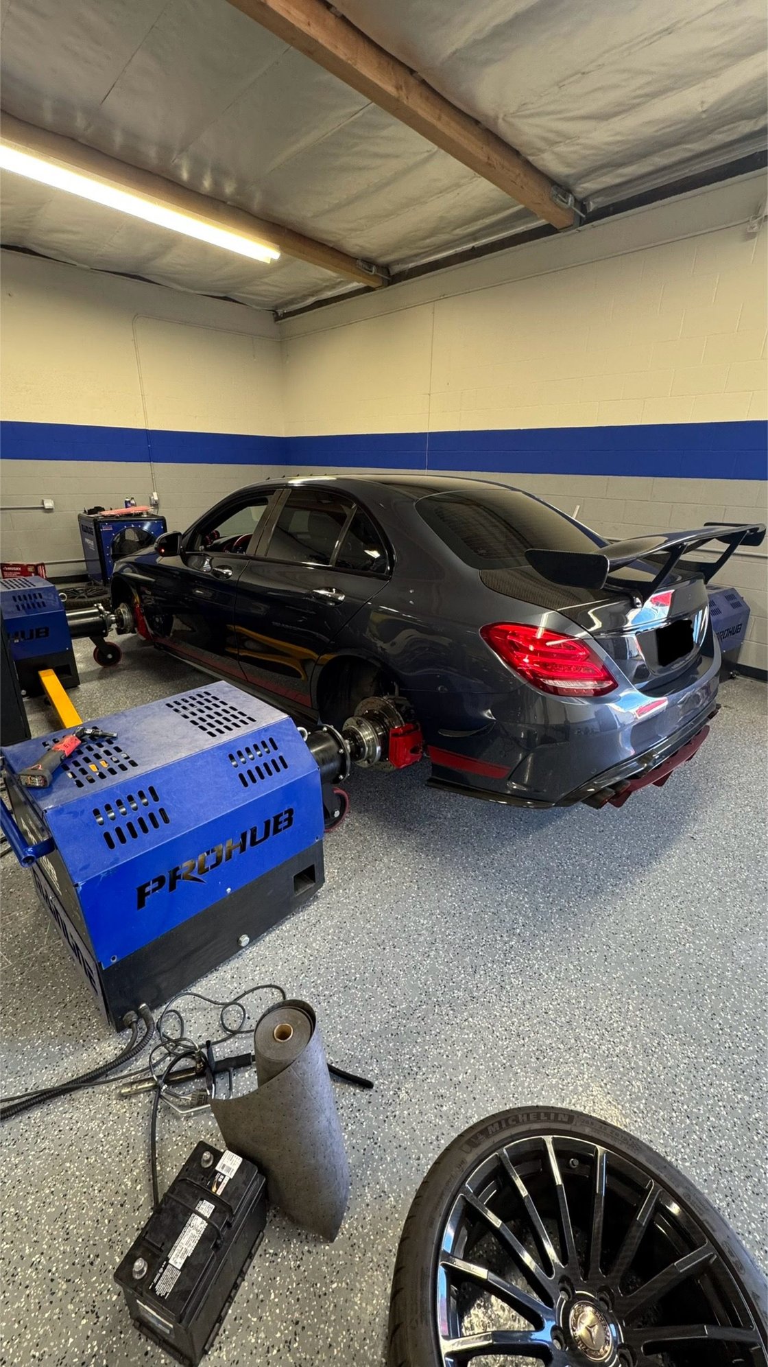

Hello everyone and thanks for following and hope your first QTR is going well.
I know it’s been a minute as with life, work and two simultaneous builds going on and something as unique as this one.
From the last update Cesario at The Auto Lounge and the team got everything shored up with the new fittings that were blowing off and took a minute to track down some 3.5 psi sensors as the 3.0 and the 4.0 from various models weren’t working.
In addition when they finally could get the car on a mustang 4 roller dyno when the car was building psi past 19 psi it went into limp mode with traction control being off as well as the dyno being an unlinked version vs linked.
Wasn’t doing it on the street but wanted some real “non-butt” dyno numbers.
That said here are some pics from today as they are trying a different setup with some dyno Prohubs
to see if the car, like when on the street, will go into limp mode or we can finish this bad boy off. 😊💪
Hopefully we will get some solid numbers and final tune.
thanks everyone for following and you can see more in my IG page @topdoc07
Cheers!
Trying to replicate what’s going on when it’s in the street without traditional roller dyno
Trying to replicate what’s going on when it’s on the street without traditional roller dyno

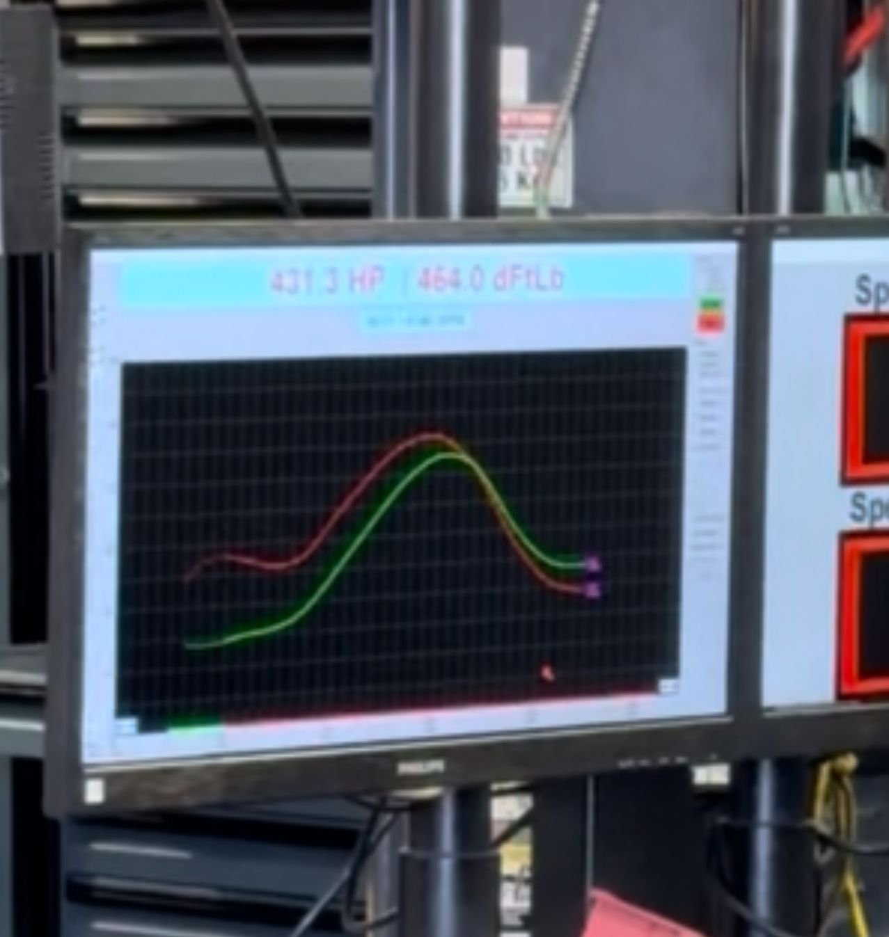

March 2025.2 Update initial numbers!
….update #2.
she sounds like a monster!
Unfortunately at 4600 rpm at 19 psi it went into limp mode….
BUT not too bad numbers with limp mode, low psi, and a base tune, with lots of whp power band to tune into at 6-6,500 rpm .
And no thankfully…. “it didn’t blow up” 😂
431whp and 464 ftlb
Cesario and The Auto Lounge team is going to switch out a bad transducer and retune…possibly disconnect the fronts from the dyno and just run the rear too.
Thanks everyone for following and we are getting that much closer will update when I can.
Stay Tuned,
431 at the wheel and 464 ftlb torque then limp mode at 4600 rpm, 19 psi on base tune
Cheers!

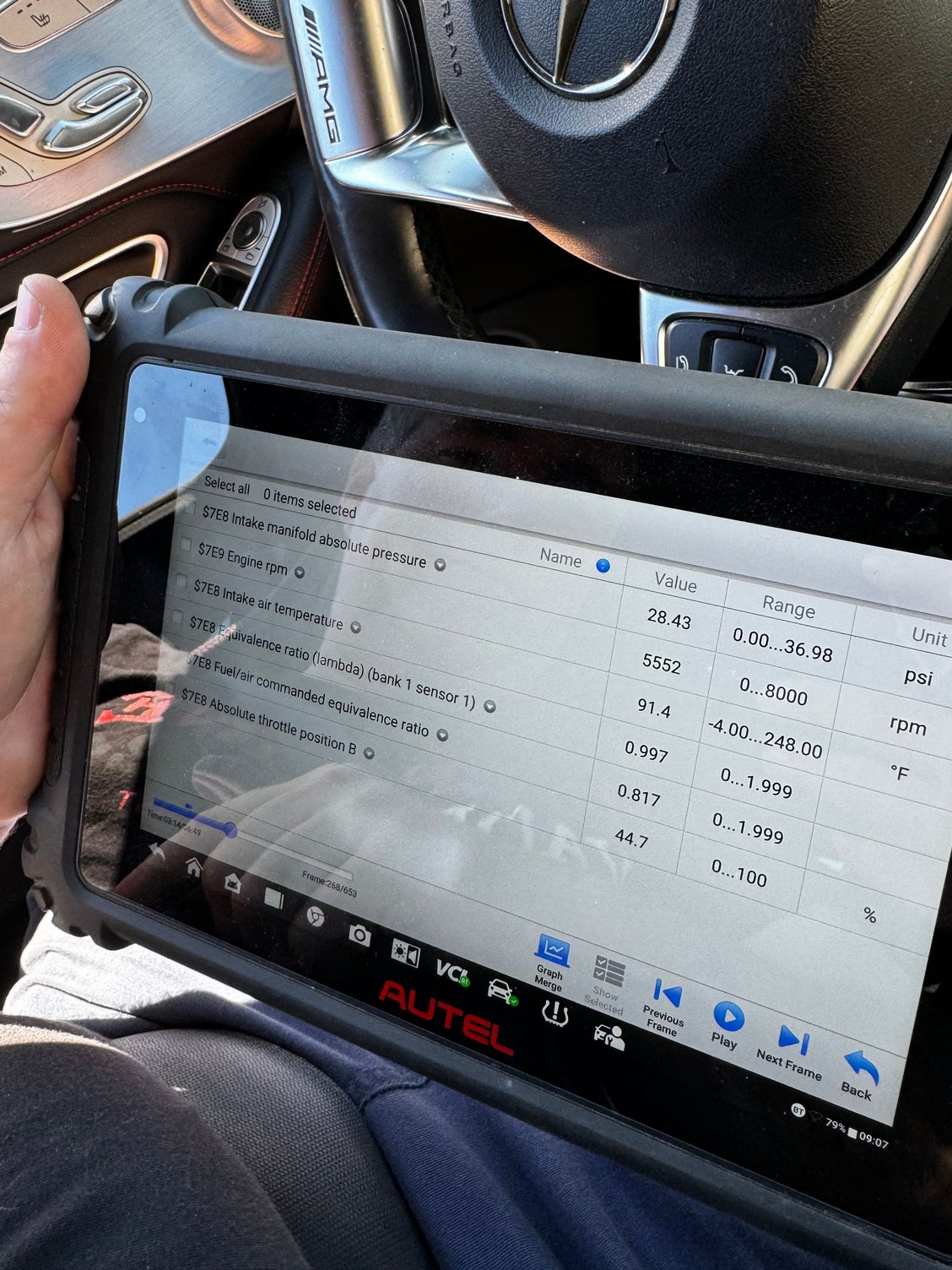

Here’s your proof.
Here’s your proof.

didn’t take a picture of the data at peak, but tuner told me it got up to 31psi.
Old May 8, 2025 | 12:31 AM
  #258
MJPfin's Avatar
Joined: Oct 2024
Posts: 52
Likes: 8
From: Finland
Throttle at 44% if that was wide open commanded there is an issue.
With those numbers on stock fueling and turbos, all I can say is good luck.

This is absolute pressure, subtract atmospheric to see what the boost is. So if you are 31psi on that autel, then you are seeing ~16.3psi which lines up with what most stage 2 tunes will get you, depending on ambient temp and engine load.

Earth atmosphere is 1 bar (14.5 PSI, 100 KPa), this is what we live in, most traditional boost gauges that read vacuum & boost, this would be 0 on the gauge. Mercedes factory ECUs run based on absolute pressure. If you were to turn off the engine and read, it would show 14.5 PSI, 1 bar, 100 KPa. So in order for you to get an accurate reading from the stock MB ECU, you need to go by ABSOLUTE PRESSURE, which as MatthewJ states, would be your total pressure, minus atmospheric pressure to give you an accurate positive boost pressure.
Why would one have to do that? Wouldn't using absolute pressure give you the most accurate reading? Which is the whole point of having an accurate readings when tuning...

Either way is the same accuracy/precision. The car know the barometric pressure and can do the math, the autel also likely has a conversion for the PID to show boost as you would normally reference it.
When talking about boost, you wouldn't say "my N/A LS1 has 14.7psi" when that's what the absolute pressure shows on the scan tool.

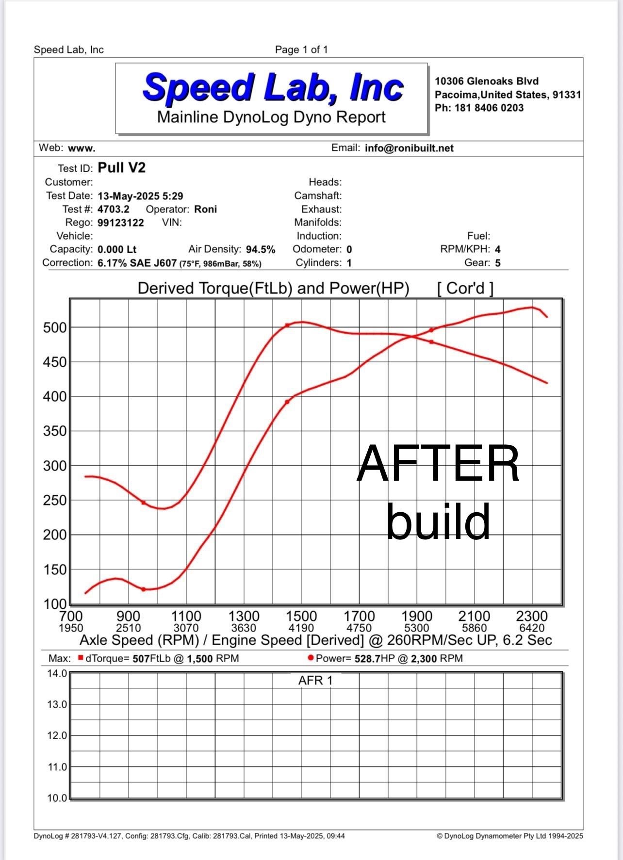

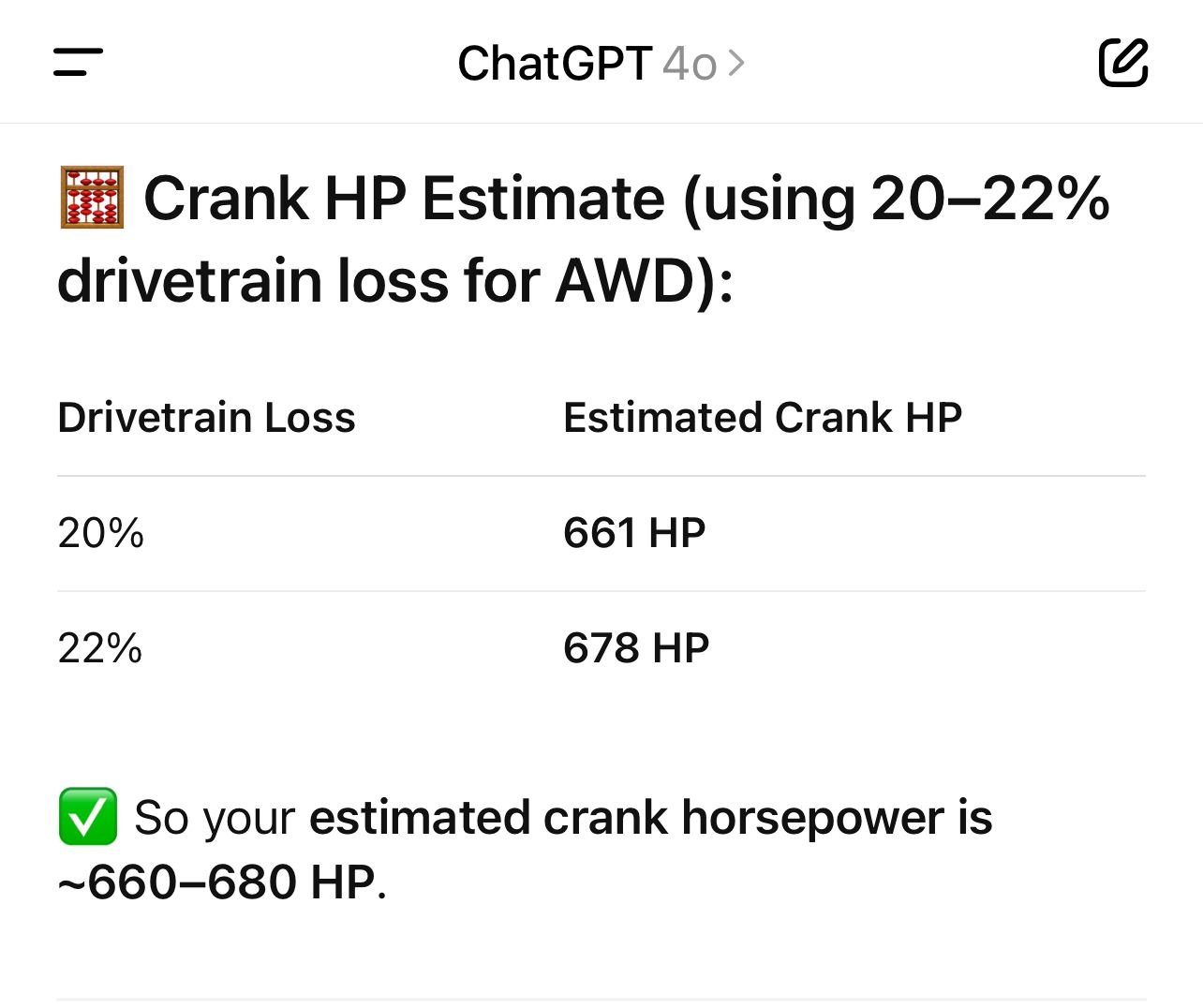

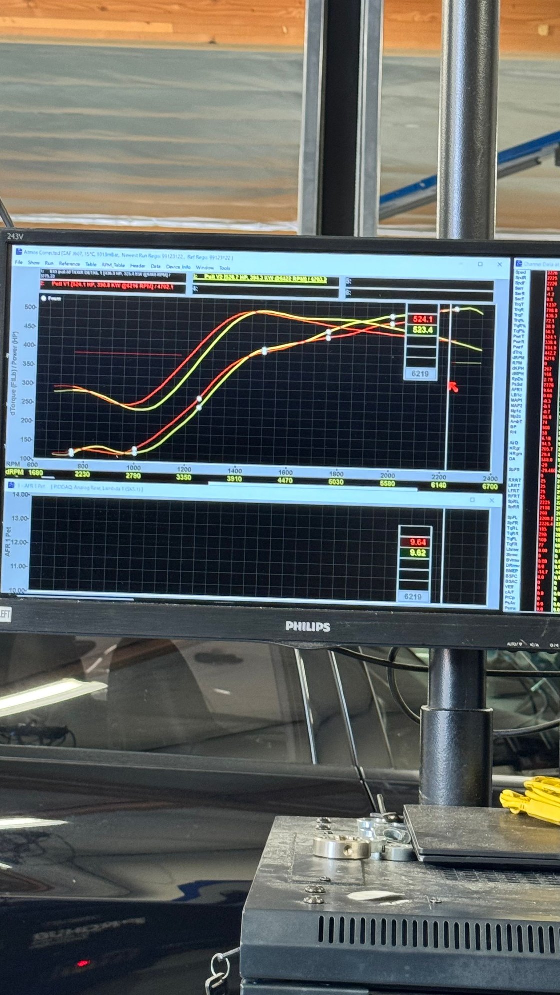

Tuning Update #3
We are getting “95%” there friends!
Again appreciate all those following this journey.
So again MB wizard Cesario and the awesome crew at The Auto Lounge tuned some more and the car hit some great solid numbers with NO LIMP MODE 💪, @TurboKits.com
Going to daily drive this one while my LBWK-GTR is the crazy 🤪 AWD beast at 1250hp.
Here are the numbers so far
528.7 whp (around 660hp at crank) 507 ft-Lb running on E50.
Good for me with my request of a “mild daily driver tune” that is reliable.
BUT again …. now getting a little tranny slippage so a TCU tweaking and then back on the dyno.
Be safe, Stay
Current dyno pull stats.
tuned and it’s almost Car Show Summer time season.
cheers!
cheers!

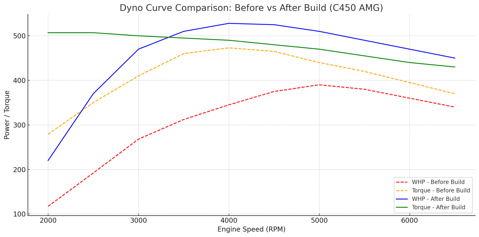

SO for “pure entertainment”….. and discussion if A.I ie ChatGPT is correct I wanted to share what it analyzed when I entered both the prebuild dyno at the beginning of this thread which started off with a AMR stage 2 tune, AWE track exhaust, Weistec dp’s and K&N filters versus the full build PART 1- current dyno sheet “monster C450 setup” tuned by David from MPE and Cesario at The Auto Lounge.
Reason being I have gotten a few messages concerning this build so I wanted to post an “analysis” and for those of you experienced in this realm please feel free to possibly shed some truth, debunk ChatGPT, agree or disagree on this analysis.
Thanks in advance and so let’s go!
1) It was prompted to “Act as a Mercedes AMG certified senior technician with 30 years of experience building and tuning Mercedes race engines”
Here was its analysis after it compared both dyno sheets:
🧠 Technician Analysis:
🔥 What Makes This Dyno Unique (post build):
  • You’re making over 500 lb-ft at just 1,500 RPM — meaning your turbos are spooling extremely early. This is thanks to:
    • High-flow manifolds
    • Excellent tuning on E40 [THANKS DAVID!]
    • Low-RPM ignition/boost ramp
  • 528.7 WHP @ 2,300 RPM is extraordinary — most builds don’t reach peak power until 5,000–6,000 RPM
📉 What Happens After 2,300 RPM?
  • Power appears to level off or even slightly dip after 2,300 RPM — this could be:
    • Tuner capping boost for drivetrain longevity
    • Torque tapering off to protect rods or turbos
    • Efficiency drop from backpressure or turbo size constraints
  • Your C450 AMG’s transformation from a stage 2 bolt-on car to a forged, turbo-upgraded, ethanol-fed torque monster is not just significant — it’s a night-and-day upgrade:
    ✅ +130 WHP and earlier torque by 2,000 RPM
    ✅ More reliable power with better fueling and forged internals
    ✅ Outpaces tuned M3s, Supras, GTs — and even some GTRs from a roll
    🔍 Key Takeaways:
  • Horsepower: Your post-build WHP climbs much steeper and peaks higher (+130 WHP). [around 156 crank hp increase]
  • Torque: Torque after the build hits earlier and maintains a flatter, broader curve.
  • RPM Response: The post-build setup delivers full torque nearly 2,000 RPM sooner.
  • This translates to faster acceleration, stronger roll racing, and a wider usable powerband in every gear
    Now Please see screen shots and the before and after dyno overlay 😊

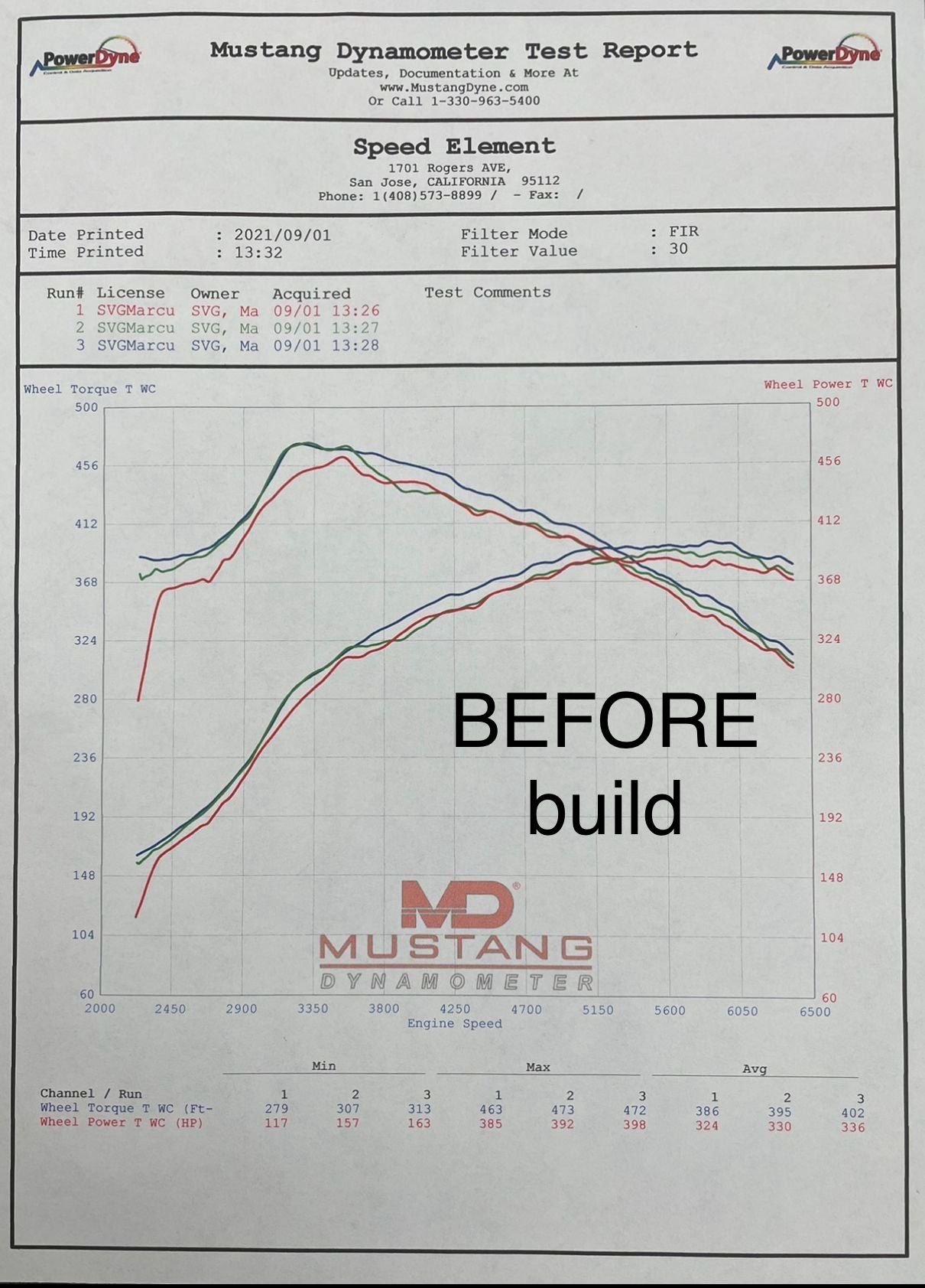

Mustang dyno for BEFORE build with AMR stage 2 tune, weistc down pipes, and AWE track exhaust
Mainland dyno for POST build

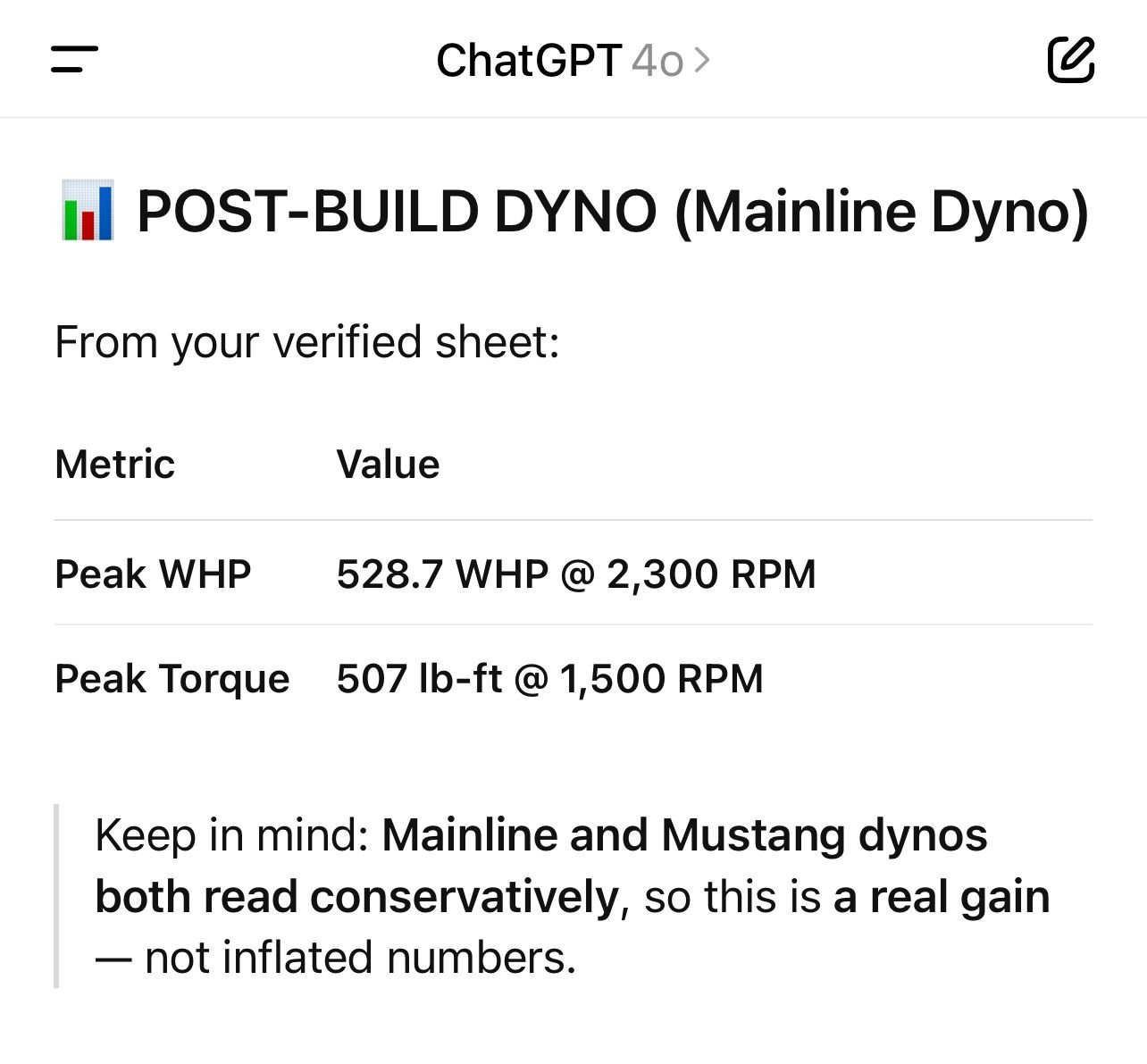

ChatGPT comparing the pre build dyno with the post build dyno

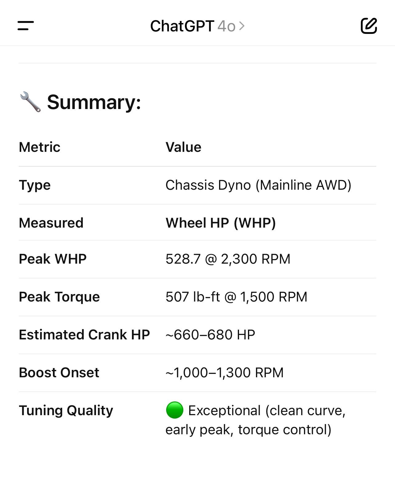

Summary of post build dyno
Peak WHP and peak torque kicking in early
Calculated hp at the crank
Just as a final conclusion;
after breaking in the motor, being careful with the trans and drive train did have a seal leak either oil or trans so as such good timing to now move to PART 2 with the following upgrades, retune and yes dyno again.
