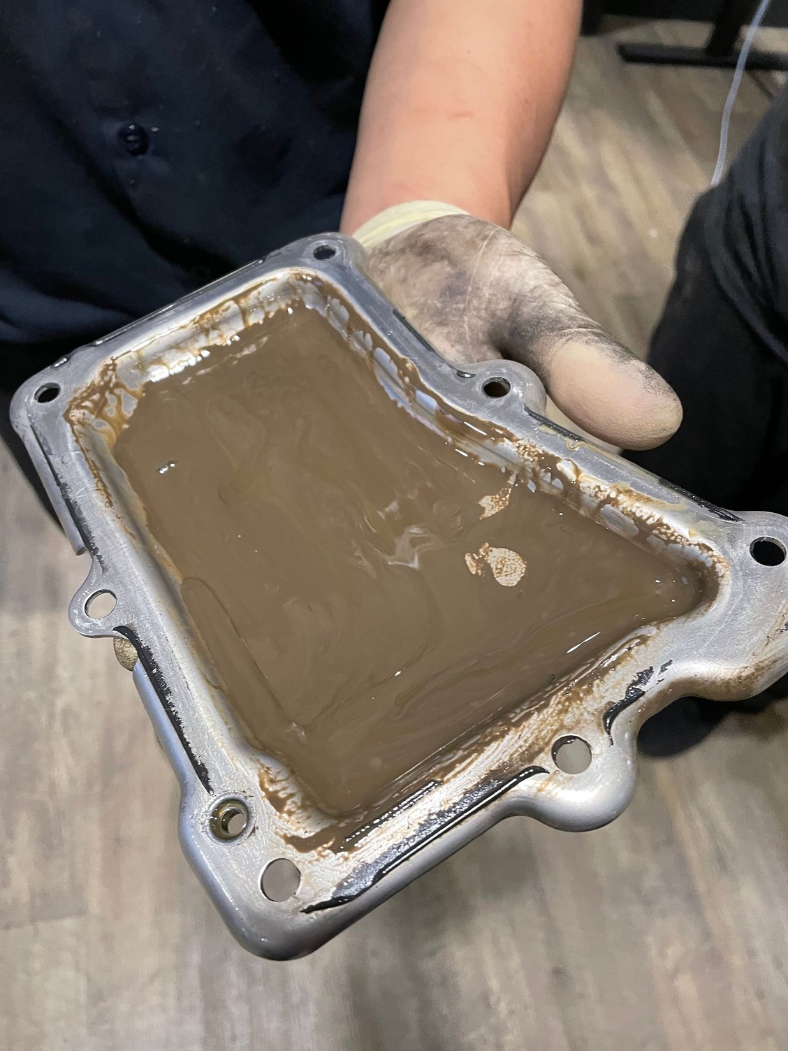

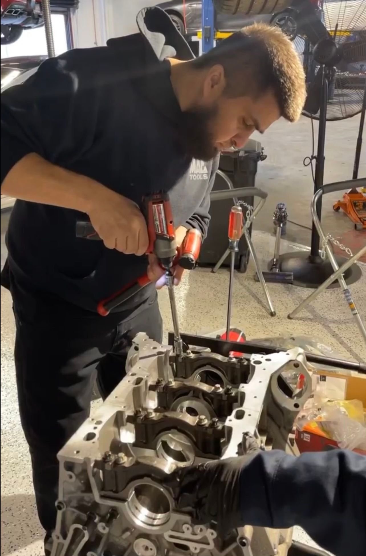

So the guys at Silicon Valley Garage are on day two of the engine tear down.
Really glad to do the full engine pull and tear down/rebuild since they found coolant in the oil and some metal shavings…possibly the oil cooler failed went or the head gasket was leaking.
Good thing they caught all that before just slapping on some turbos and putting the pedal to the metal lol.
We’ll see what else they find as they continue.
Thanks again for following.
regards
Day 2 tear down
Coolant mixed with oil

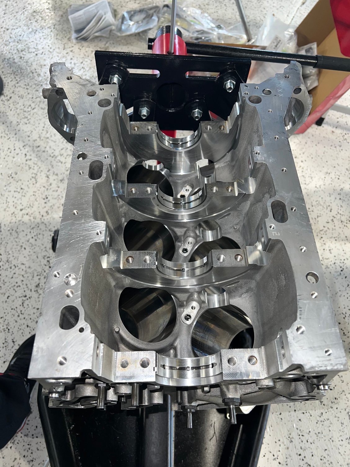

Motor is back from the machine shop, cleaned, and passed pressure tests etc so block looks good.
My man Cesario at SVG is putting the bottom end back together but a little stall due to some new replacement bolts being backordered.
AMR is about to ship @turbokits.com upgraded turbos over to Cali from CT for SVG to install.
Hopefully we’ll also make progress with starting ordering/fabrication of the custom wide body kit.

From what we can gather it seems that one or both of the stock turbos must be cracked somewhere.
What’s even more interesting is that I originally bought the car from CarMax with 11K mikes on it.
However when SVG pulled the motor and the head off it definitely appeared someone had already opened up the motor to do some work.???
No records at MB or Carmax showing it. So it’s a scratcher for sure.
In all it’s a good thing that I decided to do the engine rebuild before hand rather than just slapping on the turbos and calling it a day…and then the engine blows. LOL

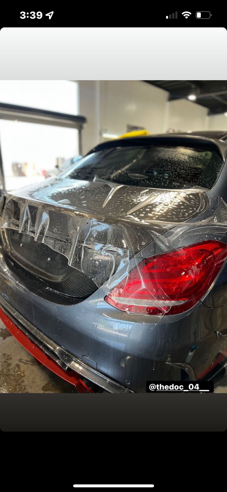

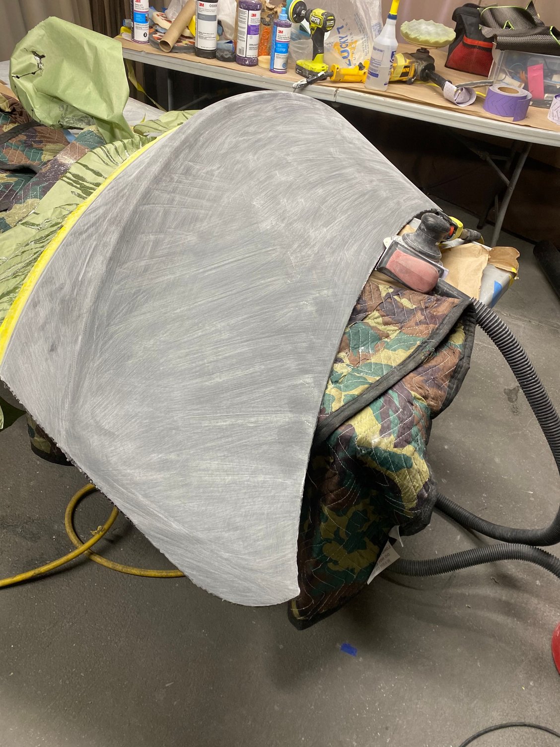

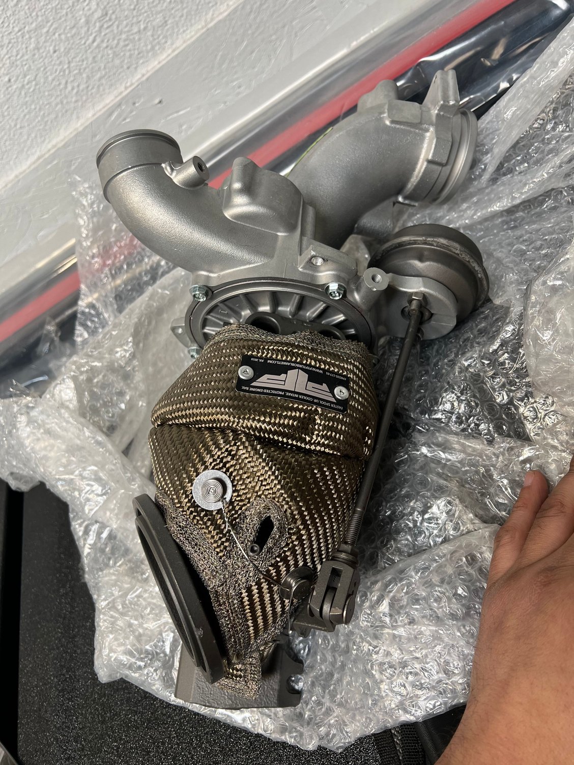

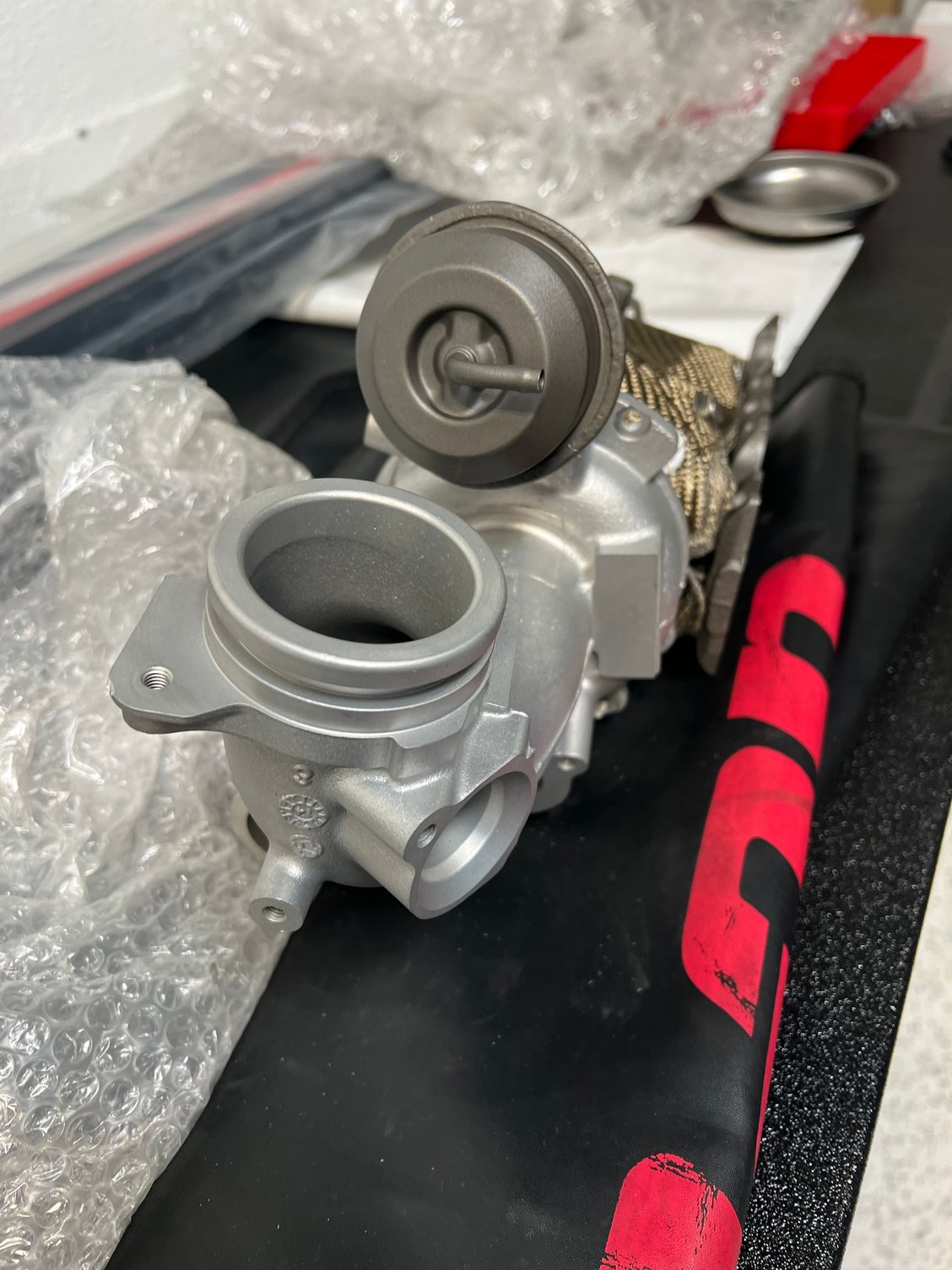

UPDATE: Hey all hope this finds you all well.
Been a minute so wanted to update you all.
So build was slightly stalled as the head bolts were back ordered for along time.
Should be coming in a few weeks.
Because of the water leak from one of the cracked turbos full tear down is done. CAM gears, valves, oil intercooler, and water pump all being replaced.
Turbokit.com turbos arrived at SVG with their pretty PTP custom wraps to be installed as well.

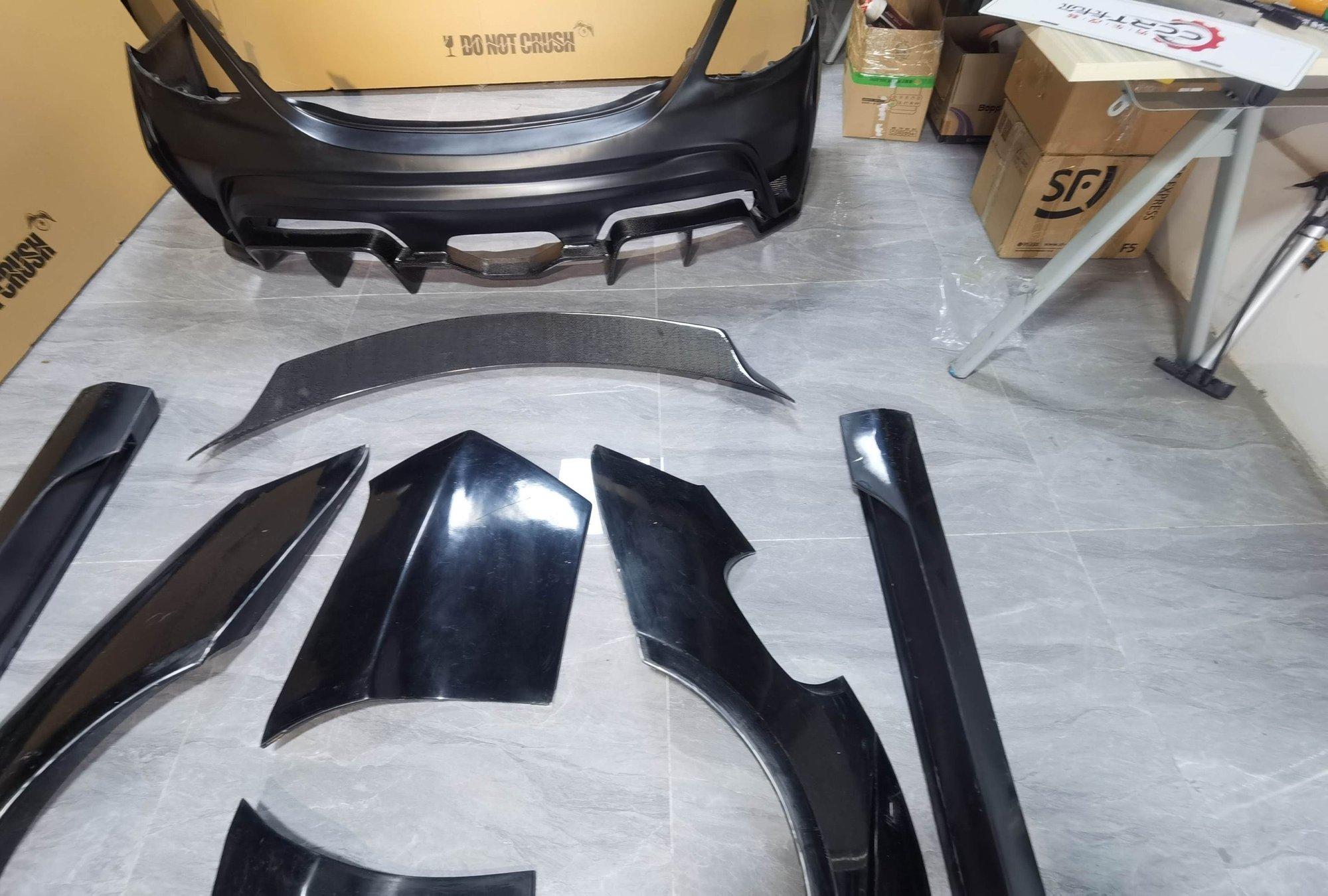

Custom wide body kit is almost done being made and should ship from overseas in a few weeks too.

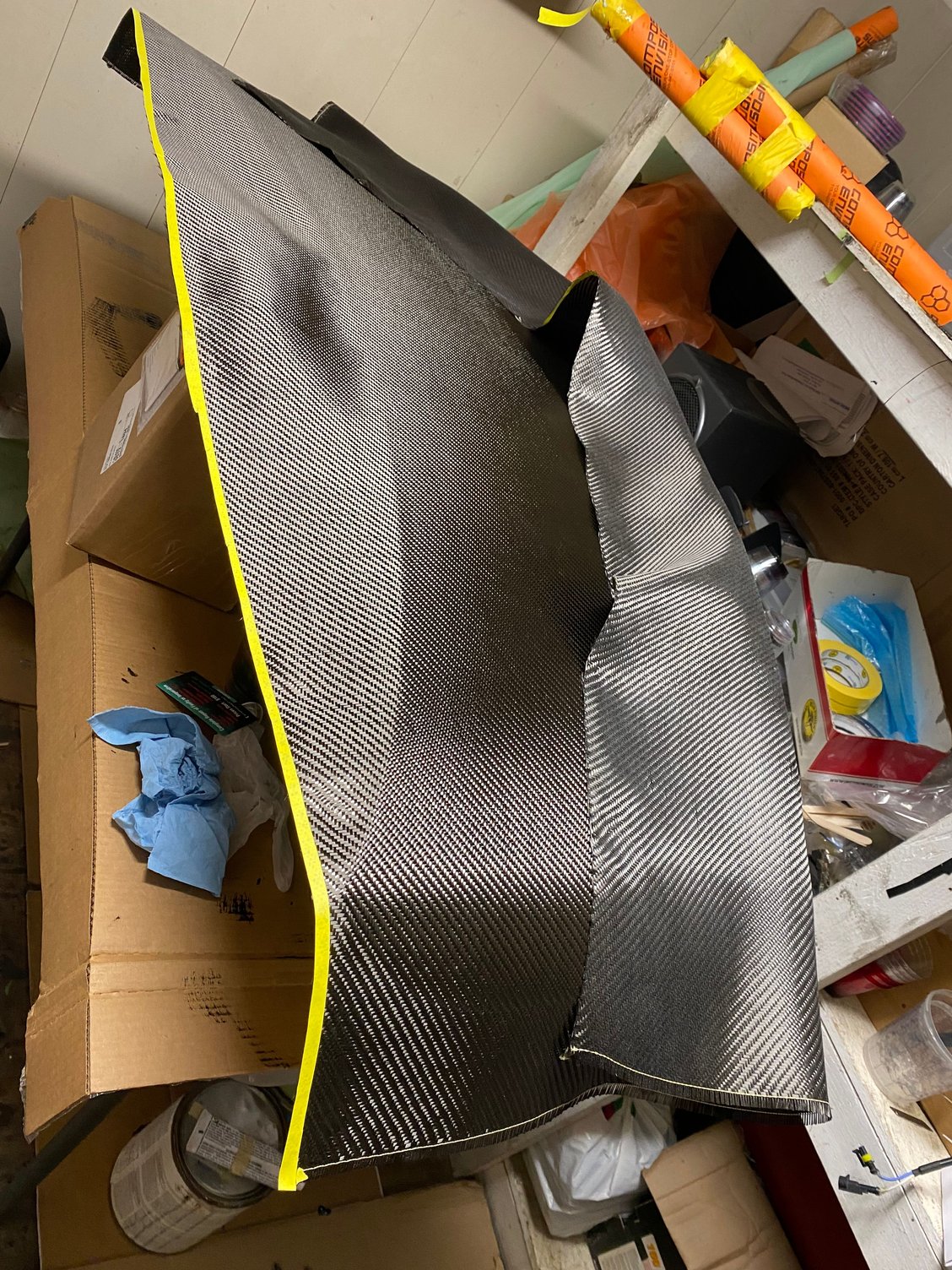

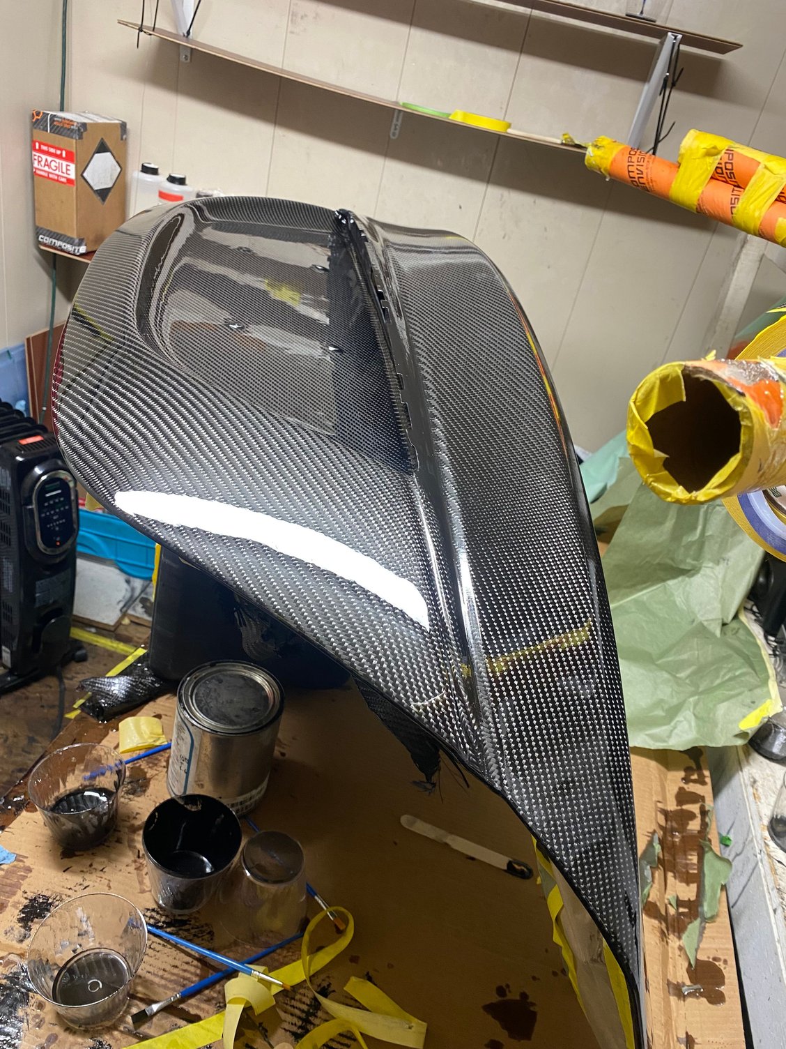

Newest addition is my ugly wrapped rear trunk is getting a new carbon fiber skinning to match the carb fiber Imp spoiler.
Thanks everyone for following this build.
Stay well!
Turbokit.com custom wrapped

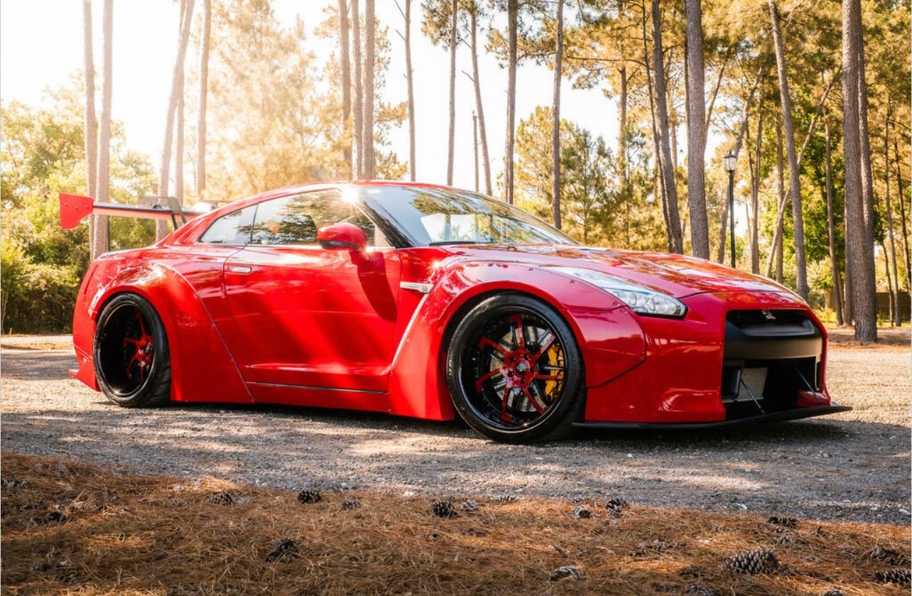

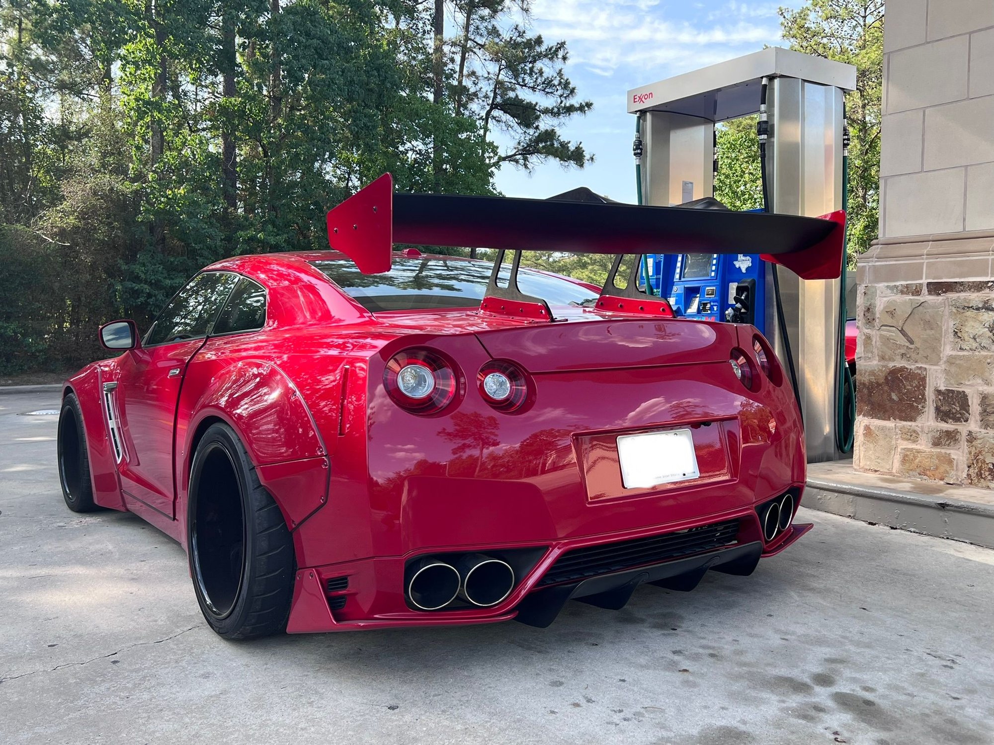

Example of my custom full wide body kit being made for the 4dr. Should be stateside in a month
Thanks to Cesario and his man Hector doing the carbon fiber skinning of the rear trunk lid.
Looking good Hector!

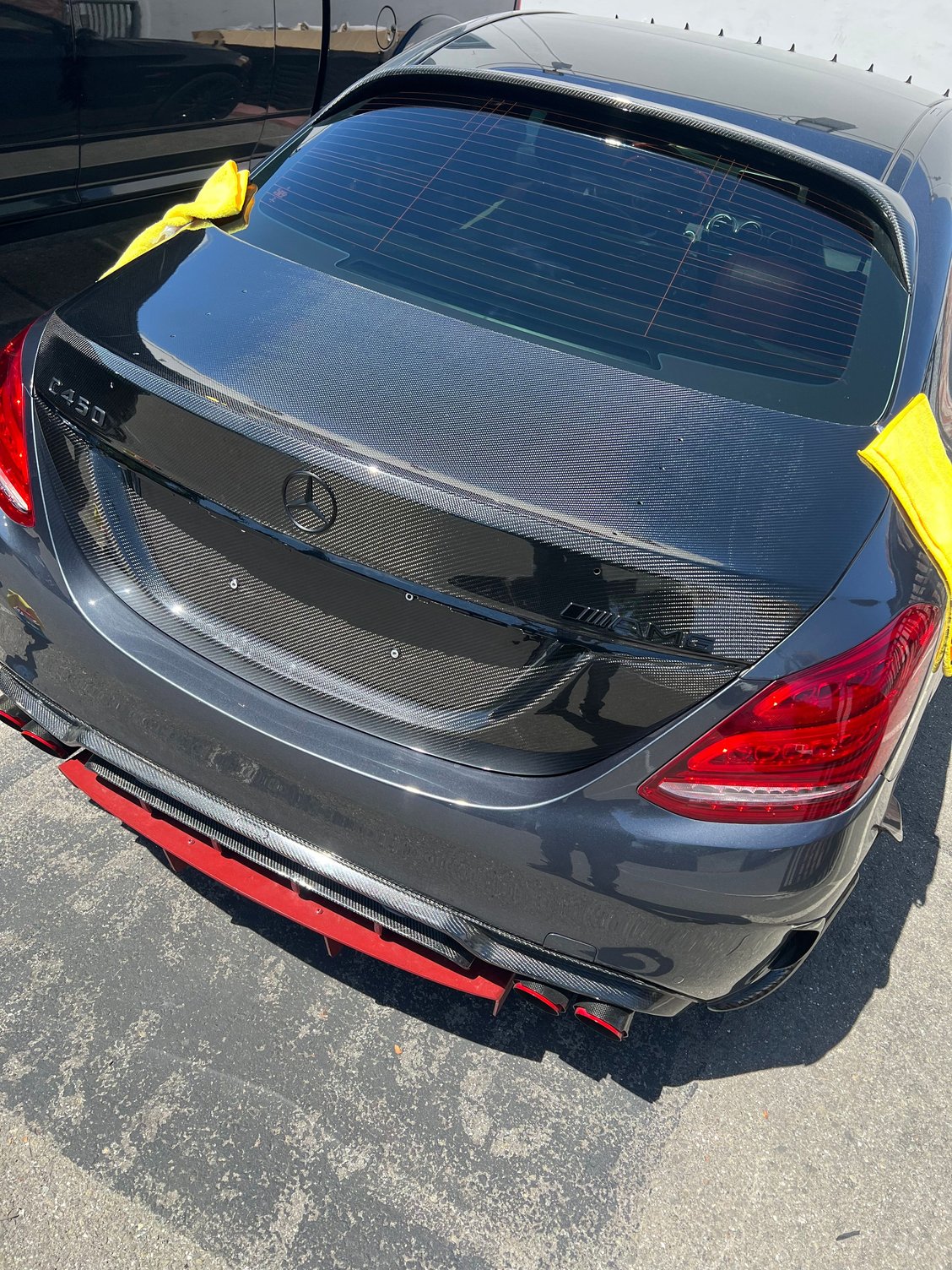

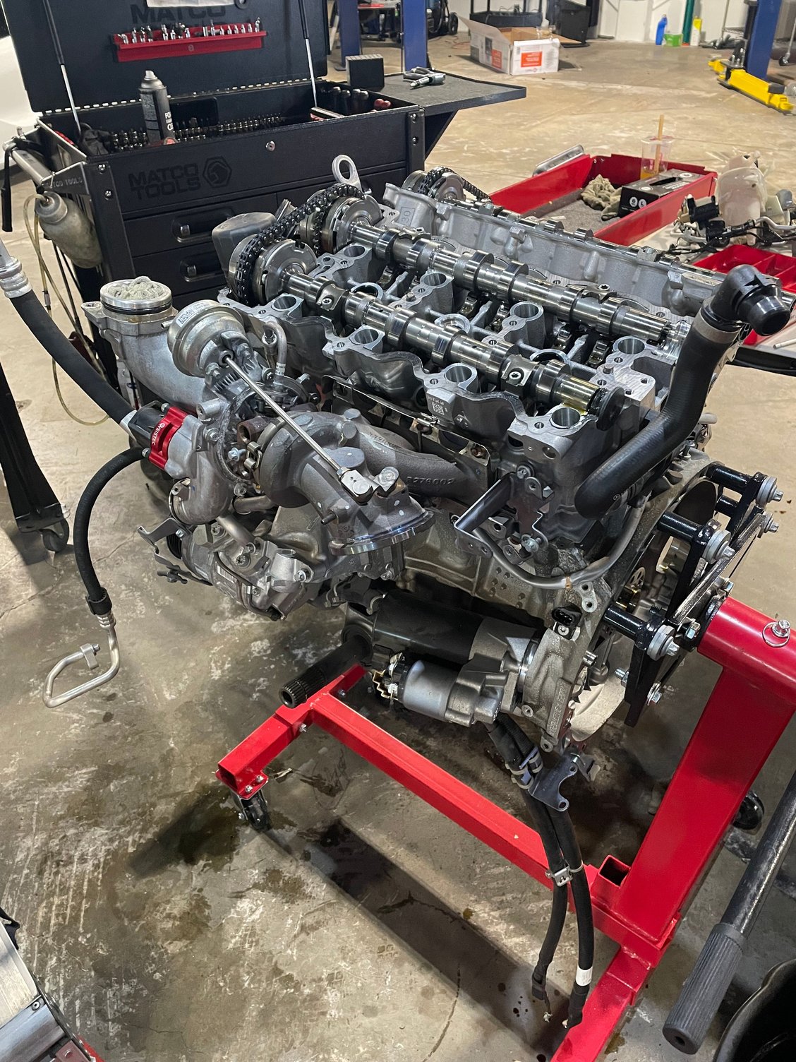

UPDATE:

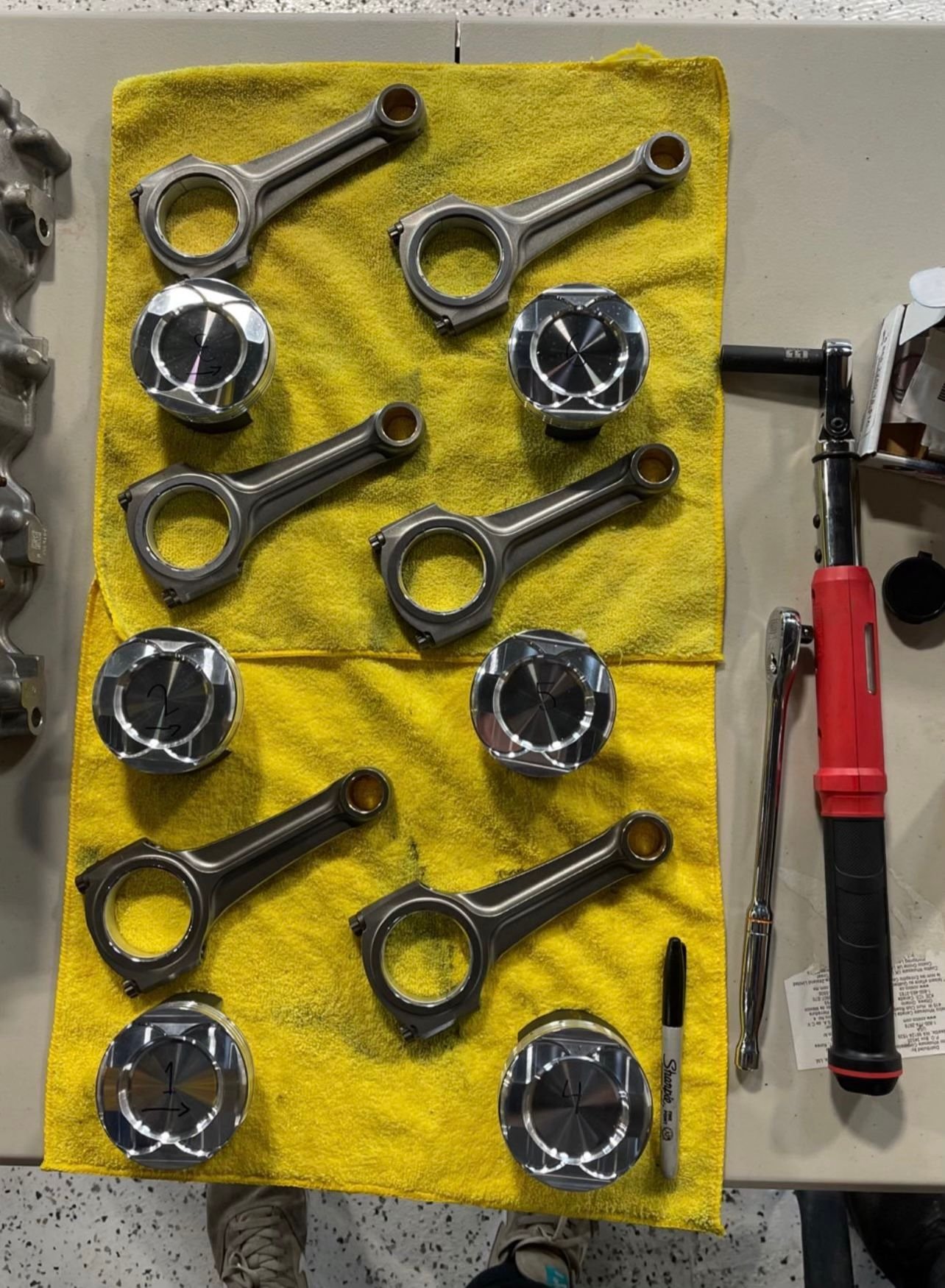

Engine is coming together, Wagner kit, fuel rail, and HPFP is in.

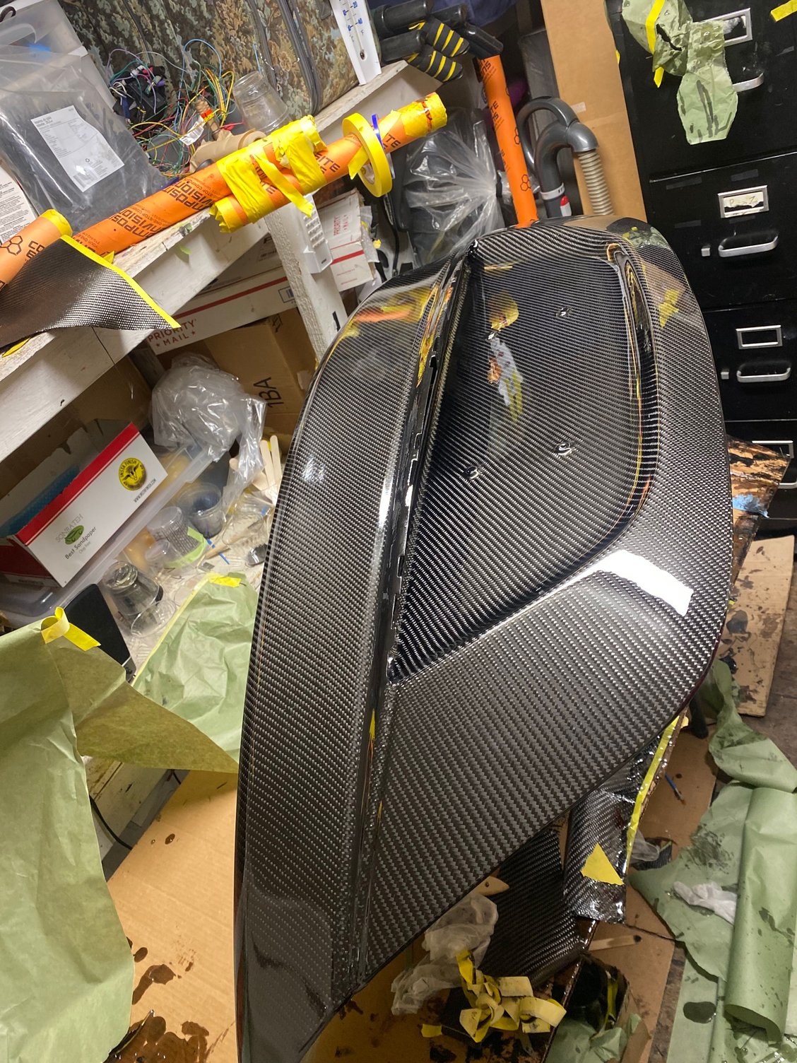

Carbon fiber trunk is finished and it, carbon fiber hood, side mirrors and spoiler have been PPF wrapped in Stek.
Waiting for bolts, turbos, in tank fuel pump installed and body kit to be finished and shipped.
Thanks everyone for following.
Cesario at SVG; thanks brother!
Custom JE pistons and Custom Pauter rods from Top End Performance.
Trunk turned out nice!
Wrapped in Stek PPF
Cleaned up and ready!

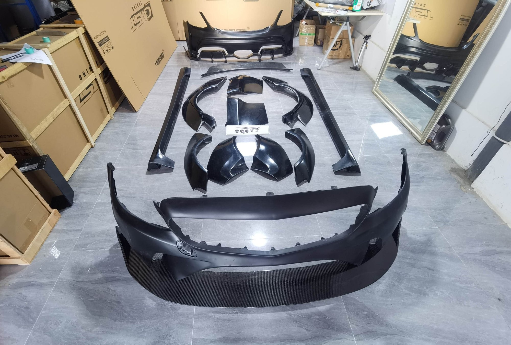

Custom wide body kit is finished. Carbon fiber front lip and rear bumper diffuser

Widebody kit arrived!
