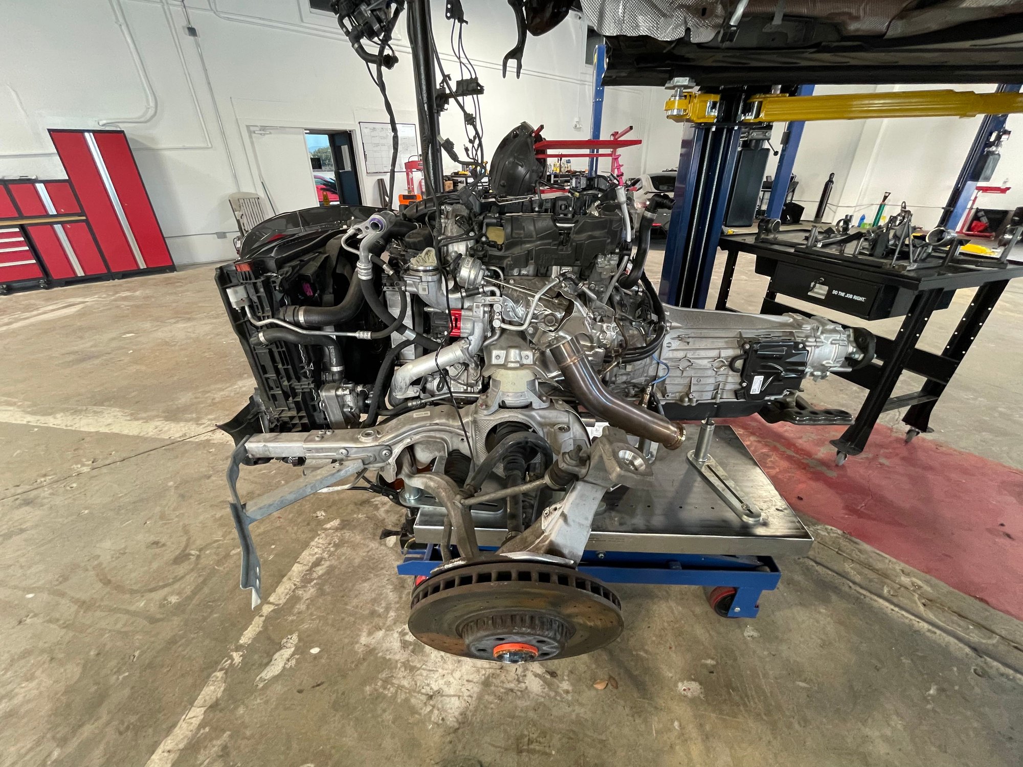

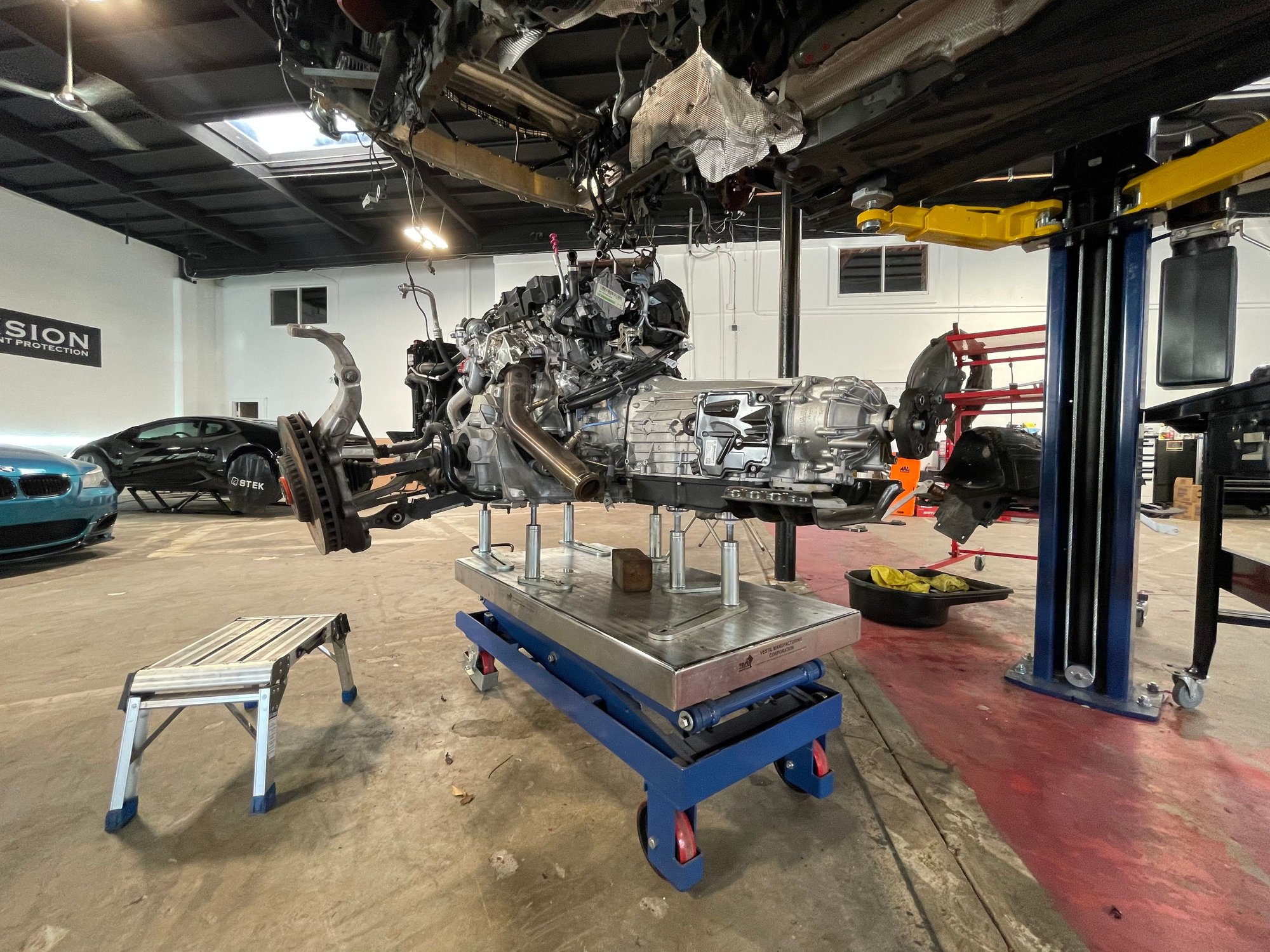

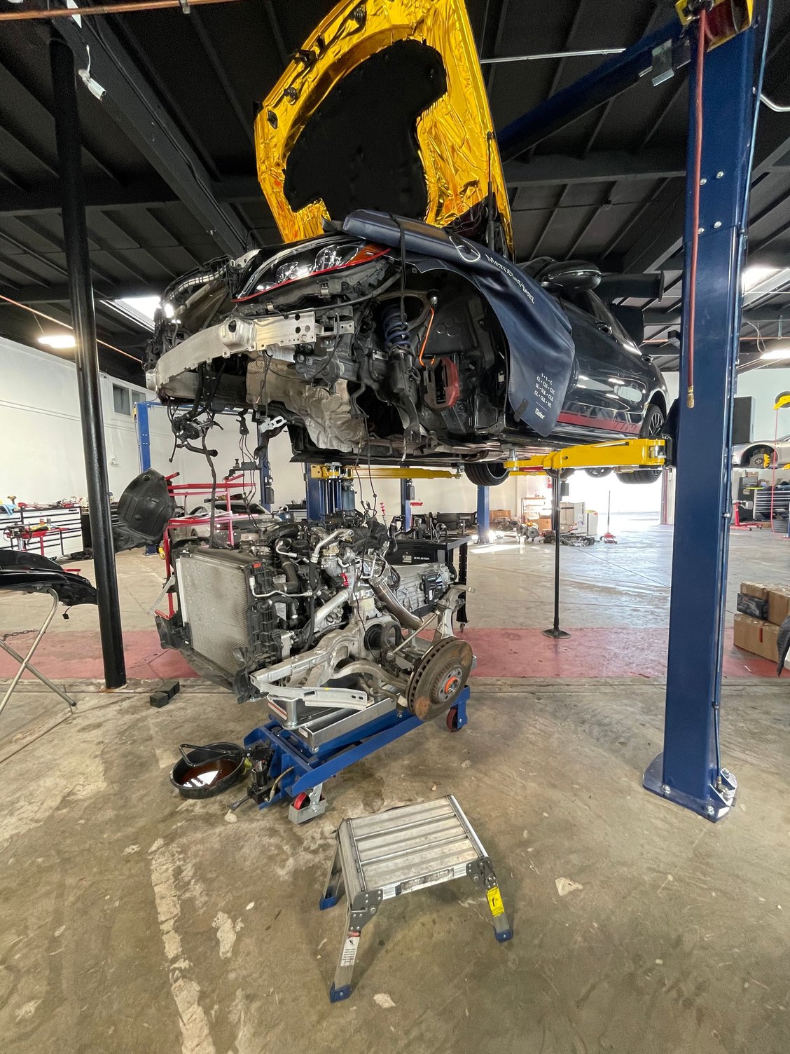

UPDATE: ENGINE FINALLY PULLED!
Hello everyone,
Just an update and finally a milestone in this project. My man Cesario over at SVG just sent over some pics!
Engine and assembly is dropped and engine build is on its way.
Pistons, rods, head bolts, Wagner cooler, HPFP, LPFP, Fuel rail is on its way to getting put in.
I’ll keep posting as I get update.
As planned once all this is done plus a new custom CF trunk lid it finally is going to make its trip up to CT to AMR for TCU upgrade/tune, install turbos, Meth kit, and custom dyno tuning.
stay tuned and thanks again for everyone’s continual help on this project and thanks to Cesario at Silicon Valley Garage!
On the lift at Silicon Valley Garage
Brand new rack holding the prize at Silicon Valley Garage!
