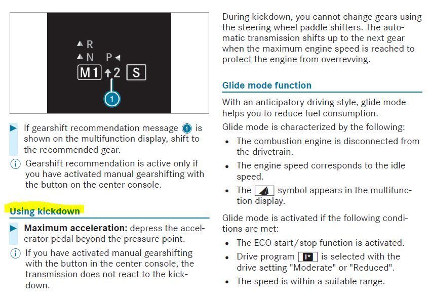

Yes, holding the down shift paddle for about 1 second will down shift to the lowest gear possible at the current speed you are going.
Thanks superswiss, for clarifying what the kickdown does and does not do.

This is good Intel. I also have a 2020 and noticed a "click" when putting my foot all the way down to the floor. Is this click the "kick down" your describing? What is the intended purpose of the kickdown?

I think your screen grab just answered my question. Sounds like a waterd down launch control

Yes, it is. Kickdown as explained above and what OP was essentially asking about. Kickdown has been a staple feature of automatic transmissions since I can remember. Personally, I think it has somewhat lost its relevance in modern computer controlled automatic transmissions, because they downshift anyway based on driver input. Even if you don't push the throttle all the way past the kickdown point, the transmission will still downshift pretty much to the lowest gear possible in response to the throttle input. The downshift maybe a bit more delayed, whereas the kickdown switch tells it to immediately downshift to the lowest possible gear, but I'm not entirely sure if there's a perceptible difference. Perhaps the biggest difference is that with kickdown it will not short shift and basically run all the way to redline, and you can also not short shift using the paddles, whereas it's possible that the transmission upshifts earlier than redline while accelerating w/o activating kickdown.
I wish kickdown was active in manual mode as it was in my previous Audi RS5, because pressing and holding the downshift paddle is somewhat slow as it takes about a second for it to finally downshift to the lowest possible gear. In my RS5, I could stomp on the throttle in manual mode and it would instantly downshift to the lowest possible gear. Or I would love to have what Koenigsegg did in the Jesko with their MCT transmission. In the Jesko, the paddles have two stages. The first stage does a normal sequential shift, but if you pull the paddles all the way it will either instantly downshift to the lowest possible gear, or the highest possible gear based on the current rpm. I think that' the ultimate solution.
