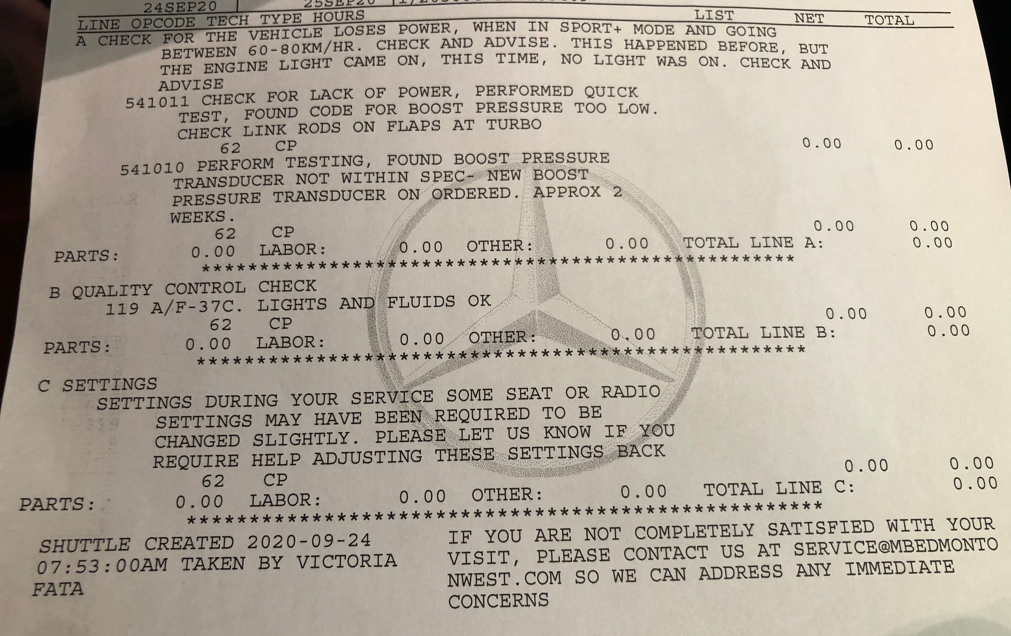

Hi guys, hope y’all are doing well. Recently I have experienced several power loss issues. And all of them happened after a few minutes of hard core driving. I noticed that there was no boost pressure when the issue came out. At first I thought it was some boost leak and after I took the car to the dealership for an inspection, they found out my boost pressure transducer was not working properly. The technician told me a code for “boost pressure too low” was found when they were test driving the vehicle. So they had a new boost pressure transducer on order for me under warranty. I’m still waiting for the part to get here.
As my car is equipped with Racechip piggyback unit, I’m not sure if it’s the Racechip that causes the problem. Recently, within a month, I’ve experienced 3 instant power losses. One with engine light on, and the car went into limp mode with crazy jerky idle. I took it to the dealership and they update the ECU, and switch the position of a few spark plugs. Then the problem was gone. And only after 2 weeks, again it’s still after a few hard pulls, the car lost the power. However, no check engine light came on. The acceleration was really slow. The car was back to normal after I restart the engine. Today, this issue happened to me again. No engine light. No rough idling. Just slow acceleration. And no boost reading on the screen. I highly doubt it’s the Racechip that causes the problem, because when normally driving the car without the Racechip, of course there are lots of hard pulls, the boost pressure is correct, no power loss whatsoever. As I have to wait my part for about 3 weeks, I reinstalled the Racechip earlier this week. Then the problem popped up again earlier today.

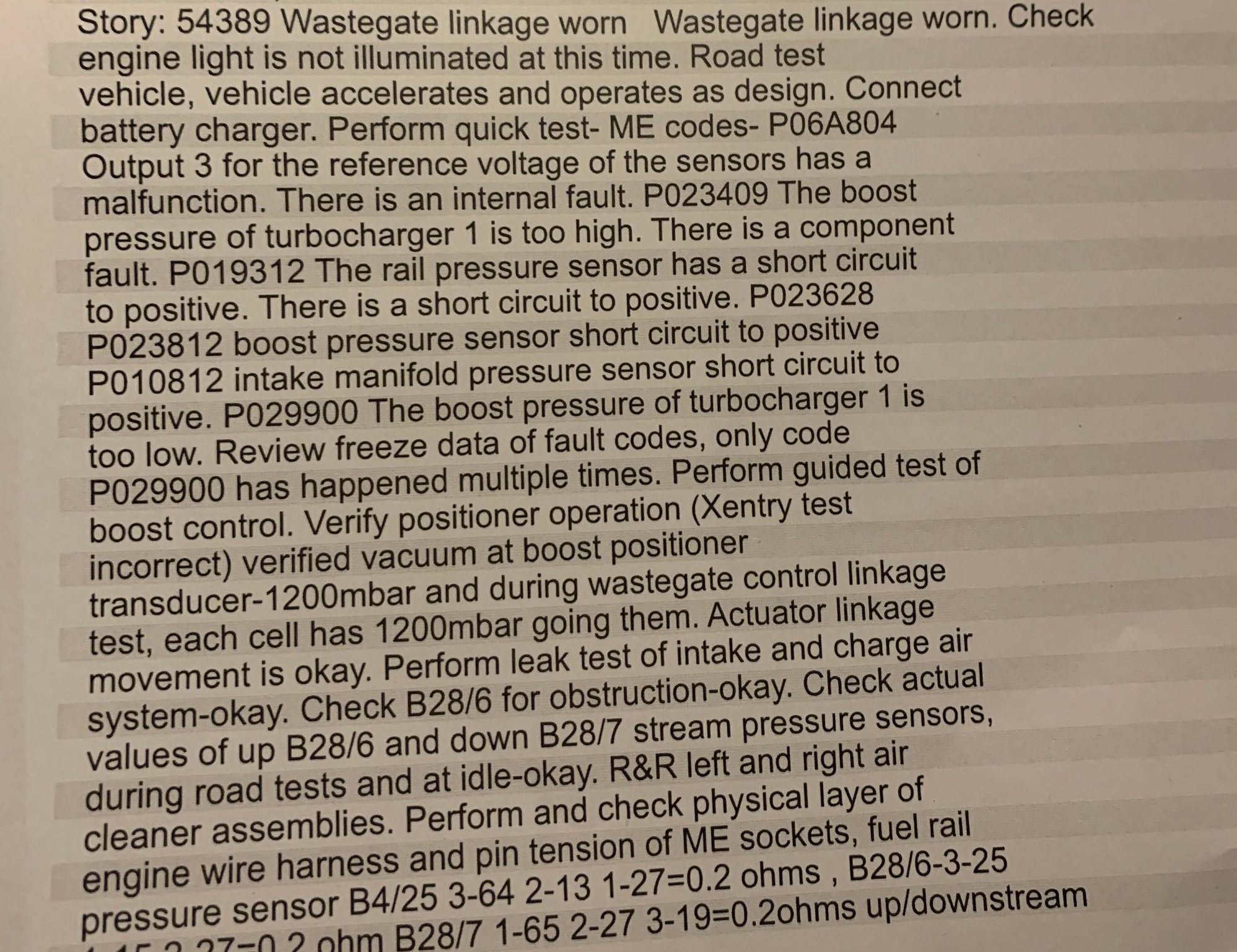

Yeah the first time was a misfire and the dealer did find the code. What they told me was a “faulty fuel signal”. At that time I told them I pushed the car really hard most of the time, so I highly doubted the spark plugs needed to changed. However, they told me my spark plugs were okay and they just switched positions of 2 spark plugs and the reason for that was they wanted to see whether it was the spark plugs that caused the problem if the CEL came on again later. Besides all these was a software update. All these are from my first visit. Luckily, the same problem has never popped up again. By the way, the gas I’m using is 94 octane from Petro Canada. So I don’t think there is any relation with the octane.
For the recent two incidents of intermittent power losses without any CEL on, the dealership’s service guy said the problem is from turbocharger actuator, which according to him, the technical term is “boost pressure transducer”.
Also, here is the report for my second visit from the service guy.
Yesterday, the same issue happened again. And I talked to a technician outside the country, he said because the problem was popped up after hard core driving and was gone after restart the engine, this might have something to do with the turbo cooling system. He highly doubted the issue was from what the dealership had told me, which was sensor/transducer not within spect. He thought the problem wouldn’t be intermittent if the sensor/transducer was already bad. He instead suggested me to check the cooling pipe line.
I’m so confused.

Two quick UPDATES:
1. It turned out the issue was caused by boost pressure control pressure transducer (module that controls the wastegate) malfunction. This is not the boost pressure sensor connected to the piggyback. The part number is 0101531328, which is located slightly under the left intake. I have talked to a few 2019 C43 owners and a few GLC 43 owners as well, and some of them had experienced the same issue I just had, which was the loss of power or no boost pressure during acceleration. All of their cars are in stock condition. No ECU flash, no piggyback whatsoever. After comparing their reports from dealerships, I noticed the problem descriptions and malfunction part numbers are all the same as mine. So, I would say the issue would most likely be a manufacturing defect of the part itself.
2. New part had already been installed. The issue was completely gone even after hard pull.
