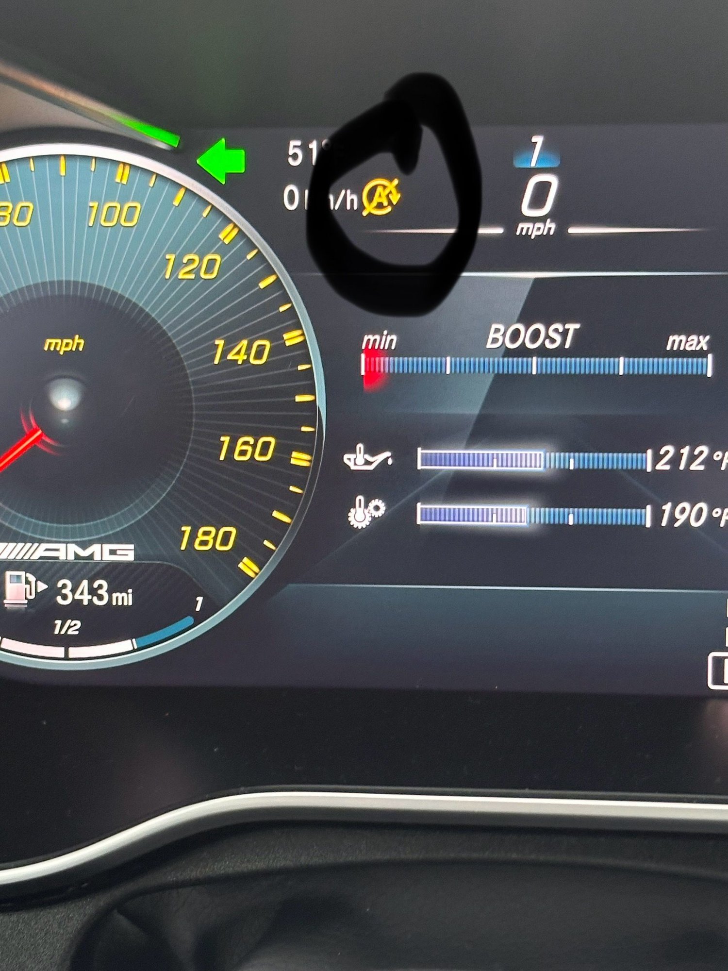

Old Feb 12, 2024 | 04:48 PM
Cbr125zz's Avatar
Joined: Jan 2024
Posts: 7
2020 c43 amg
Can someone help me
Originally Posted by ctsvette
So I know there's lots of posts on this but I feel like my question is pretty unique, it maybe it isn't. My C43 that I ordered was supposed to come with the AMG drive unit, but it didn't, but it did come with the steering wheel dials, they just don't work. That's a whole other issue. Anyway, my start stop only works in comfort mode or individual with comfort selected. This is really annoying as I'd like to use it in individual with the economy mode or whatever it's called selected. I live in a very busy area and most of the time I'd like to save on gas and switching back and forth to comfort is really annoying. Is this how it works on everyone else's C43?
Somebody can help me ?
