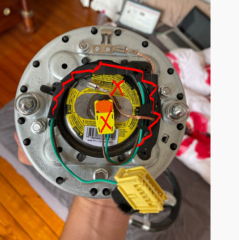

Looks like the center, the plug and wiring has been replaced
It's Factory 18 in china, but none of other original airbags have that center . also have printing on the orange clip
the white label and white plastic is seen on newer cars. If you grab a 2018 facelift you’ll see what the op has for an airbag. Easiest way to tell is looking at the physical airbag there are some key points inside that’ll tell you if it’s aftermarket.
op if you paid less than $1000 for the wheel and airbag chances are it’s an aftermarket one. You can go the lifetime of you having the car without it throwing any codes. It’s a hit or miss really.
but if you really want to know you’ll need to take apart.
