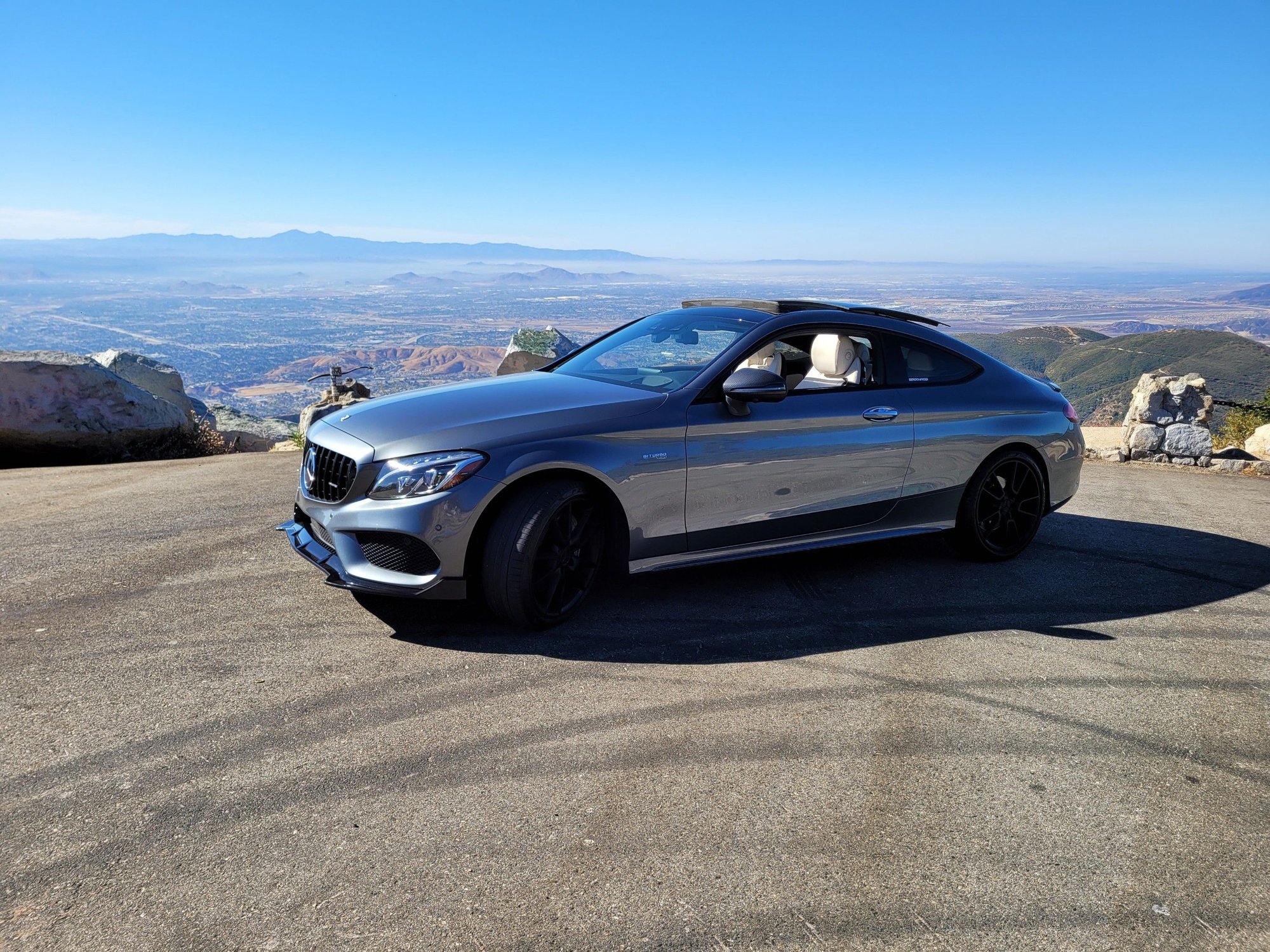

Old Feb 27, 2022 | 11:56 AM
Freder8d's Avatar
Joined: Apr 2020
Posts: 147
Likes: 43
From: So Cal
2017 AMG C43
2017 AMG C43

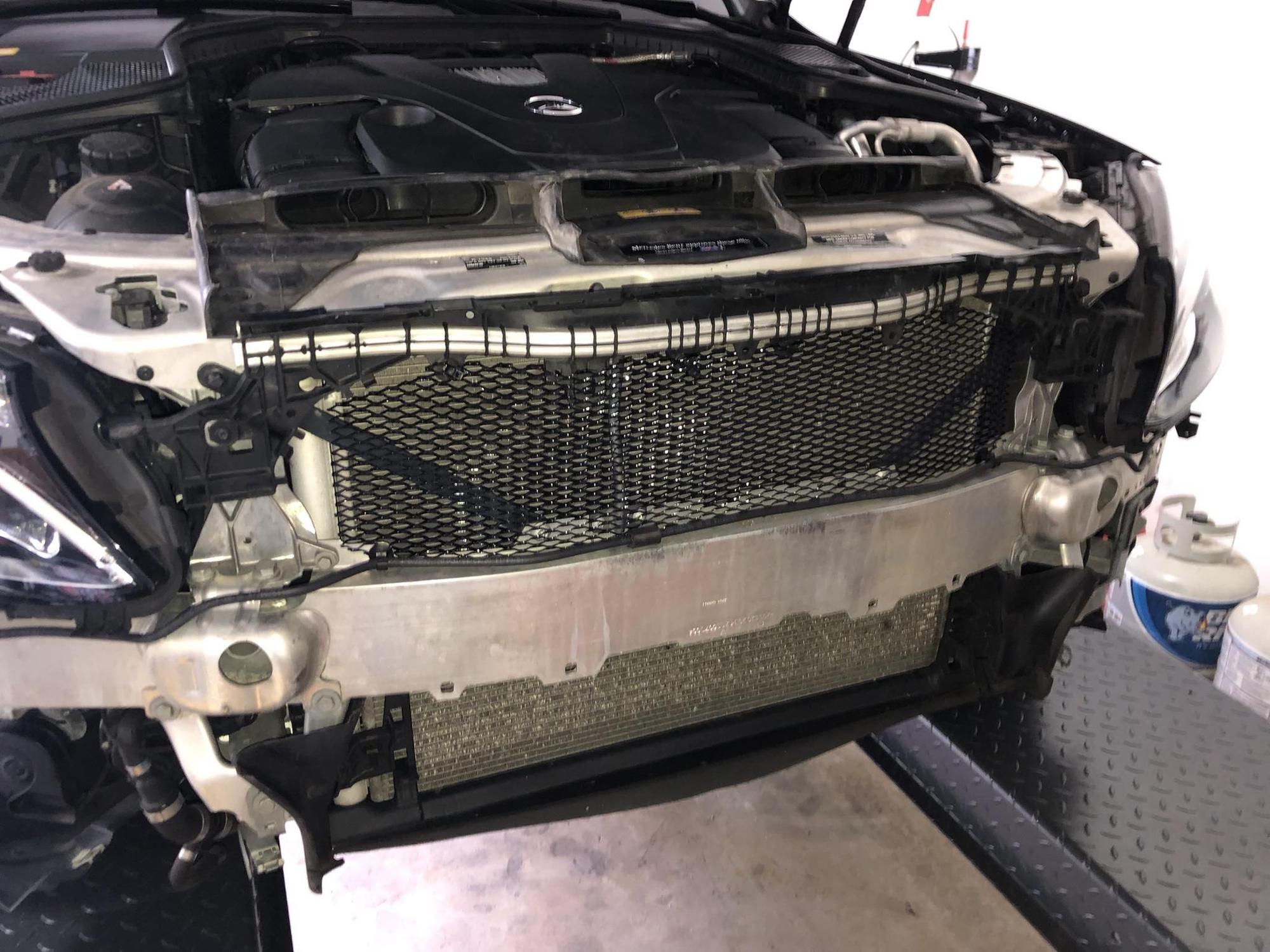

Thanks! Yeah, you’re definitely missing a piece. I also added some mesh to protect the radiator:
Brooo YOU are awesome! I have been researching to resolved this issue for almost a week. Was almost going to spray my radiator with high heat spray paint!
This is a wayyyy better fix!
How do you have the mesh holding up?

Is it glued or zip tied?

So far, so good, but not getting a lot of miles these days WFH. I bought the mesh off Amazon, carefully trimmed it, held it into place with zip ties.
I’m thinking about trying to better protect the lower section as well. When I had the bumper off, the bottom portion of the radiator gets some road rash.

Sweet. Literally just ordered a mesh off amazon. Its coming tomorrow!! Super excited
and good idea. While I have the bumper off I might as well get the bottom radiator as well.
Zip ties are holding up no problem? I would think the heat would melt it but if its working thats awesome!

Holding up well, no problems yet. I don’t think hi temp would be an issue, but maybe over time with heat cycles they could become brittle. I’d think it’s low stress, so probably ok.
Glad I could help. Keep us posted on your progress!
