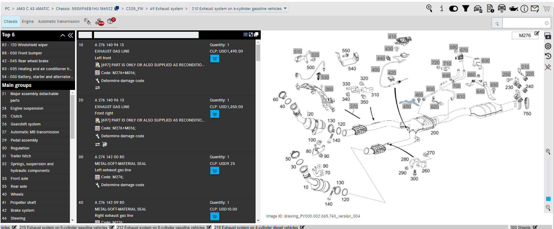

I hope this image attaches, we do have a metal seal ring on both sides of the cat
#50, #30 would be on the turbo side

Yes I saw the EPC and ordered all the gaskets but my issue is removing the old gaskets, they don’t come out easily. And mine didn’t appear to have an upper gasket.
